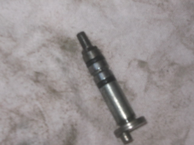

I have a Long 2360 tractor. I bought a CAV-KIT to replace the seals and gasket on the top half of the injector pump. While removing the nut from the shut-off shaft that extends through the cover, it snapped off. :eek: Does anyone know where I could get that part? It seems my only option is to buy a new injector pump just to get that part. Thanks for any help!

I hope I have called the part I need (stop shaft) by the right name. I have found online some throttle shafts but no stop or shut-off shafts. To be clear, this is what I am looking for. thepumpguysc, I PM'ed you. CAV Stop shaft.jpg

Got it.. all packaged up & missed the mailman.. I'll get it in the mail tomorrow on my lunch break.
/ Need a Part For Fuel Injection Pump
That's great. I appreciate your help!
/ Need a Part For Fuel Injection Pump #8
On its way..
Sometimes I think I'd rather get kicked in the *alls than stand in line at the post office..LOL
#9
I received the part and put it in this morning. It works fine and no more leaking diesel! Thanks, thpumpguysc!
