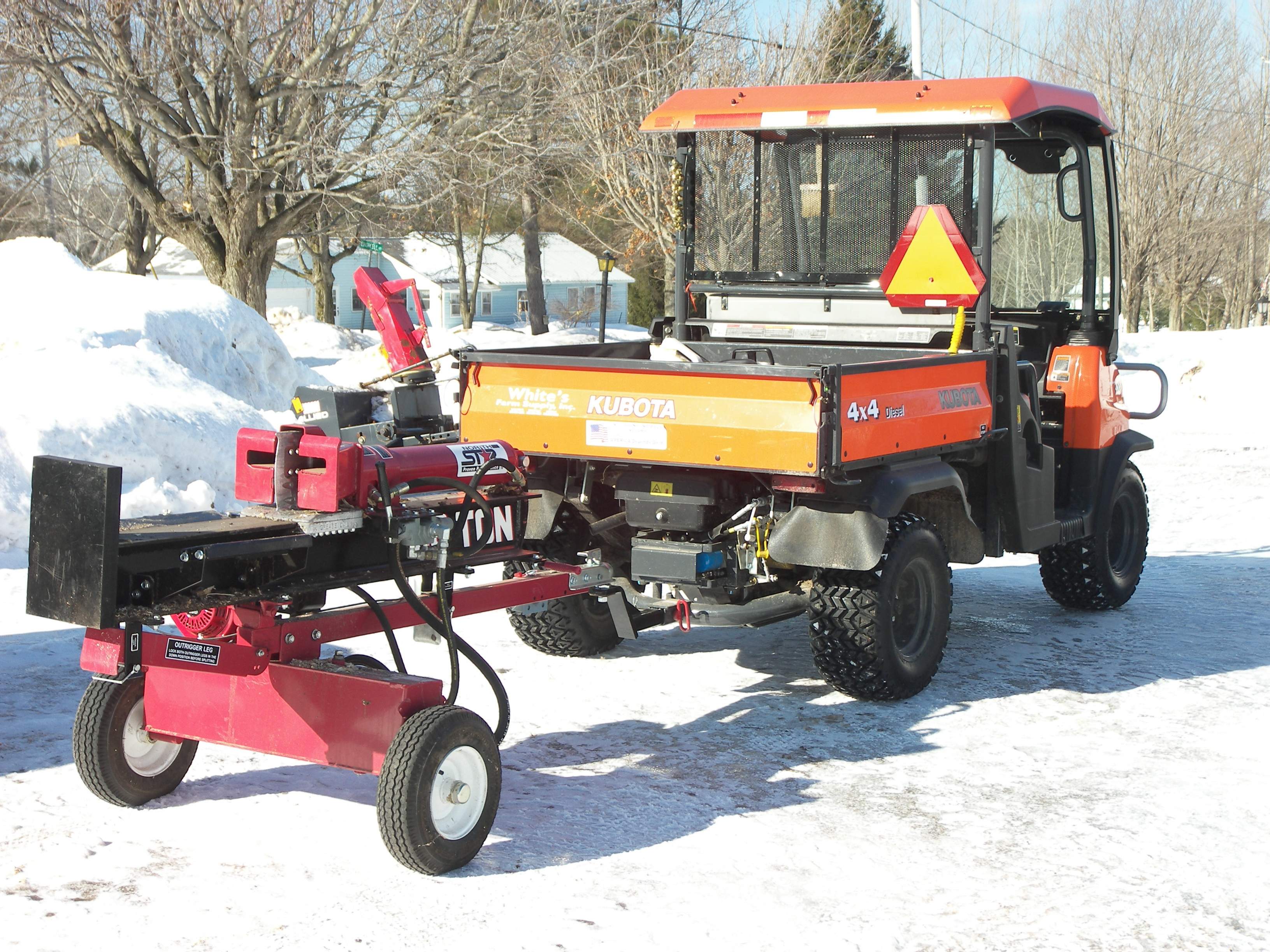

Congrats on your new splitter! Rules state you must put up pictures or return splitter!

I will be home all weekend, bring your splitter over and break it in. I've got a bunch of dried 30" hard maple you can split. . . . Well i think you made a good choice anyways. . .John

How about I take some pictures when I get into some of the more interesting stuff (e.g. crotches & big rounds).
I did give it trial run yesterday. Largest log was 18" diameter oak and it was split with ease. I split more than a weeks worth of wood in less than a hour. Cycle time is quick. If you have a log 16" or under you better watch were your free hand is when you engage the splitter.
I left the log splitter attach to my Polaris Sportsmen 800 X2. Made for a stable platform with a slight slope to the foot of the splitter. I'm 6' 2" and the work height was perfect for me. Too many of the log splitters I looked at were far to low for me.

Ok John, Parties over, you did a trial run and everything so wheres the pictures? Rules are rules ! . . .John :laughing: :laughing:
