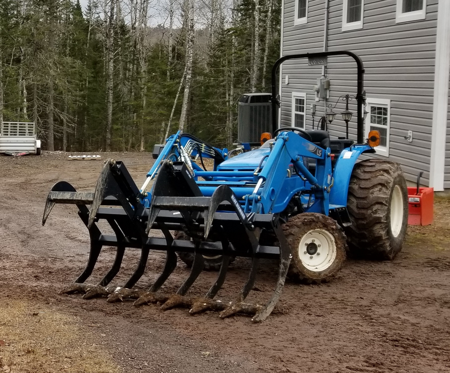

I have an EA grapple and did not know there was an issue when I began with your thread. Looked up EA and looks like not an option. But use mine a good bit on a Kubota L6060 and really like it. But it is not perfect to me.
What I would look for, if moving tree limbs and such. I do not want a single cylinder on the lid. I have a single full width top and wish it was a split top with cylinder on each lid. I would want the back either sheet metal or fine enough expanded metal to block limbs from the front of the tractor. Or you need to build a protection for the front of the tractor.
I came very close to doing hundreds of dollars damage to my tractor with limbs say two inches in diameter pushing into my tractor grill. Fortunately, did not puncture any of the cooling system coils but had to replace a four-hundred-dollar grill.

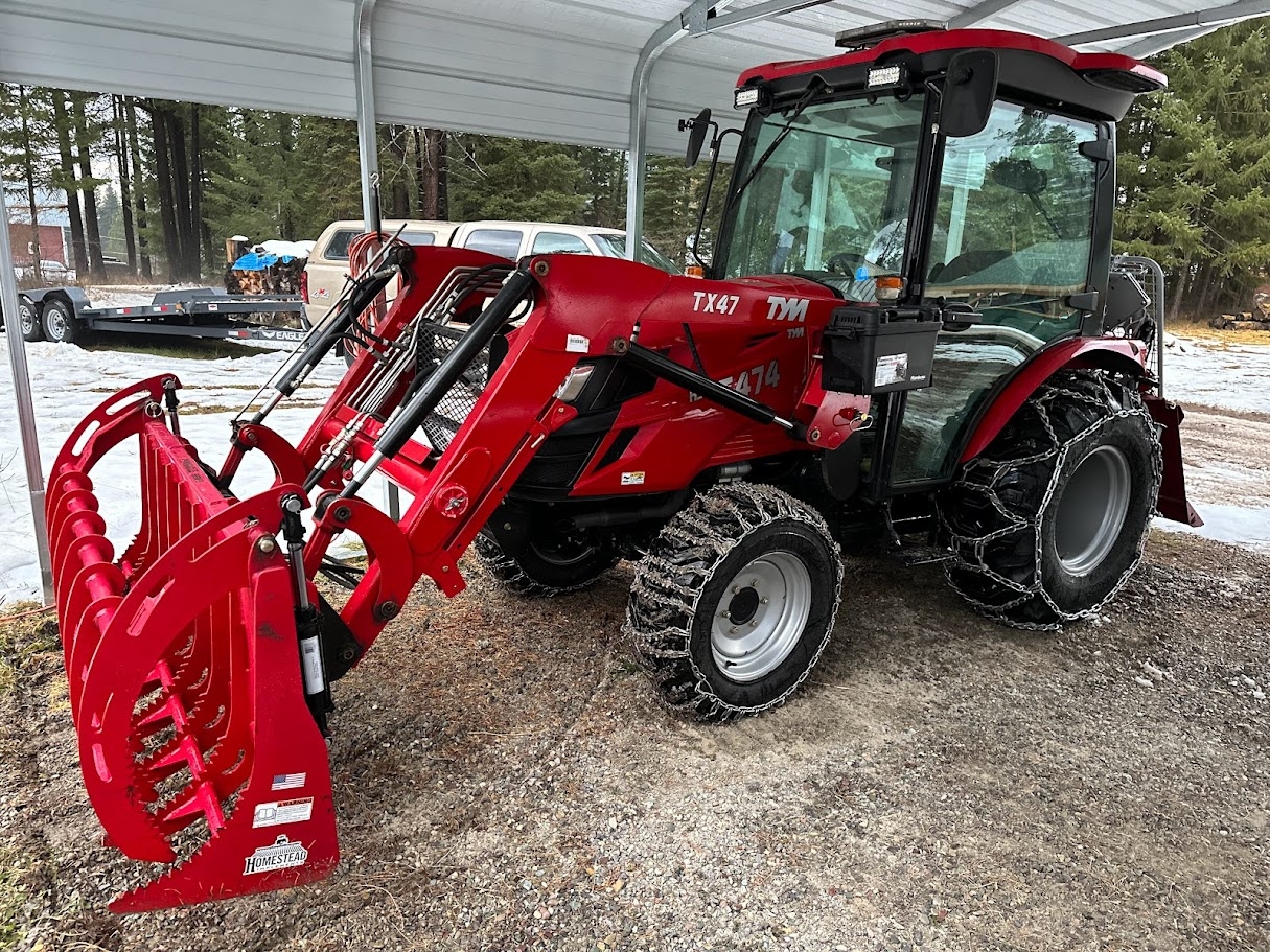

I live in MT and purchased a Homestead Implements root grapple, it has been almost 4 years of ownership and it has been flawless.

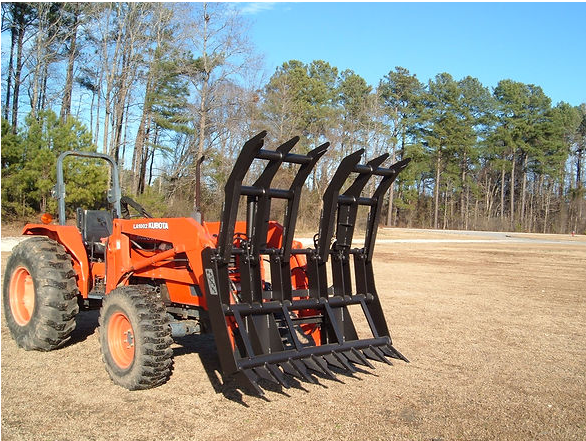

I had to decide what type I wanted. Rock/root or limb/trash type. For me it was easy - rock/root. I really don't have much in the way of limb/trash. I use mine to relocate large sections of pine tree trunk and large rocks. I have NEVER dug up a root ball so - single top lid was what I needed. The root ball on a pine that's 38 inches on the butt - just too difficult to even consider digging up. Besides - all my trees ( Ponderosa pine only ) are out on the property. Away from my house, out buildings and lawns. The stump can just sit there and rot away - for all I care.

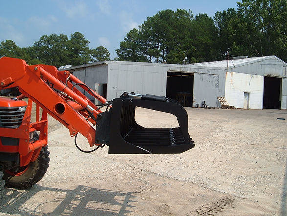

Blue Diamond light duty 66 inch double lid . I have been having real good luck with this grapple . Quite pleased . 450 lbs or so . Great for brush , roots and getting logs to the mill. The semi flat bottom makes it good for moving lumber around as well.
