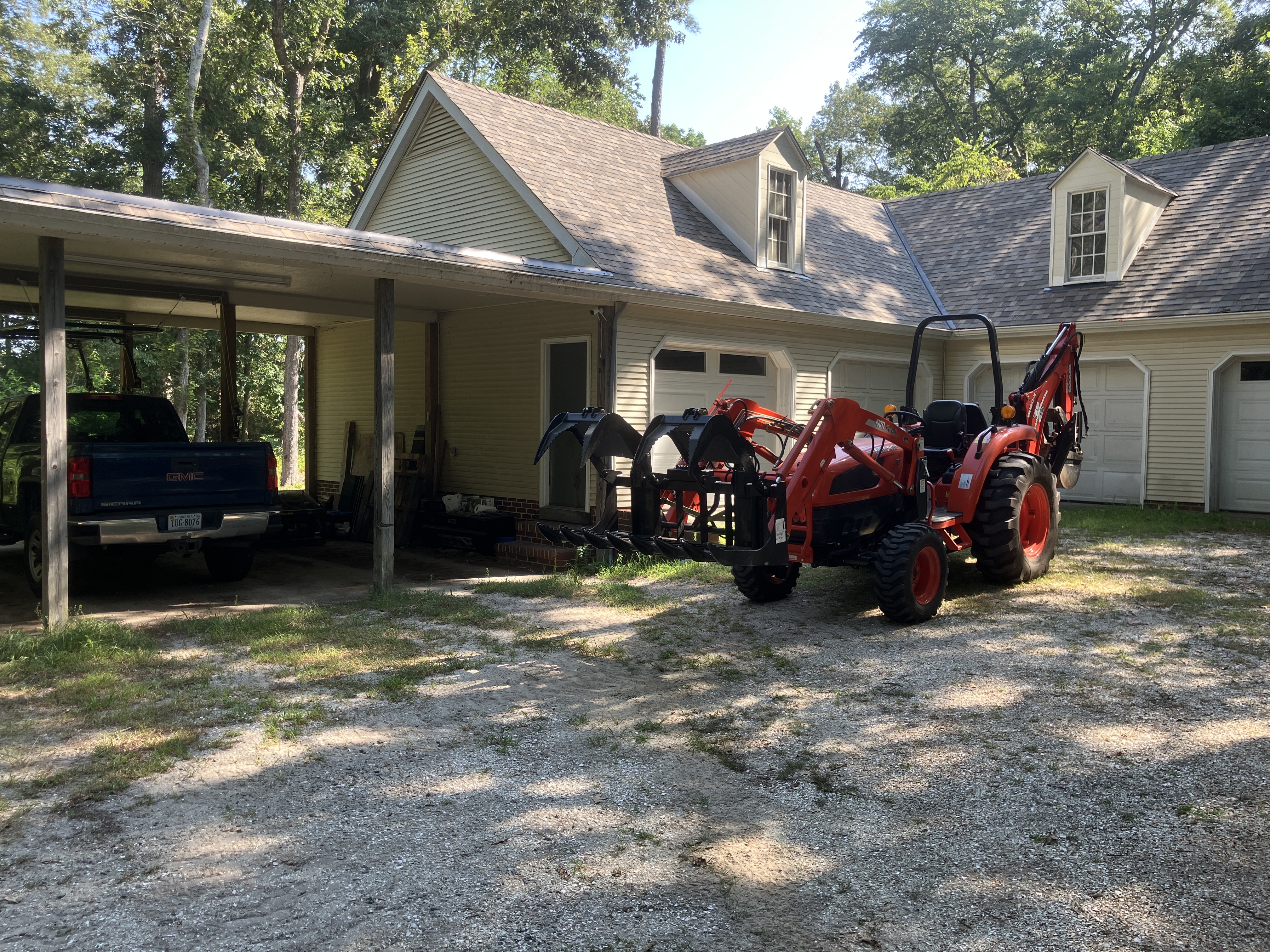

I finally moved my tractor to VA from ME. I pulled the trigger on the MTL RG-7 60" grapple. The shipping company wanted to deliver it to PA for me to pick up!!?? But I found they had a transfer site in Portsmouth VA, 1 hr from me, so I had it shipped there. I have used it every day since I got it hooked up!
   / Need a grapple for my tractor... help me spend some money. :) #106
My MTL grapple is the most used implement I have. And it was a bargain.
