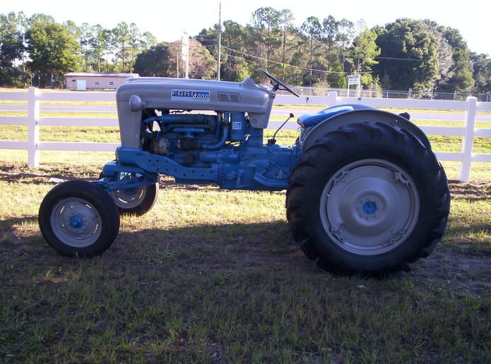

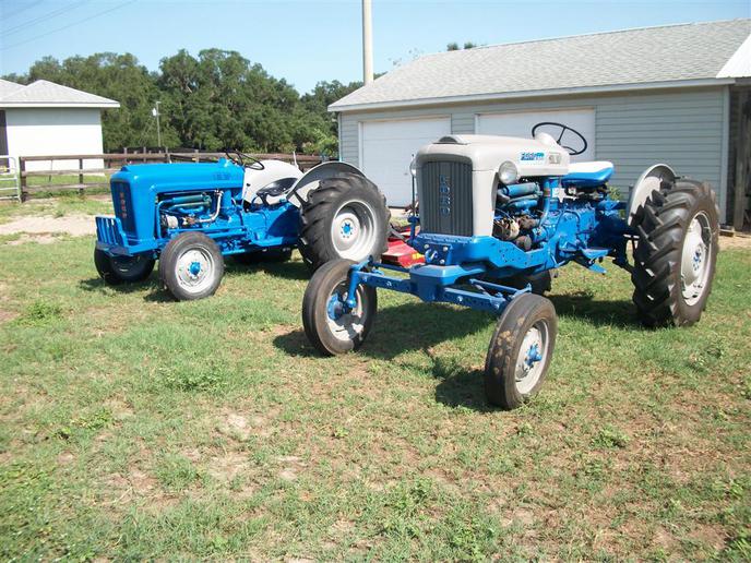

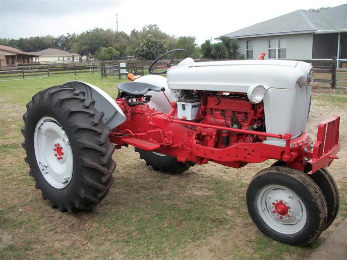

   / Need a Ford #7
in the prev post, the first 2 are my 63 4000 rowcrop with factory wide front with a 4 spd and combo sherman hi low tranny.. making it 12 forward gears and 3 reverse..
the last one is my 950 'essentially' the same chassie of the other rowcrop save the front pedistal..e tc. showing you a narrow front option. VERY NIMBLE.. that one has the 5spd tranny... same essential machine as a 7xx or 2000 rowcrop 4 cyl... except for the smaller 134ci engine..e tc..

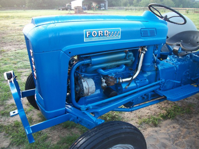

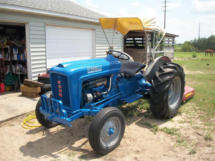

these next pics show my 63 2000.. same essential chassie of a 6xx and similar to an 8xx, but without the hp. just showing you the difference in height. which may help you decide between an ag and a rowcrop for mowing..e tc..
