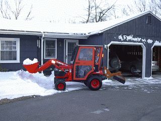

</font><font color="blue" class="small">( Anybody out there have experience with a BX2200, snow, and a back blade? If so, help us all with your insights.
)</font>
I have that Woods Estate 5' back blade (and the rake) and it seems to lift pretty high. I honestly didn't get much chance to use it last winter because I got it in mid March but it did clear a couple of 1-3" inch storms fairly efficiently. Here's a picture of it in (I believe) the full up position.

Having used some full sized Cat.I implements on my BX, I would heartlily recommend the Estate series or the Kingkutter XB series of implements. I have ran into the same lift height problems that have been commented on. When you level the implement , you quickly run out of lift clearance. I have a landscape rake for sale because of that.
