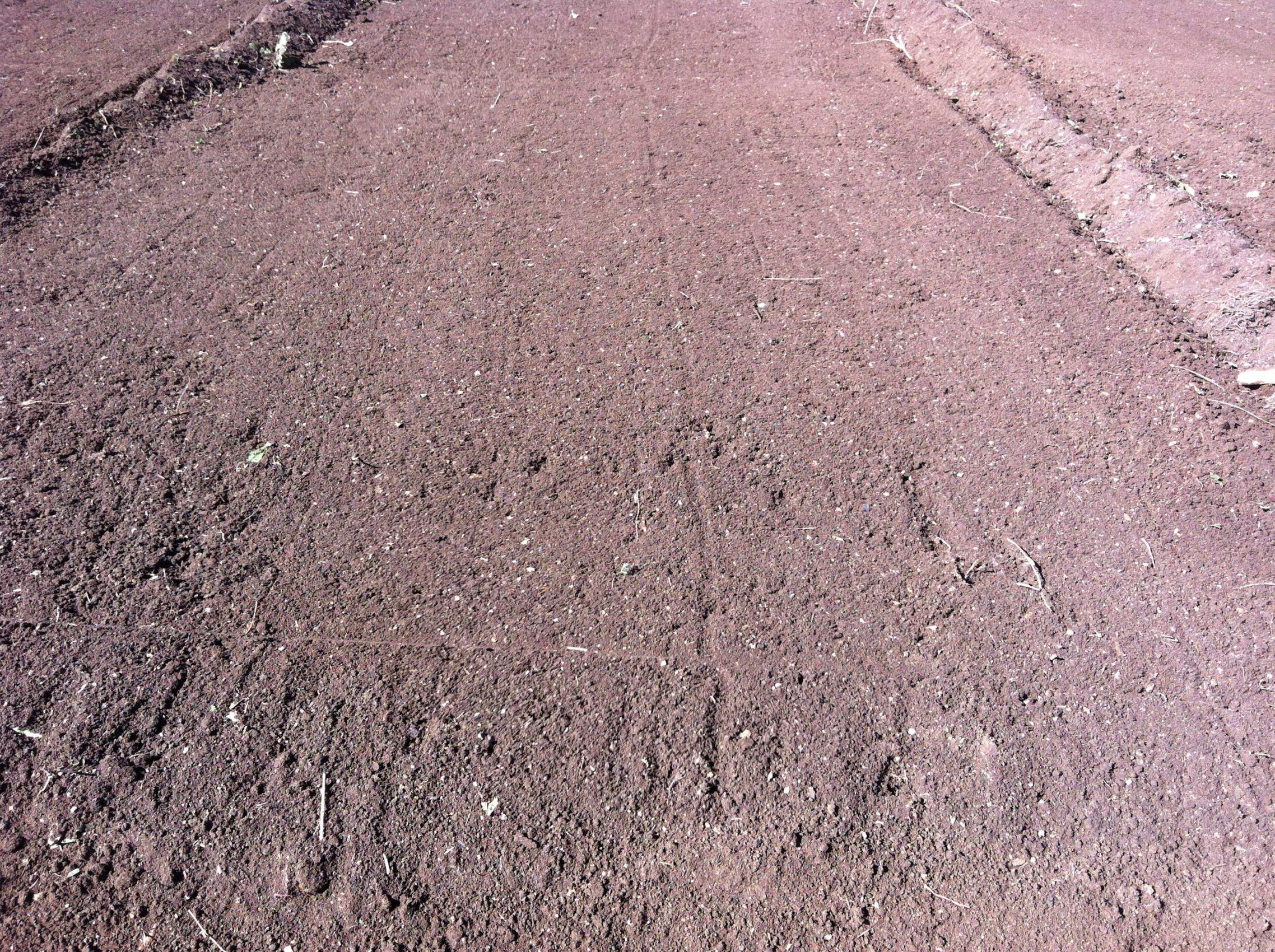

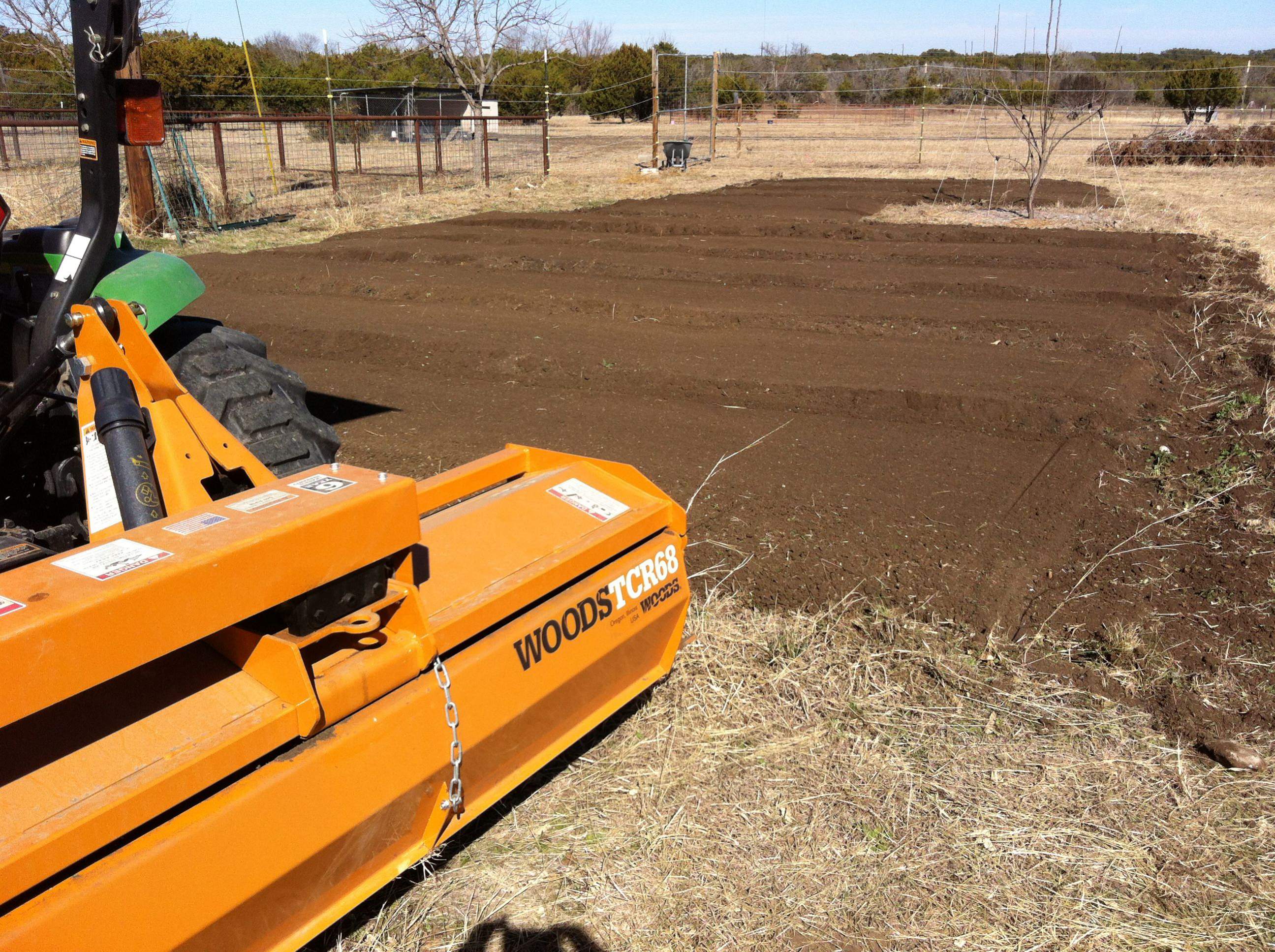

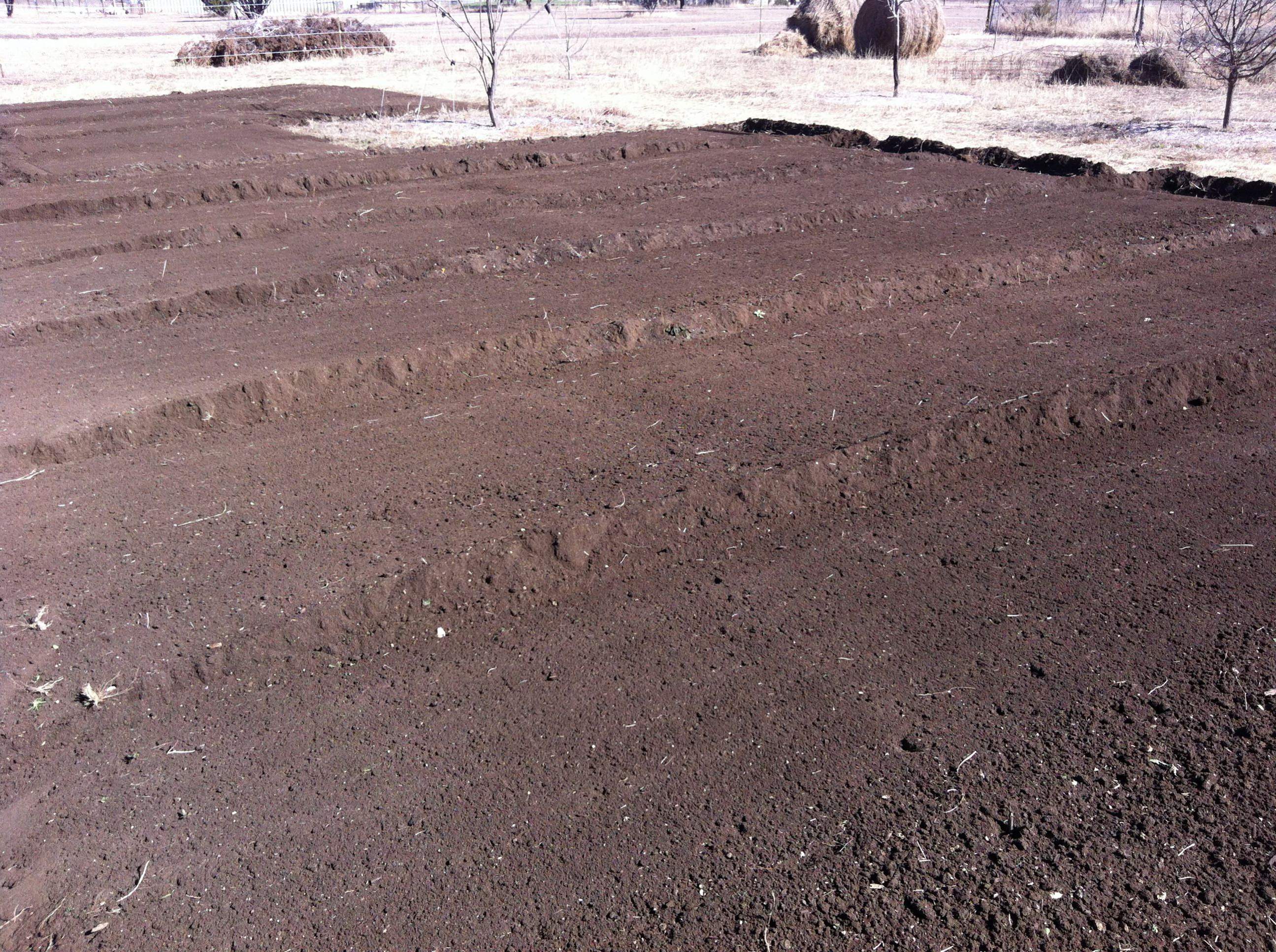

I'm very happy with my Woods TCR68. Photos from a couple days ago:
   / Need 6' Tiller Recomendations/advice
#24
Only problem is that im running a 50HP PTO....the TCR74 is rated up to 45. I dont know if that would work well or void warranty and break things.
