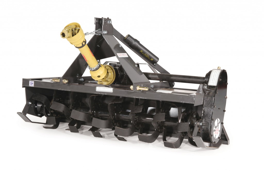

The Tarter 6 ft is geardrive and can be used in forward or reverse rotation. It does have 6 tines per rotor mounted in a scroll pattern and is slip clutch protected. $1795 + low cost lower 48 shipping. Ken Sweet
/ Need 6' Tiller Recomendations/advice #5
Here is a pic of the Tarter tiller and instructions for the reverse rotation conversion, if needed. Ken Sweet
