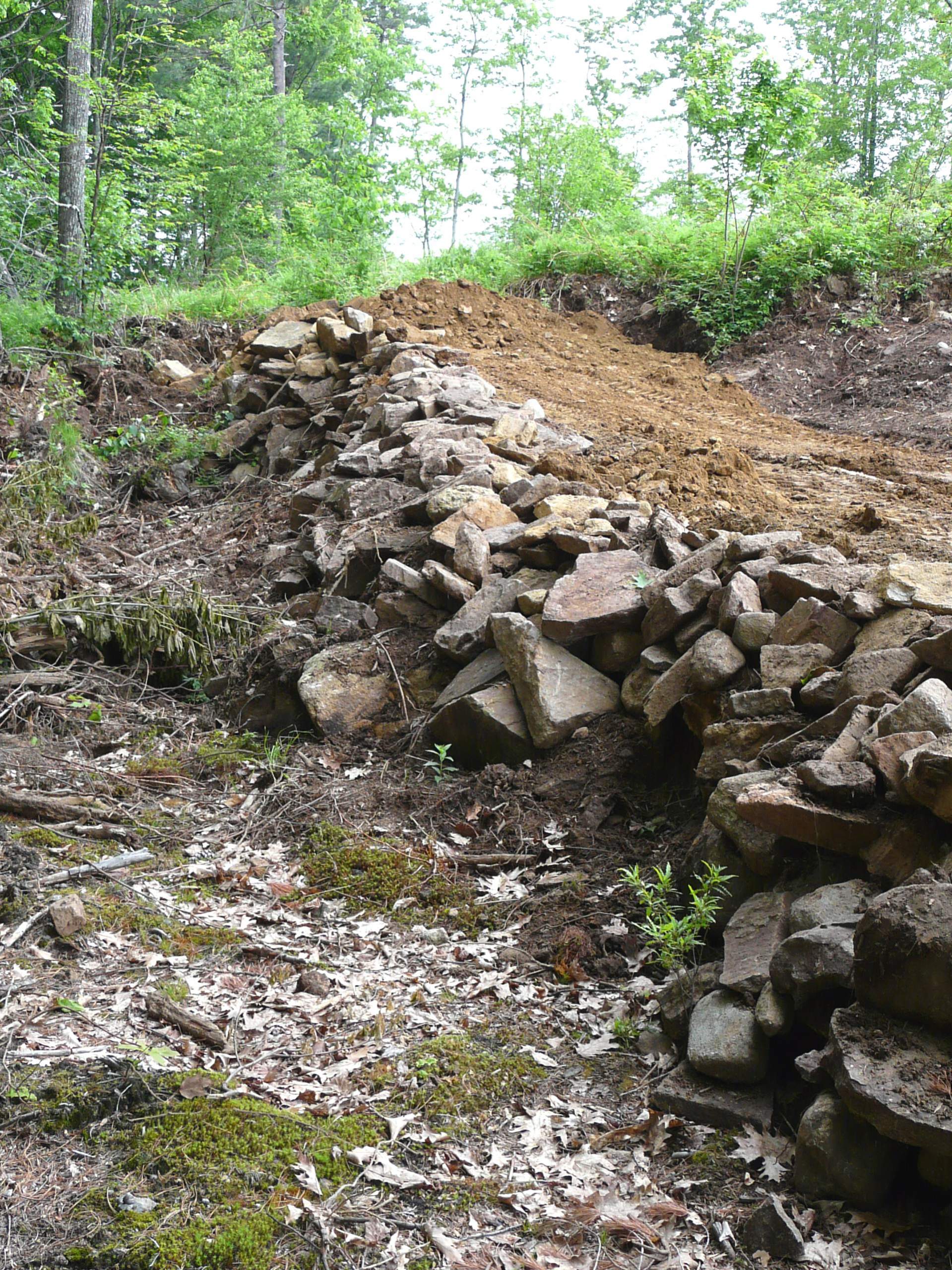

I used commercial grade fabric.
Was it woven or non-woven ?
Reason I ask is I'm about to do a similar project .... place here sells both .... and I have some of both.
My understanding is that woven is typically used under roadways to keep the stone from sinking and the non-woven is generally used in landscaping applications. I'd imagine that one could use either one in a wall like this.
BTW - beautiful job.
   / Natural rock retaining wall...
#27
It looked like it was just fibers laid every which way, and not a heavy woven fabric like they use on the interstates. It is fairly tough stuff, but you can knock holes in it positioning the boulders. I 'chinked' the voids between the rocks with smaller rocks and then filled what was left with red mulch. I am in the process [ probably last years ] of replacing the red mulch with granite chips. I had a big chipmunk poking his head out at me and giving me a hard time as I drove by in my truck. So, I am going to 'try' to evict him before he tunnels and tears up all my fabric.... He is gone now, was just passing thru... but once they figure they have a home, they are hard to get rid of... :)

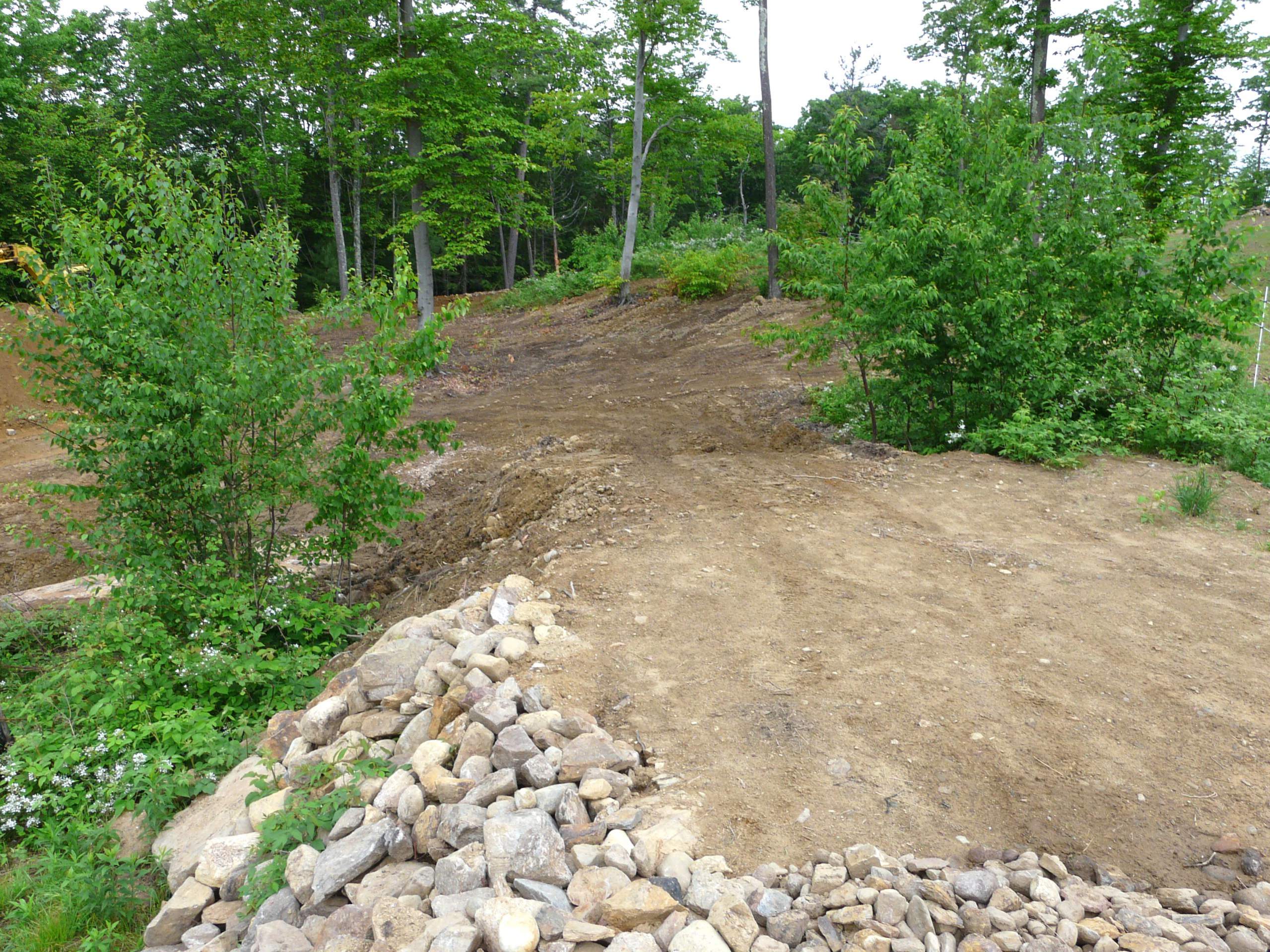

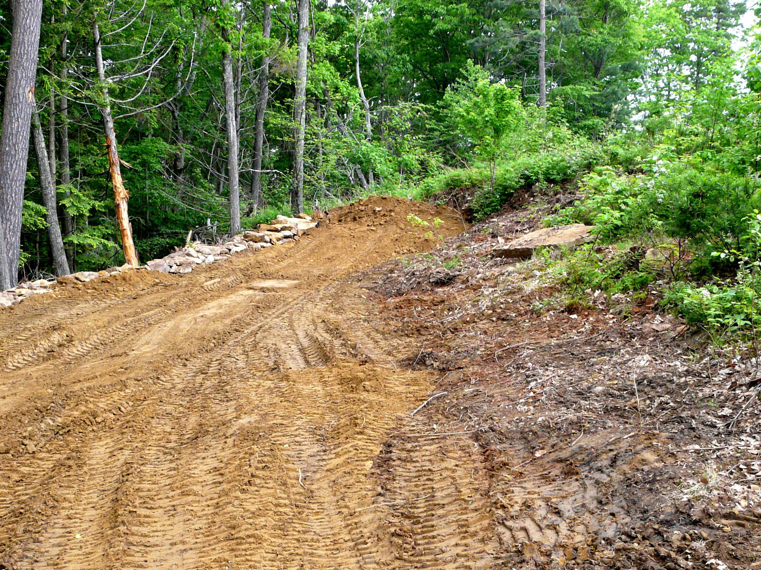

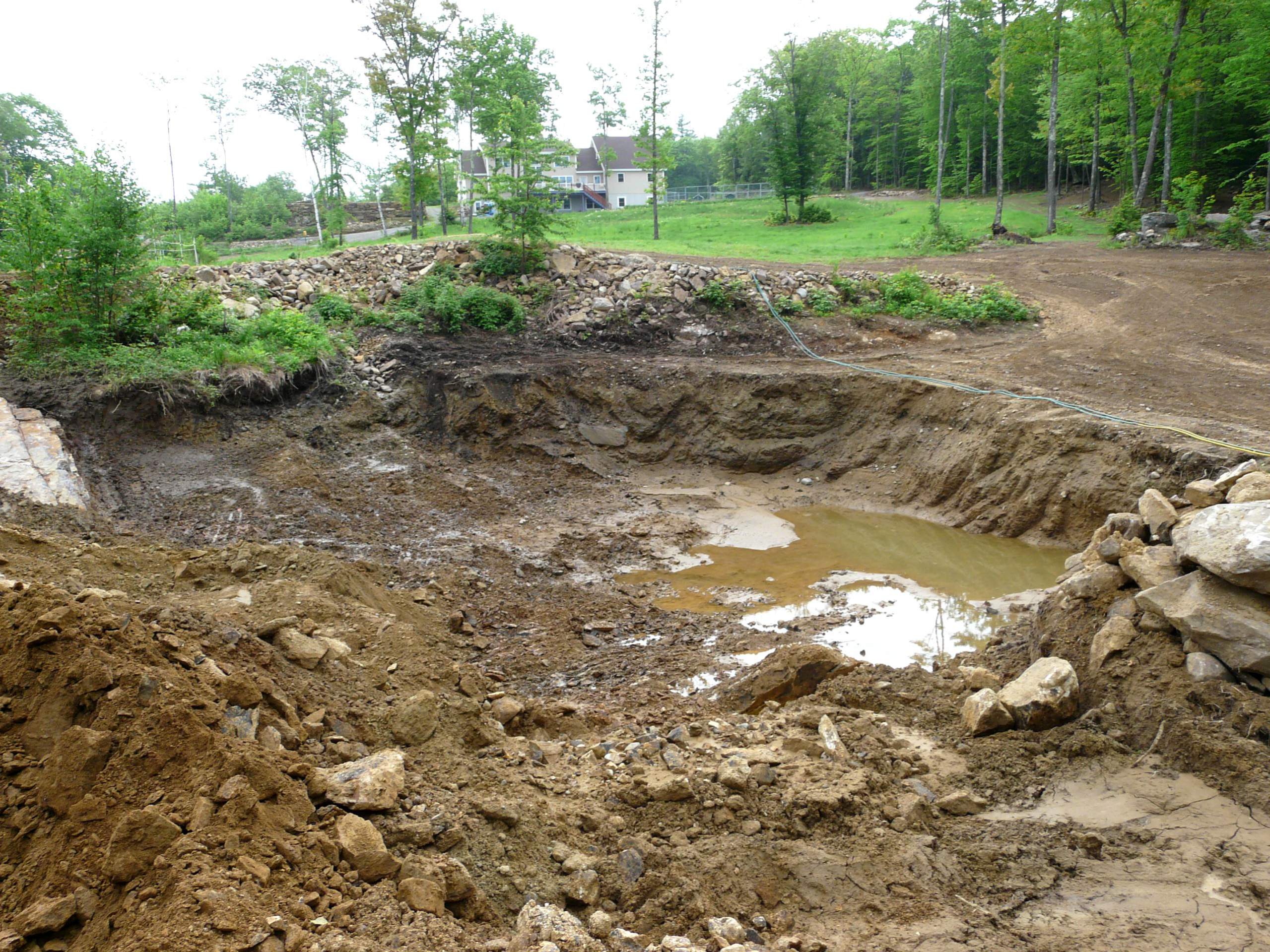

The terrain I'm working with is a bit different than yours, which appears to have been largely above grade initially. I'm cut into a bank at a total depth of 5' to 7' and I'm down past the 1' topsoil layer and the 2' sandy loam layer into hard, undisturbed clay/shale .... it's almost like concrete. Bucket on the loader pretty much won't touch it with having the toothbar on.
I've cut into the bank and have a drop off that ranges from 1' to about 3' or 4' .... I've tapered the cut back into the hillside a bit so the wall, when built, will lean into the hillside. All the topsoil has been removed from the slope and will added back in once I get the wall up high enough .... so figure another 1' or so of height, making the tallest point probably 5' ....
You can see the area I'm working with here:
Retaining Wall
I'm planning on using my loader to move, stack, and place the larger boulders and rocks - the largest of which are probably 30" or so in diameter. Wish I had a mini-ex (with a thumb) here to aid in placing the rocks, but that likely ain't going to happen. I'll probably throw the backhoe on and use it to shove stuff around and help with the positioning.
Had figured to use fabric just to avoid any soil leaking thru at some future point, although there won't really be any loose, undisturbed soil behind the wall - except at the top, when I add the topsoil back in ....
I'm also planning to make the wall high enough so that there is a bit of a swale on the top side, so that no surface runoff ever actually reaches the top side of the wall .... it will be channeled away from it before it ever gets there.
I've thought about leaving enough room behind the base layer of rocks on the bottom to throw in some gravel and 4" perforated flex pipe with a soil sock to drain any water that might wind up there .... but still haven't decided if I really need to do that.
One thing I do know - just after chucking around the smaller rocks for the dry creek beds - is that I do not want to have rebuild this wall at some later point due to poor design.

Took me almost two weeks to build, including puting in the grass seed. Most of the time moving the rocks here and there, over and over.. It would have been easier if the rocks were more uniform, but had to work with what I had. I dug down and removed the sod about four to six inches, making sure not to disturb any soil I did not have to. With some of the larger rocks I dug a little deeper. The main thing is to keep the soil compacted so the wall will settle as little as possible, but it will settle over time. Everything is leaned back into the bank, and I packed the dirt pretty good behind the rocks [ tamped with a big steel tamper ] as I built the layers. Don't look like much of a wall, but it took about 10 yards of dirt to fill in behind it. I folded all the extra fabric back in behind in spots. Give the chipmunks more to chew thru..... :)
