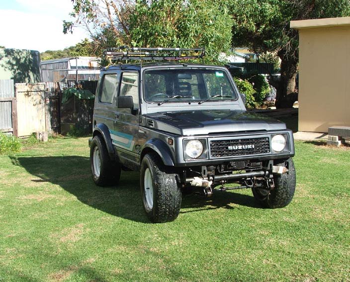

I've got two in the sidewalls of my suzuki sierra, running F100 rims and tyres. No problem. - but they were nice clean 'wire' punctures (not tears) and I only have about 20 psi in them. It mainly runs on the beach, not on the highway, but they haven't leaked a bit in about 2 years. I'd certainly try them in a tractor tyre.
And yeah you could do it without letting the air out - if you want to gamble with your eyesight. ;)
