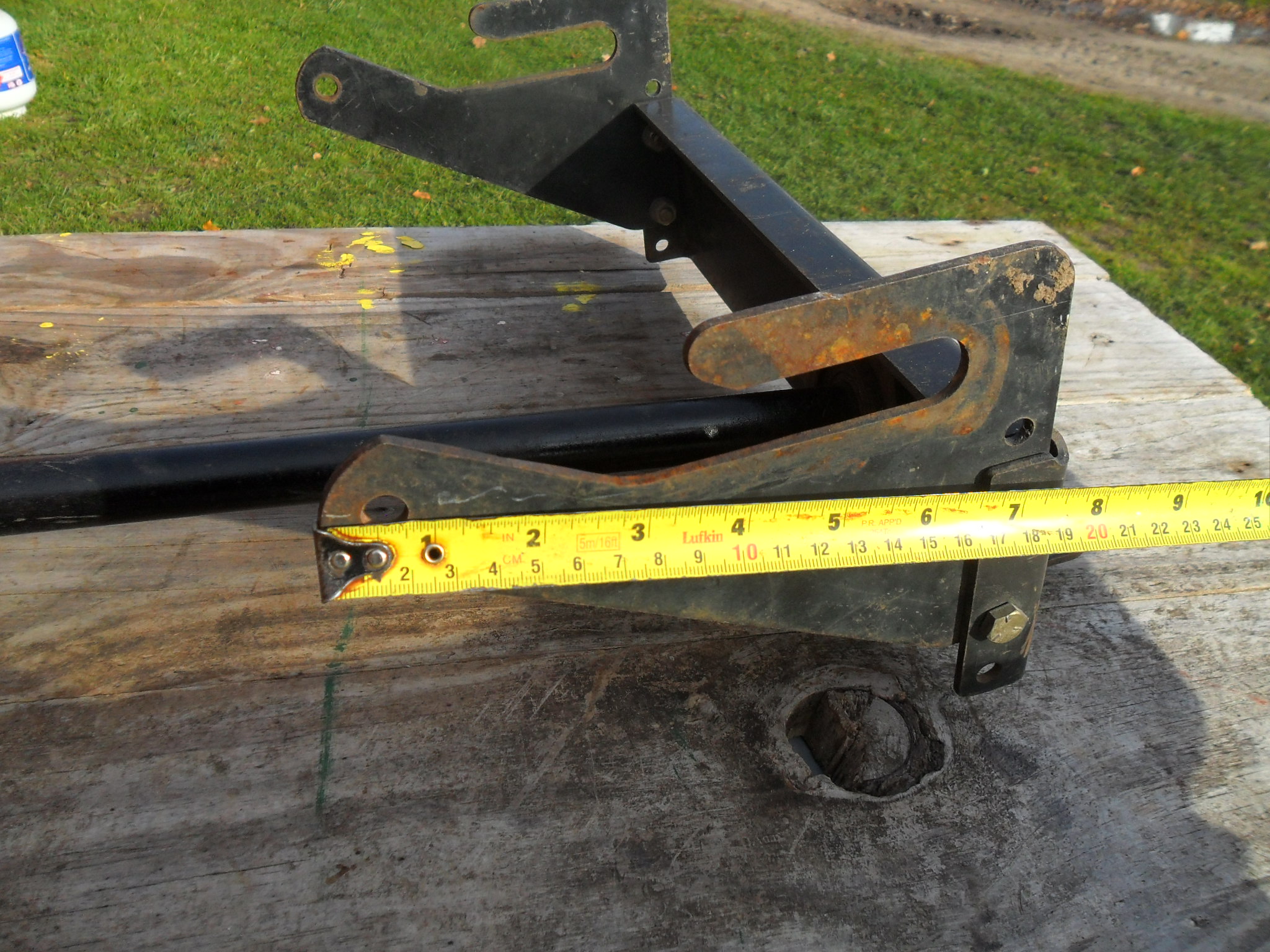

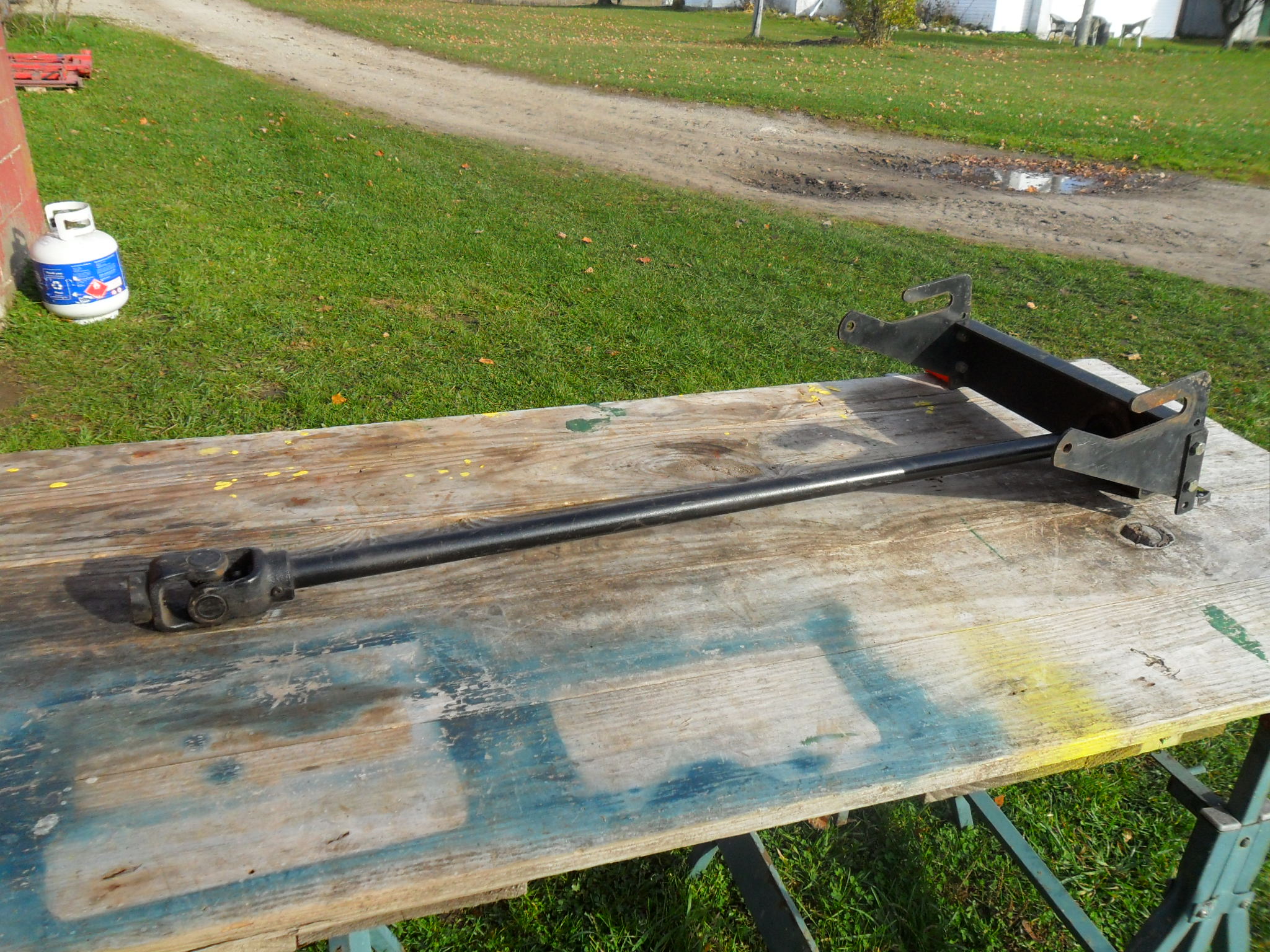

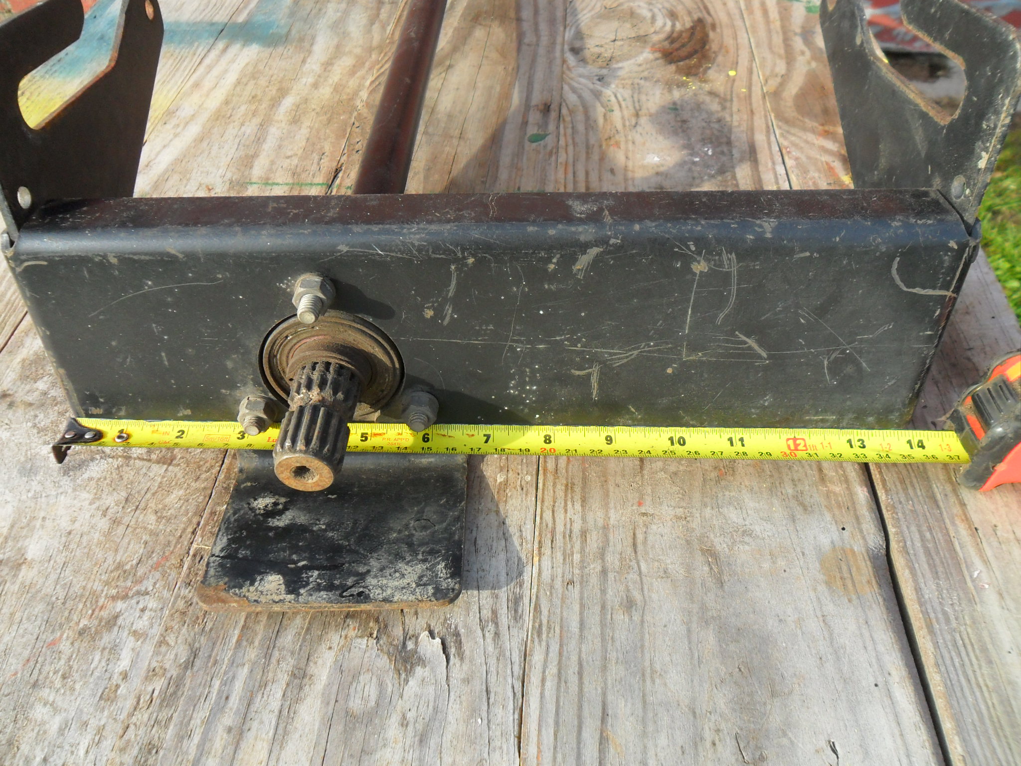

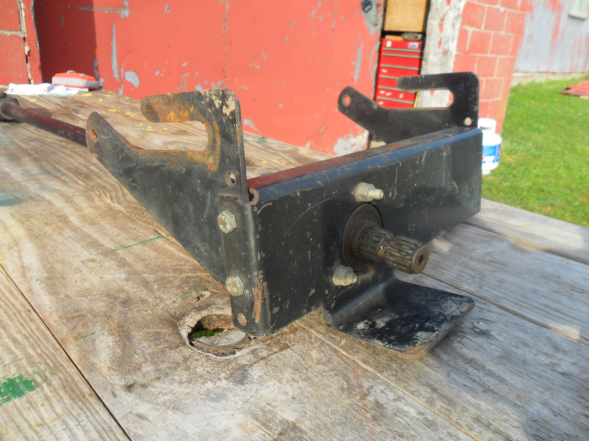

Gentle readers; I have this mid-mount PTO attachment but do not know what tractor this fits. Most likely compact / utility tractor in the 20-30HP range. Dimensions are shaft 40.5" tip to tip. Hanger bracket is 14" wide. 15 spline. Any help is welcomed. Thanks!

Looks like a shaft and front mount bracket to carry the mid-PTO forward for a front broom or snowblower possibly.

Thanks for the comments so far. I did drop into a local tractor dealer that has a very large repair department. The ancient mechs were not able to point me to a brand name. They did say its a mid-mount PTO for front-mounted attachments (snowblower, broom, mower, stump grinder etc.). They also told me the bit about 20-30HP maximum due to the guage of the metal and shaft.

OK, that makes sense...
I just did an image-search for 'mid mount pto' to see that the PTO faces forward, so I can now see how this would work.

Yes.. It is obviously a front tractor side mount to carry the pto.. Then the implement mount and lift system would attach to this bracket, with a short pto to the implement.

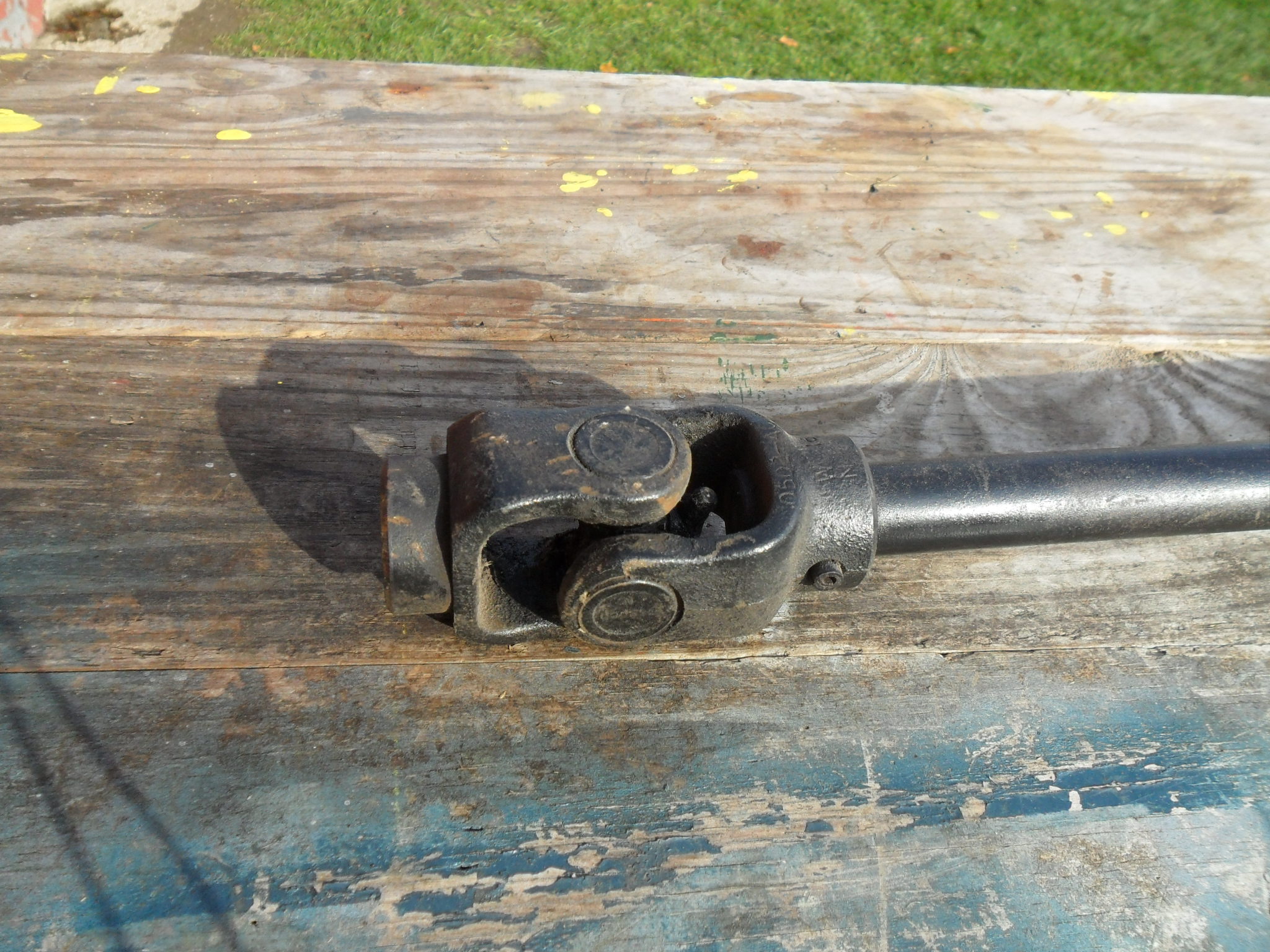

Hi Aaron; the only number is a standard Neapco U-Joint part #. Nothing that leads me to the manufacturer of the rest of it. The stamped frame has no markings at all.
   / MYSTERY PTO- Mid-Mount #9
Looks like it would fit the front of my GC1700 series Massey, it is a clean almost universal looking mount for mid to front pto, if it fits it will work type deal with the exception being the length of the pto shaft.
I think I would need to flip it so the off set is on the left rather the right while sitting on the tractor but maybe it would not matter and like I said it looks universal.
