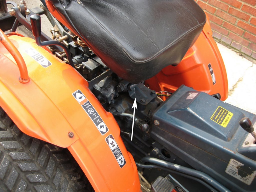

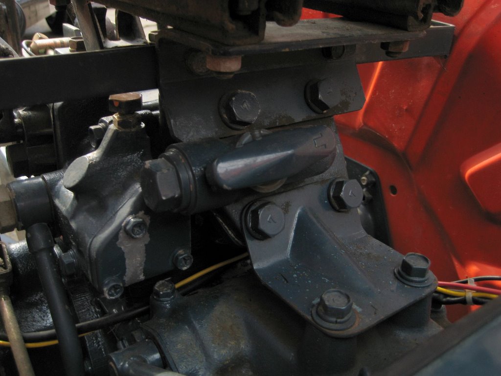

What I did find was a knob with an arrow on it, on a valve with 3 detent positions, just under the front of the seat. I checked my shop manual but can't find any info on this valve. Anyone have a clue?

That valve will bypass the TPH to an accessory hydraulic circuit if one is installed off the end of the valve. If one is not installed it may dead head the hydraulics. (not good)
I'm sure some one will be able to give a better explanation, but that is how I understand it.

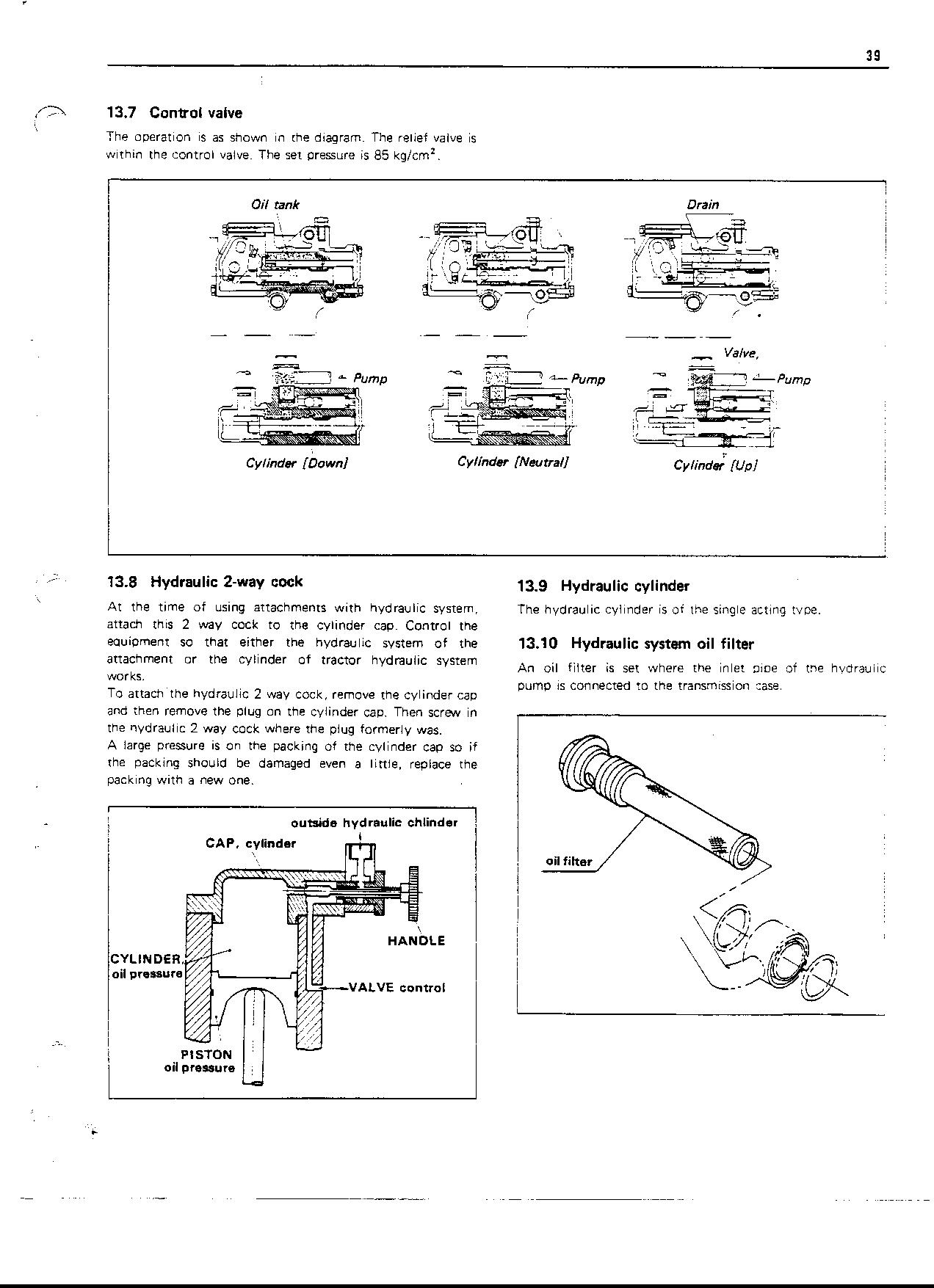

It's the auxiliary port to run other hydraulics. You lose the 3PH if you spin it. I think there's some bypass/relief stuff in there so you cannot deadhead it. See the picture for some info on it.

If the valve has not been turned in a while. Be prepared to install a new o'ring on end of shaft that is attached to lever. Had this happen to my B7100 twice in the 15 years I owned it.

I see! So I'm guessing that's where I might tie in if I wanted to put a hydraulic top link or whatever. So now I guess that the valve, having 3 positions would be like:
1. lift only
2. aux only
3. aux and lift
Does this sound right? I guess it would require more investigation to see where a return might be plumbed in.

You only have two operational positions (1 & 2 on your list) so it's not the best place for hydraulic top link since you have to switch back and forth to use the 3PH. Putting you hydraulic top link inline to the block you mentioned would make operation simpler. The return can just be T'd into the existing return line.

In your first picture, there's a bolt with a locknut on it. Turn the bolt counter clockwise and it should lower your 3ph faster. I have a 1978 B7100 gear drive and that's what my 3ph adjuster looks like.
