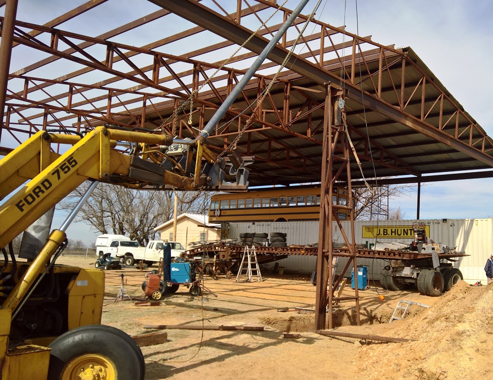

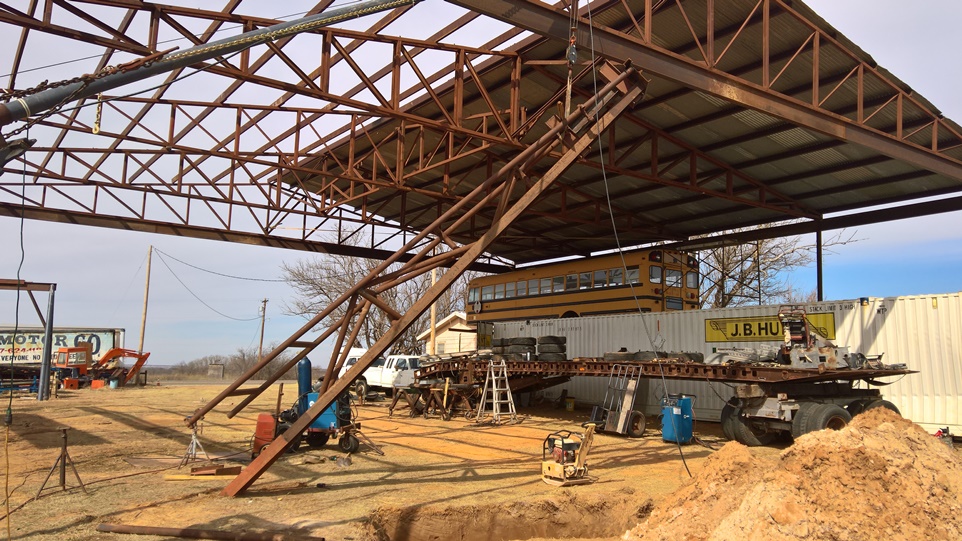

I had just a tad more welding to the top of the column this morning then I did this.
I swear I could lift the limit of the hoist on this rig with the gin pole laying flat .It has proven to be one of my most valuable builds in a long time

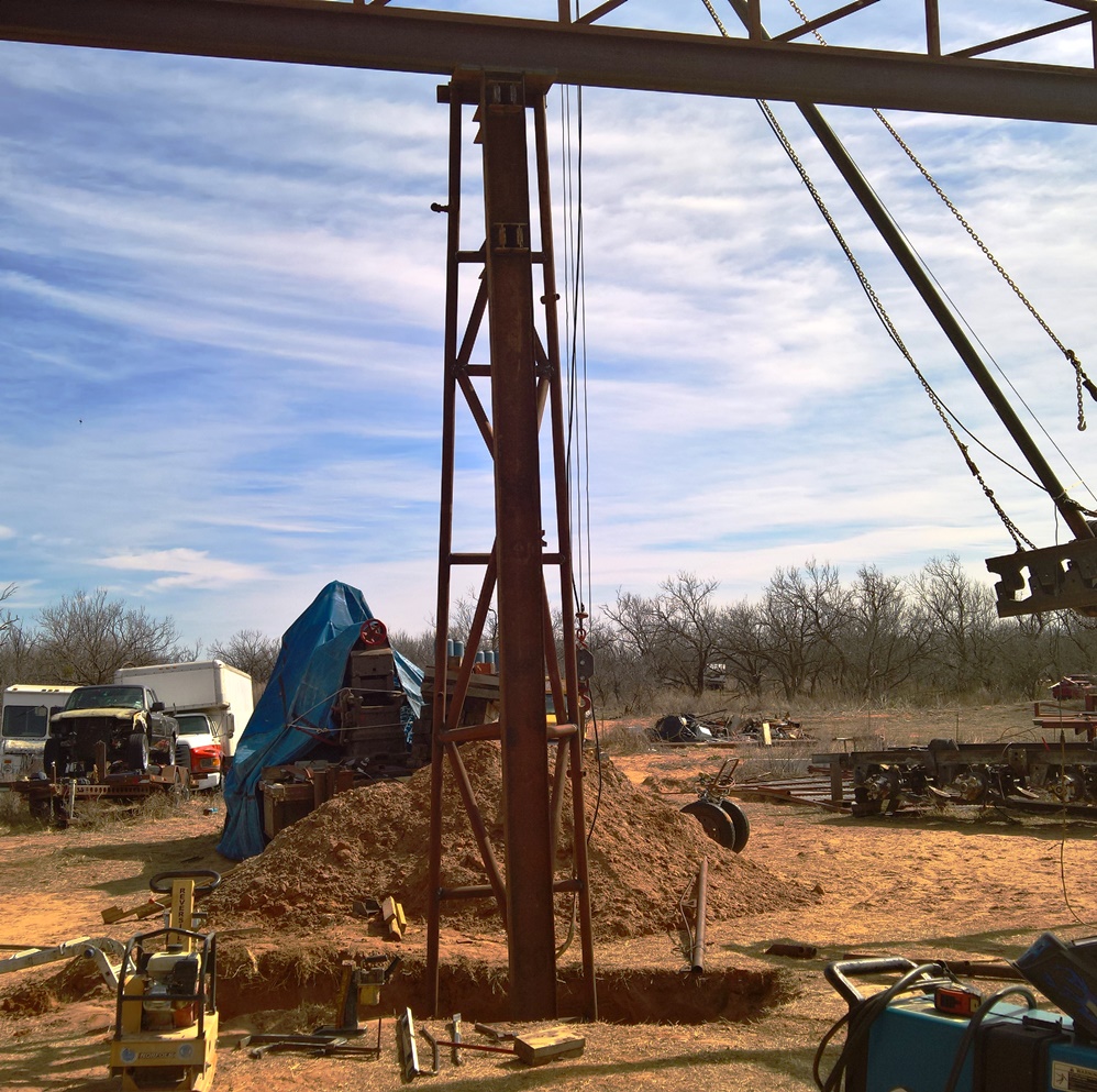

Well the column is all plumbed to vertical in all directions welded in at the top and welded in at the bottom.
I hit pretty close to my length measurement I was hoping to have it around 1/2inch too long then use a 8 tone hydraulic toe jack to lift the truss above to add preloading but it was only about 1/4" to 3/8" over length and as it turned out that was about all my jack could stand and I had to really sledge hammer it in place.

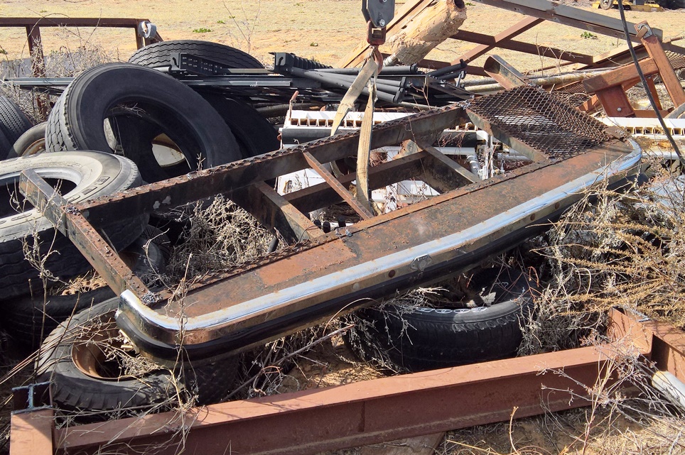

the next thing was to come up with something suitable to put under the brace piping as a base so what better use than an old RV bumper

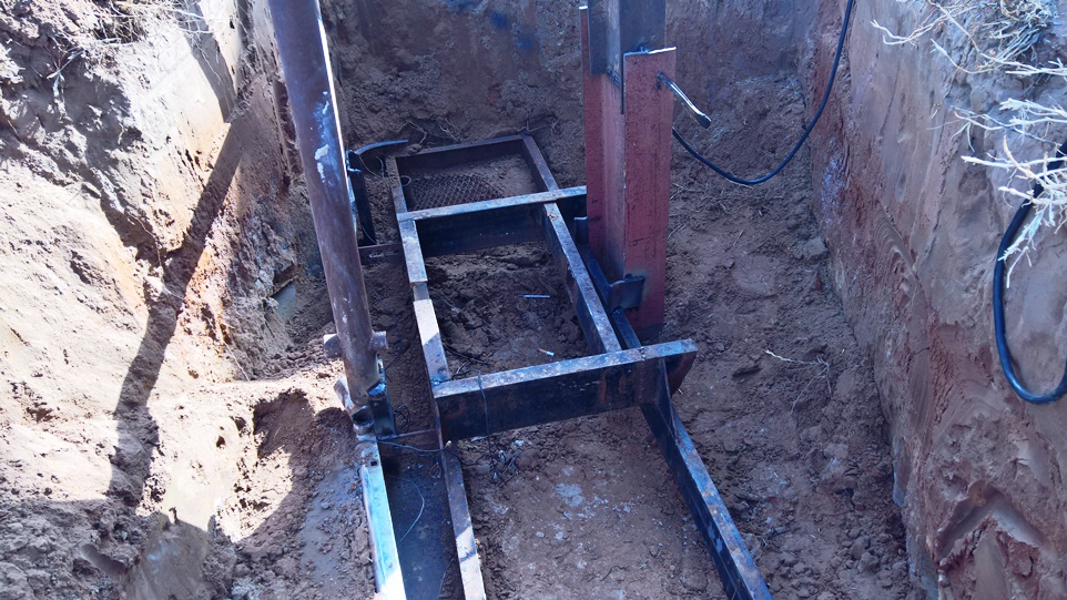

I back filled to the top of the horizontal beam the column is welded to then packed it briefly then after placing the bumper in position I used the plate packer to force it into the already firm soil it took nearly an hour of running the packer back and forth on top of the bumper to settle it in then I scabbed some junk materials to the bottoms of the pipes to weld them to the bumper and welded the bumper to the column as well

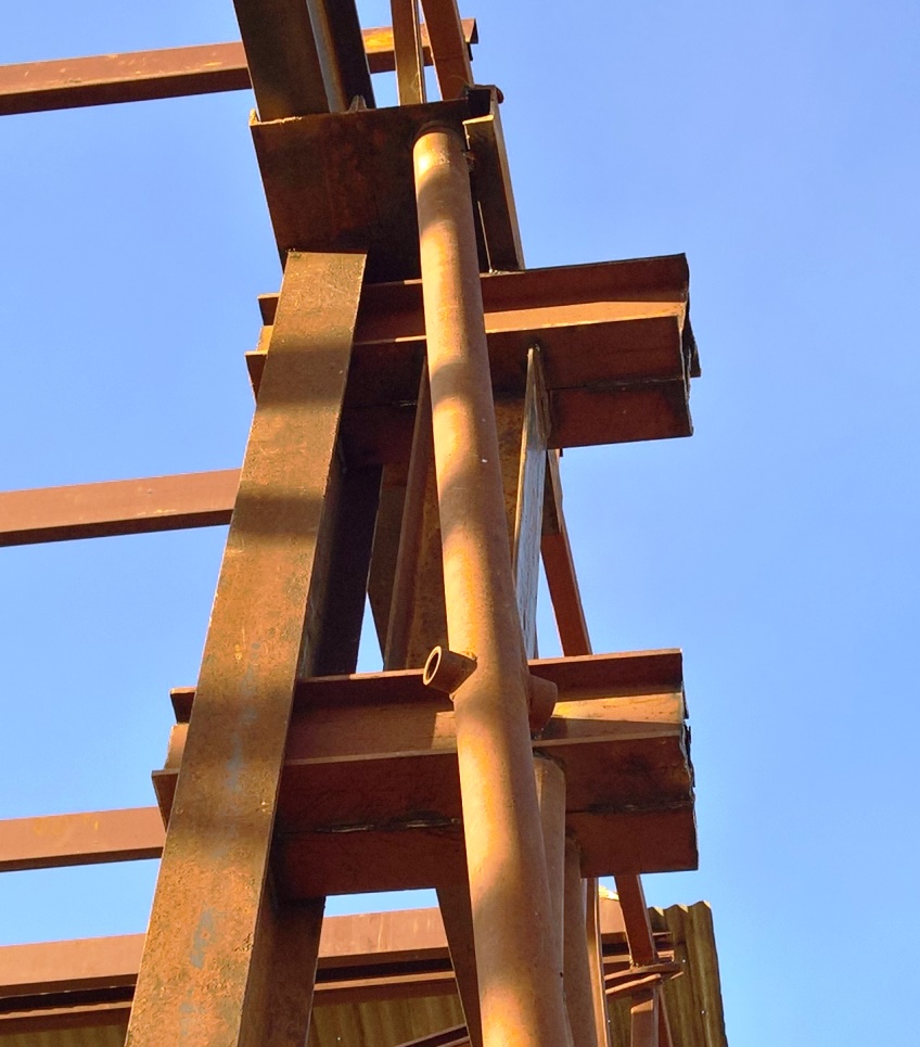

the jib crane mounting bosses for the inside
the same thing for the outside
back filled and packed to about the half way point I need to fill and pack about another 1 1/2 feet then I have some more bracing to weld in
