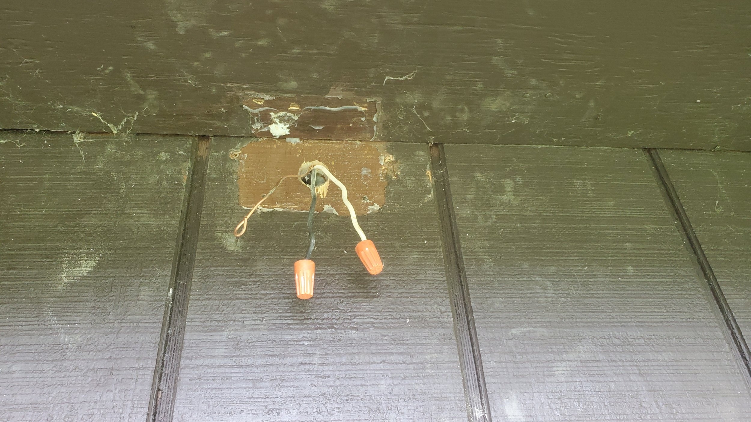

I am replacing an old floodlight setup on the side of my house with a bigger LED light. The problem is after removing the old fixture, I realized the wires coming from the house are not long enough to reach into the new fixture. I was thinking of putting a junction box where the old light was and running wires from there to the new light.
Any better ideas out there?
Thanks
Dave
   / My wires are too damn short. #2
How does the new fixture mount? Can you mount it to an exterior utility box? Then you can just add some short pigtails.
   / My wires are too damn short. #6
If you can't make them work because of their length just splice them with some end to end connectors or wire nuts.
   / My wires are too damn short. #7
If your going to use wire nut wrap them good with electric tape...3M.

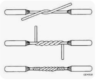

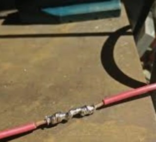

Me...I'd just use same gauge solid copper wire, scrape those clean, make a western union splice, flux and solder. Same black, white, bare copper & double heat shrink white & black.
