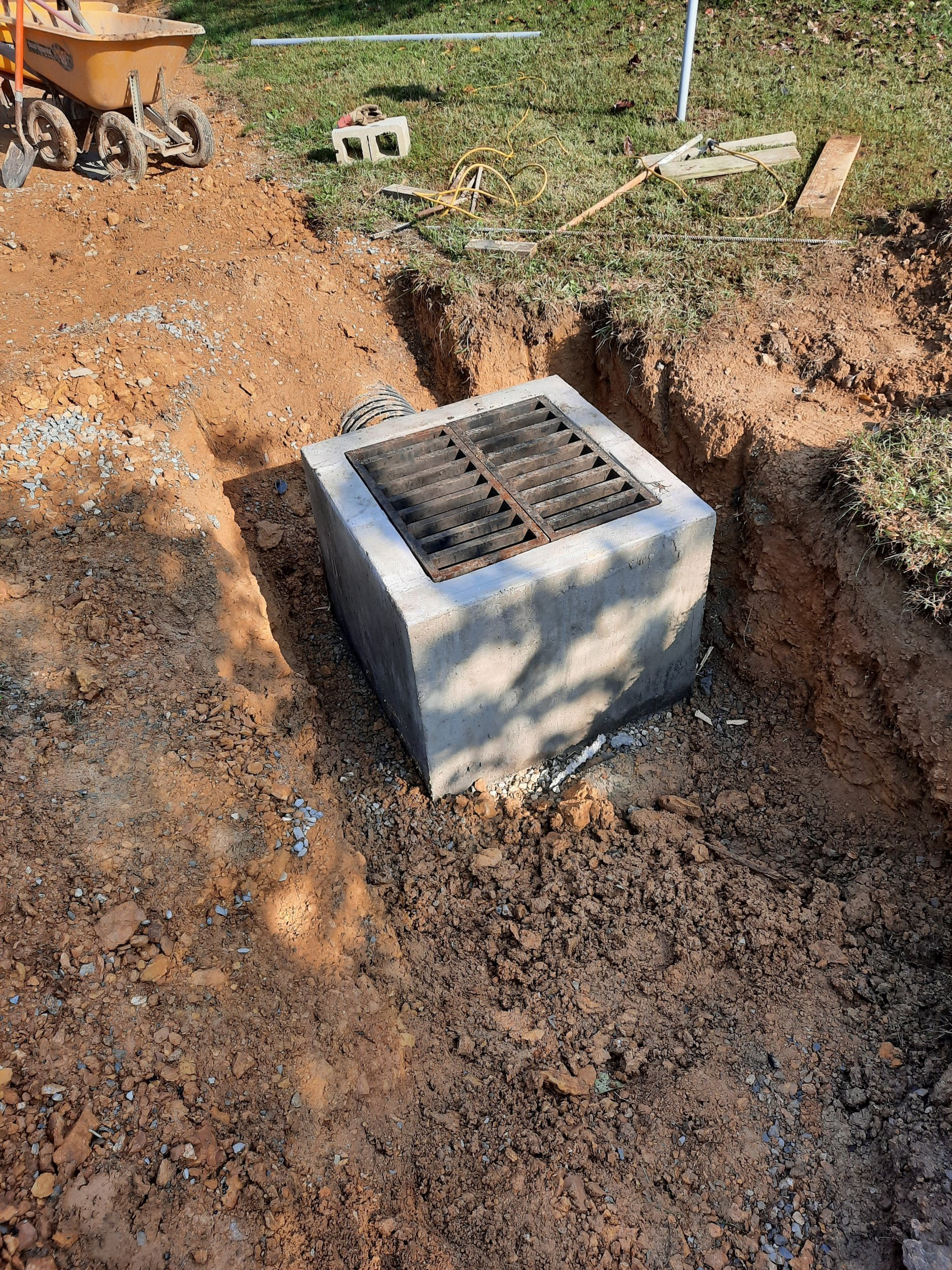

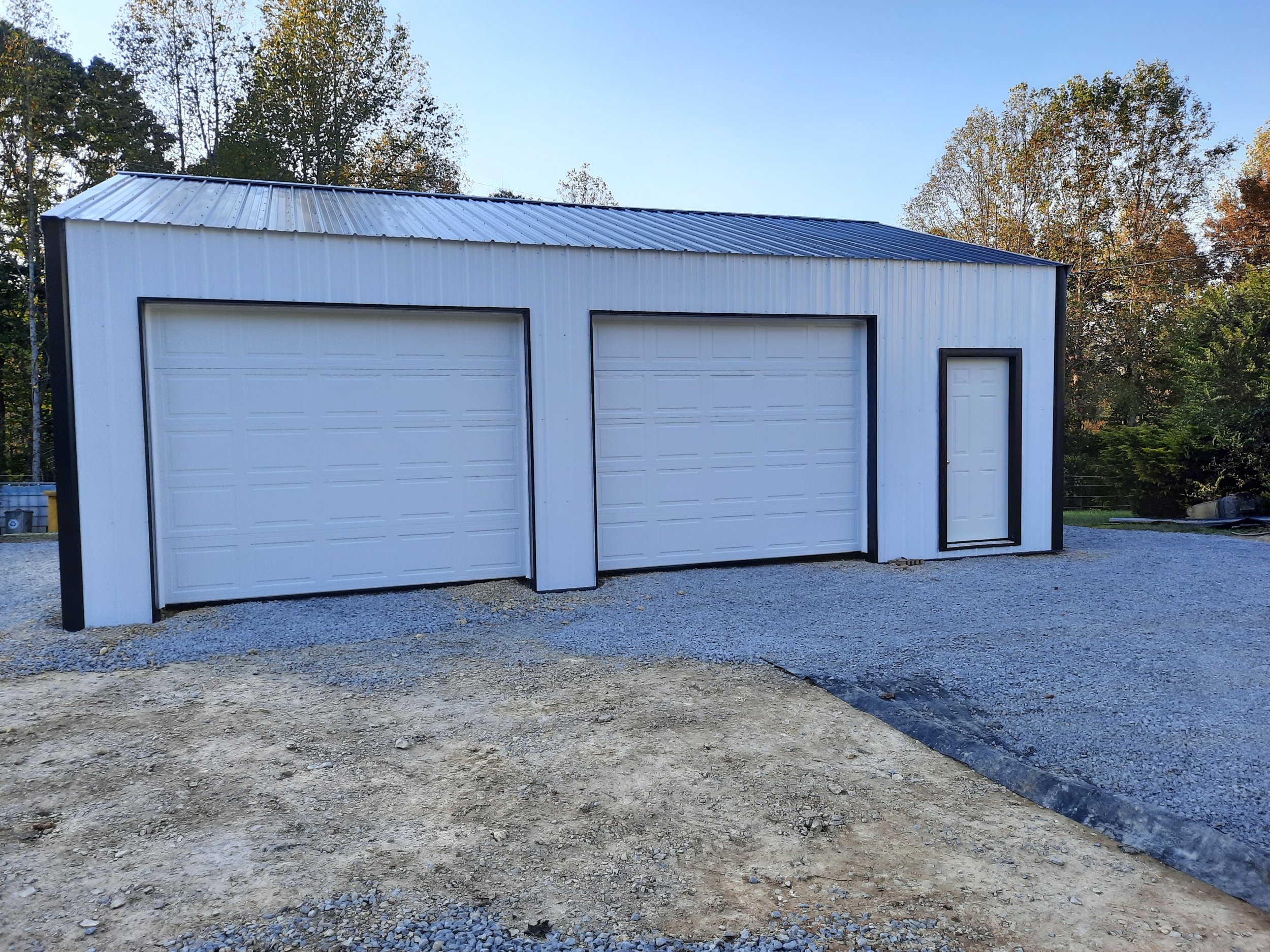

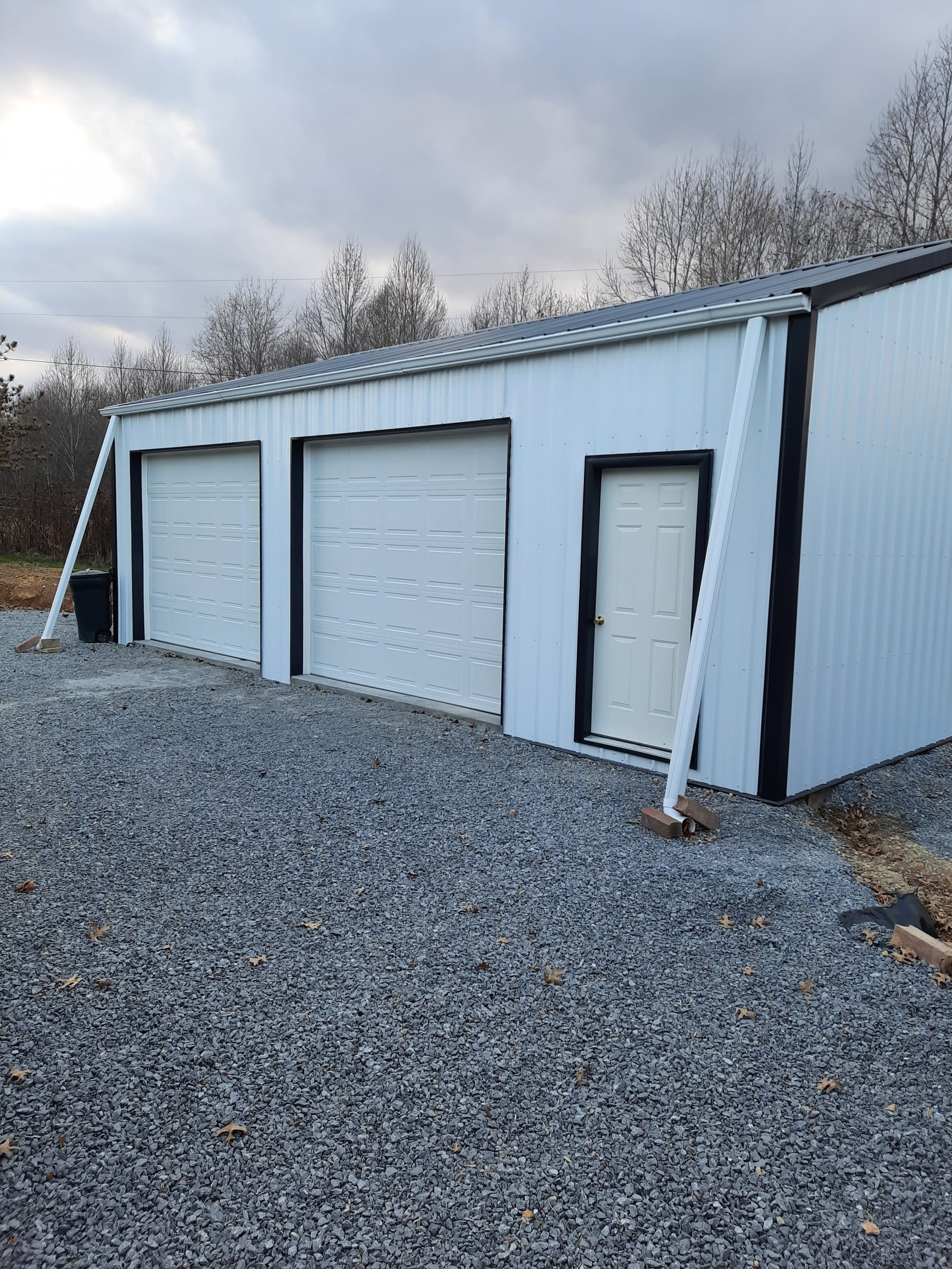

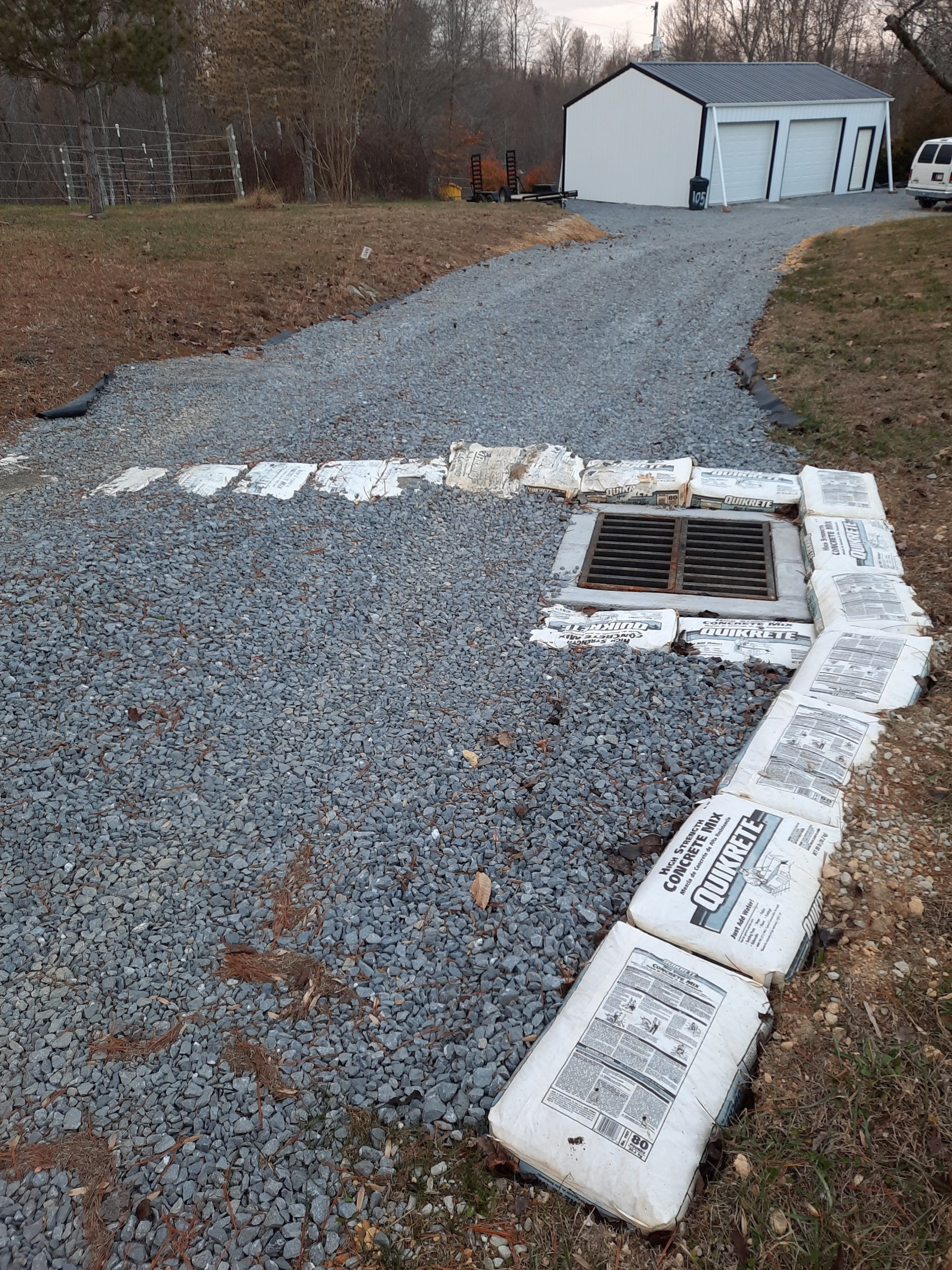

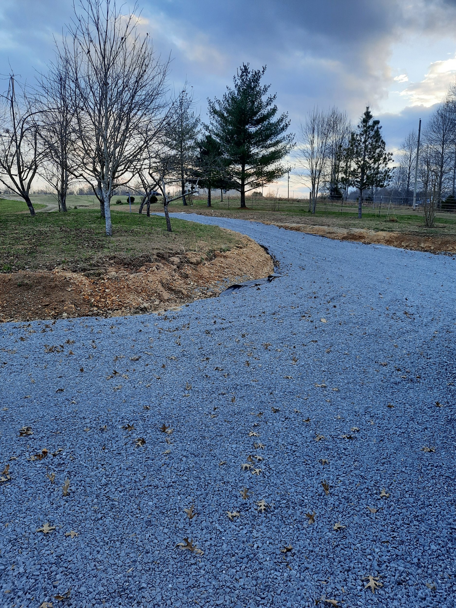

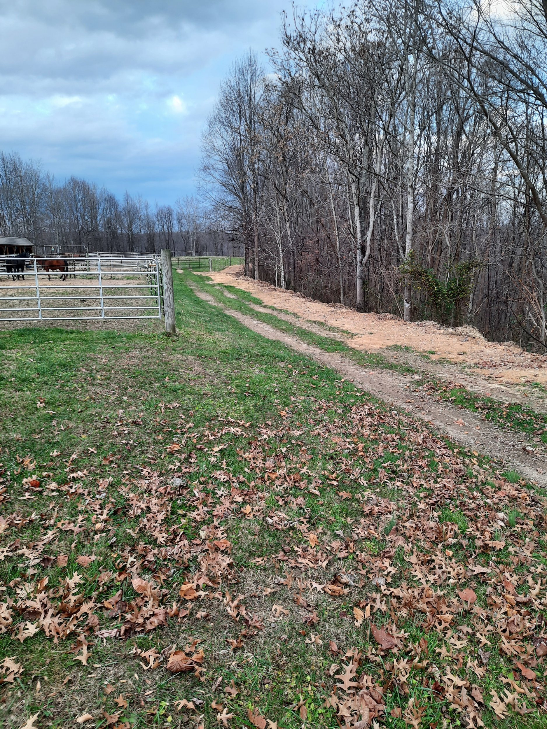

I had the local Amish build a 32 x 24 deep by 10 foot high building this fall. Leading up to that, I rented a Case 580m for a week to dig my driveway down to divert water away from our house. Our place is on a ridge so I chose a rubber tired backhoe to haul the fill and place it along side of our horse fence to level out the slope. I found some drain grates at a local scrap yard and poured a catch basin to divert water into 160 feet of 12 inch double wall pipe. It's still a work in progress. The concrete floor is done, electrical done, gutters are done but I have to dig in the drain pipes and secure the downspouts.

Thats a good looking building, I like the dark trim.
