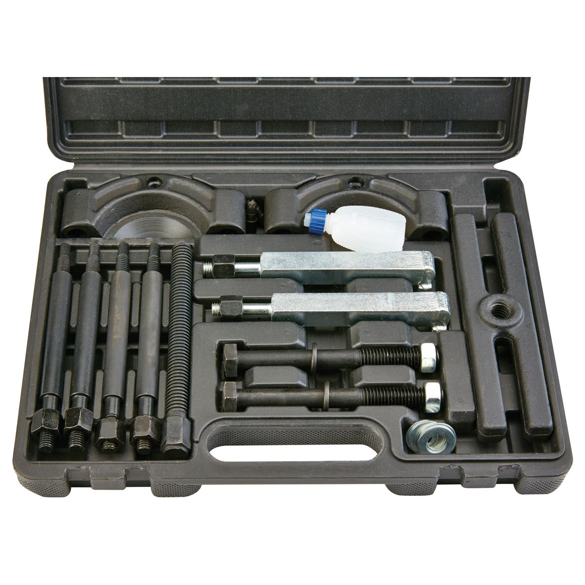

Another way would be to use an H type puller like illustrated. Advantage of this would be pulling forces would all be on the stuck component vs any support bearing/seal/cases/etc. The kit shown also comes with a bearing splitter that can be helpful to gain purchase on something with rounded edges. Have to make sure the “H” component has enough span for a given pull/application and the extension bars are long enough.
Even used something similar to unload torsion bars on an old Blazer…...
Propane torch on the knuckle while pulling .....
