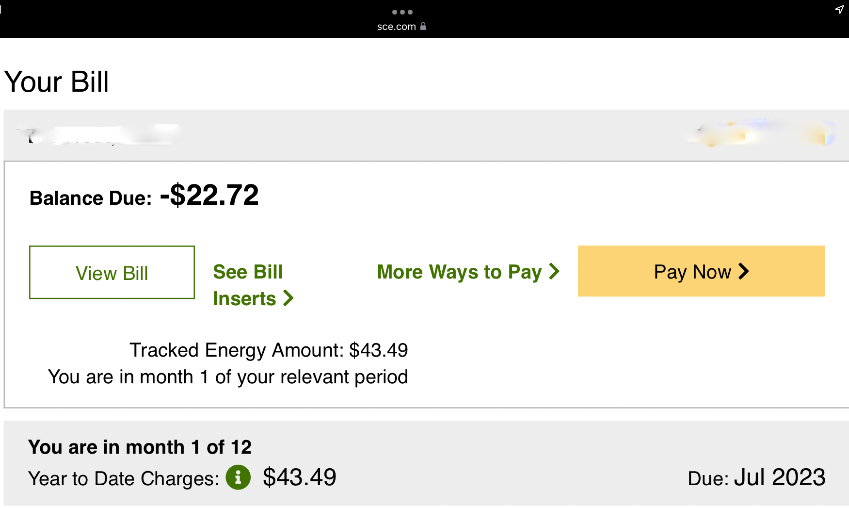

I am serviced by SCE. Every year on my anniversary I get a bill for usage during the last year. It can be a charge or a refund.
This is this years charge. In addition this year i went total electric with the conversion of my HVAC to mini splits. That will save me $1400 in propane next year.

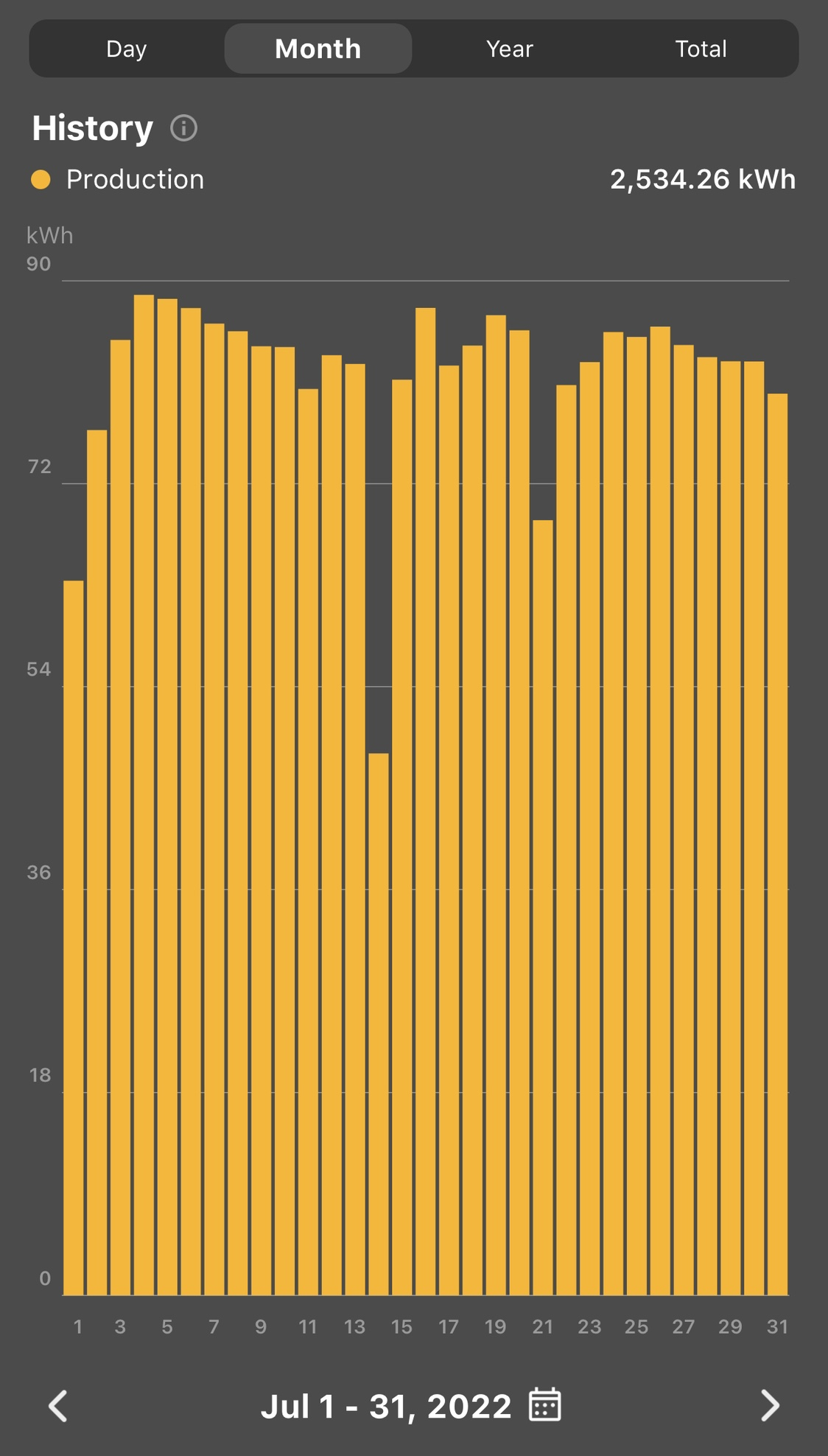

Looking like 5-6yrs for my system to produce what it cost. Was closer to 6-7, but our power cost has increased 50% since March.
Produced ~$370 last month
Is it working? What did you pay to put in the solar system? Relative value is a 50% savings, but absolute is only $60....which isnt much at all.

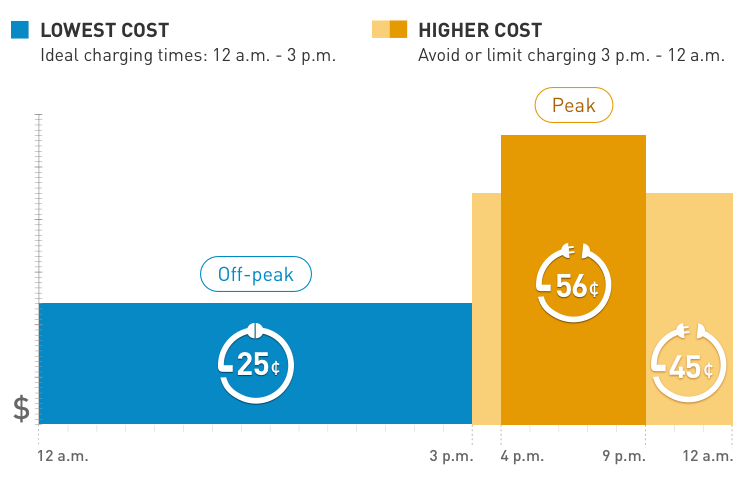

Here is why the ROI is so short;
Yes, that is $0.45/kWh, or more from 3pm to midnight. The utility is literally telling customers to have cold cuts for dinner to save energy, and not to cook.
For many folks, this pricing actually makes adding home batteries a sensible investment to be able to live more or less normally as you can use your own solar power after the sun goes down and not draw power during peak times.
A family east of here a bit is paying over a thousand dollars a month; no EV, just running the AC at 78F.
