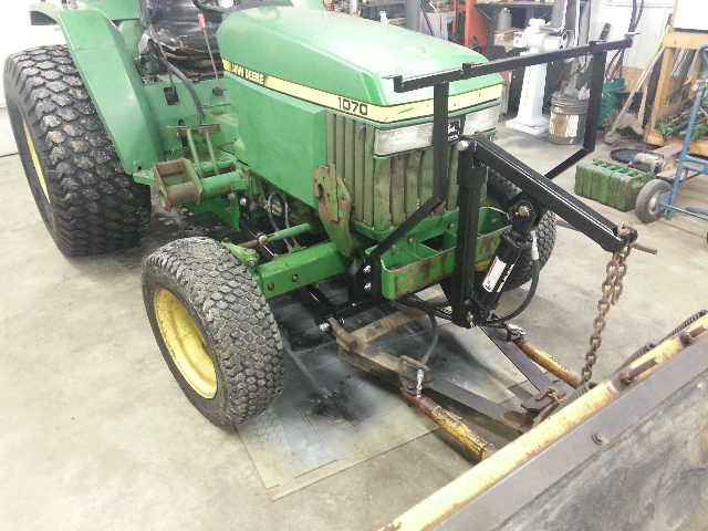

Very well thought out installation.
You made pivot points low enough to get a straight push so that you should not lose steering with angled blade.
IMHO most tractors need a plow subframe for decent results as the plow arms (A frame) need to be parallel to the road surface otherwise you end up jacking the front end and result in light or no steering.
With most blades being wider than the tractor the lightness gets amplified as well.
Nice work and good thinking.
Thanks, yes the steering seems to be fine (at least from the little I have tested it) as I was able to still utilize most of the weights, and as you mentioned the mounting point is low (nearly level). Now traction will be the problem. I'm going to make a counterweight for the rear instead of the rear blade I have on there now... hopefully it will help, eventually I'd like to get the tires filled.

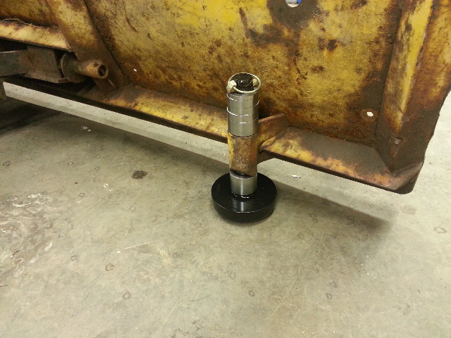

Got it painted and just finished reinstalling it.
Here is a close up of the feet installed.
The edge is 1-1/4 off the ground... we'll see how it goes. Maybe over the summer I will take the plow apart and have it blasted then paint it. I will also probably install the crossover relief at that time.
That tractor looks like it is set up for a loader. why didn't you simply attach the plow to the loader? Substantially simpler.
Well a couple reasons really...
Yes the tractor is "set up" for a fel, but it is in pieces. I bought it cheap a few years ago but it needed new pins/bushing and the hydraulic lines aren't in great shape. I haven't finished it yet.
I also didn't want the plow hanging out that far in front of the tractor. As it is right now when angled I have about 6" in front of the front tires. Being 2wd I had concerns with steering with plow angled. I believe this setup is also more maneuverable in tight areas.
The added weight out that far would also unload the rear axle even more, giving me less traction (again, 2wd).
I also don't like the idea of putting all that strain on the fel arms. Maybe it's unjustified concern, but is a concern nonetheless.
