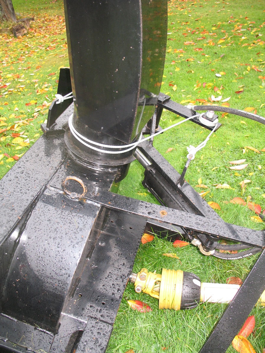

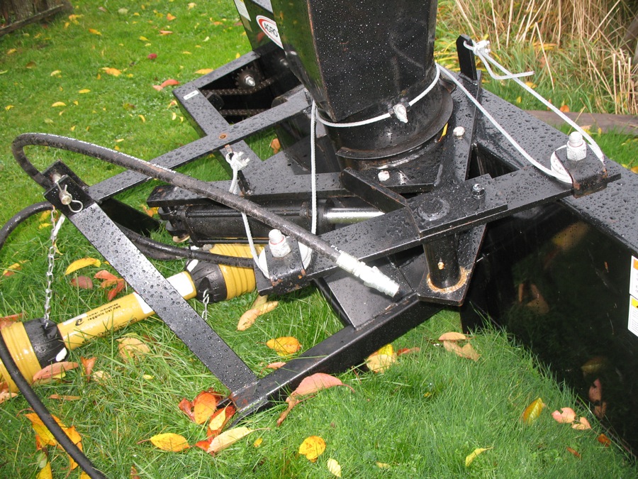

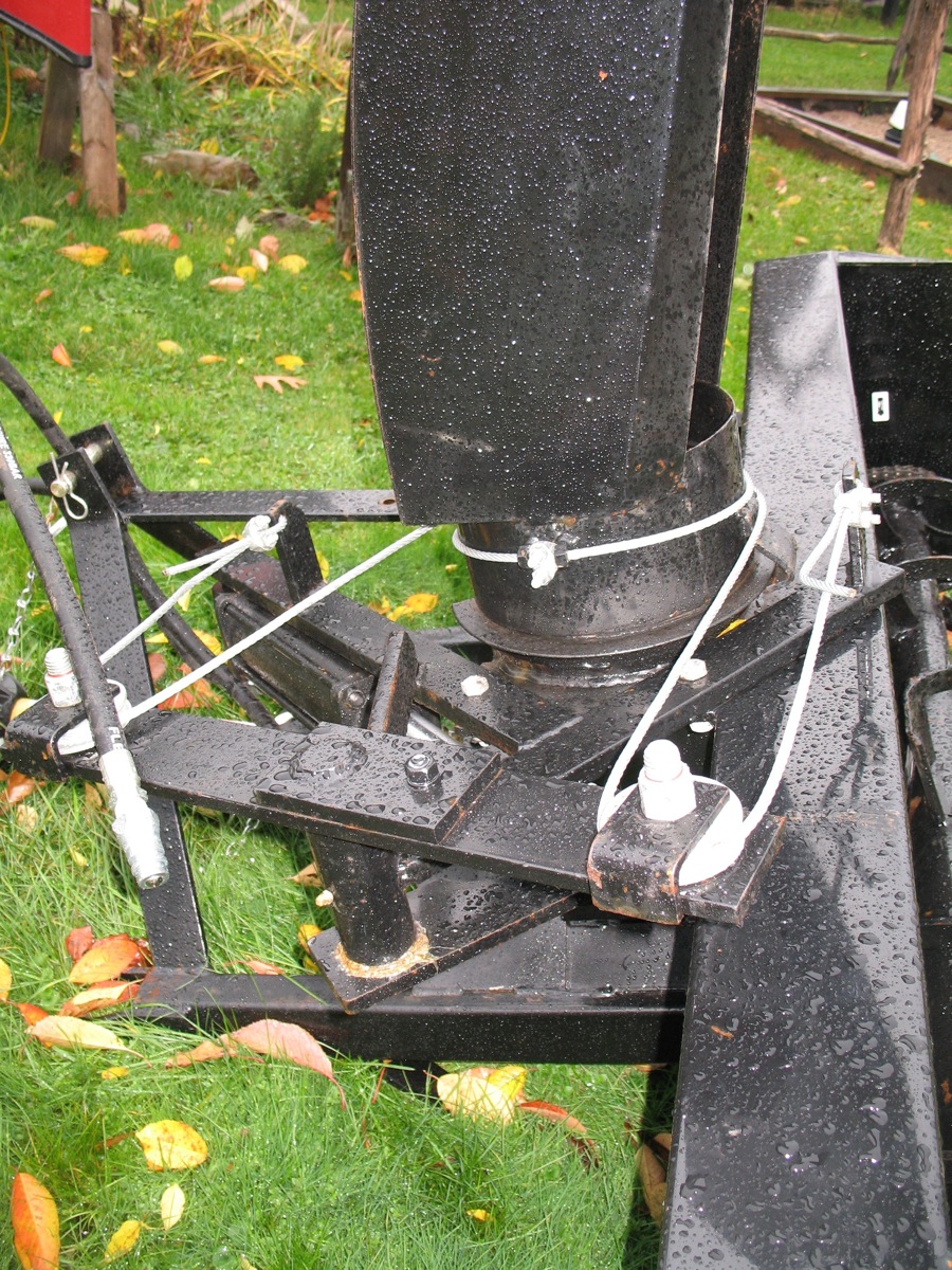

(Snow melts, water runs down into the sleeve at the base of the chute and re-freezes, preventing the chute from rotating.) It happened once to me and the bar that the cable pulleys are mounted on bent like a pretzel. (I never did get it fully straightened - see pic. :eek:) Standard procedure ever since is to give the chute a good shake before starting out to break up any ice and make sure it's not frozen up.

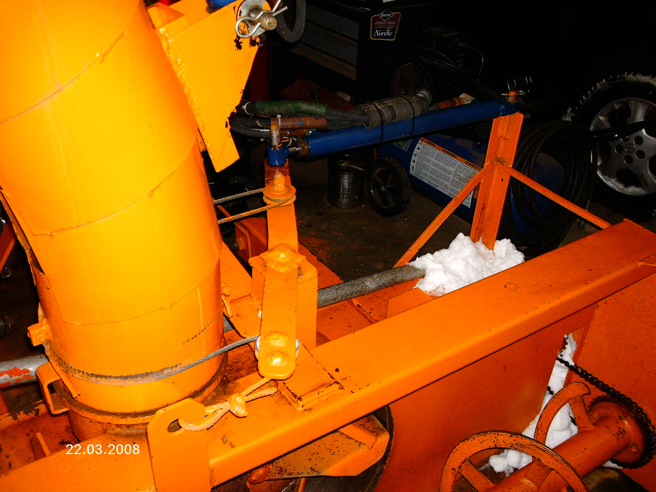

Not sure how to start new subject. but...I have a BerVac snowblower. The chute turns via a cable pulley system powered by a piston. One pulley broke-I have replaced the pulley but have no idea how to 'rethread the cable system so it will turn the chute. Any help would be appreciated.
