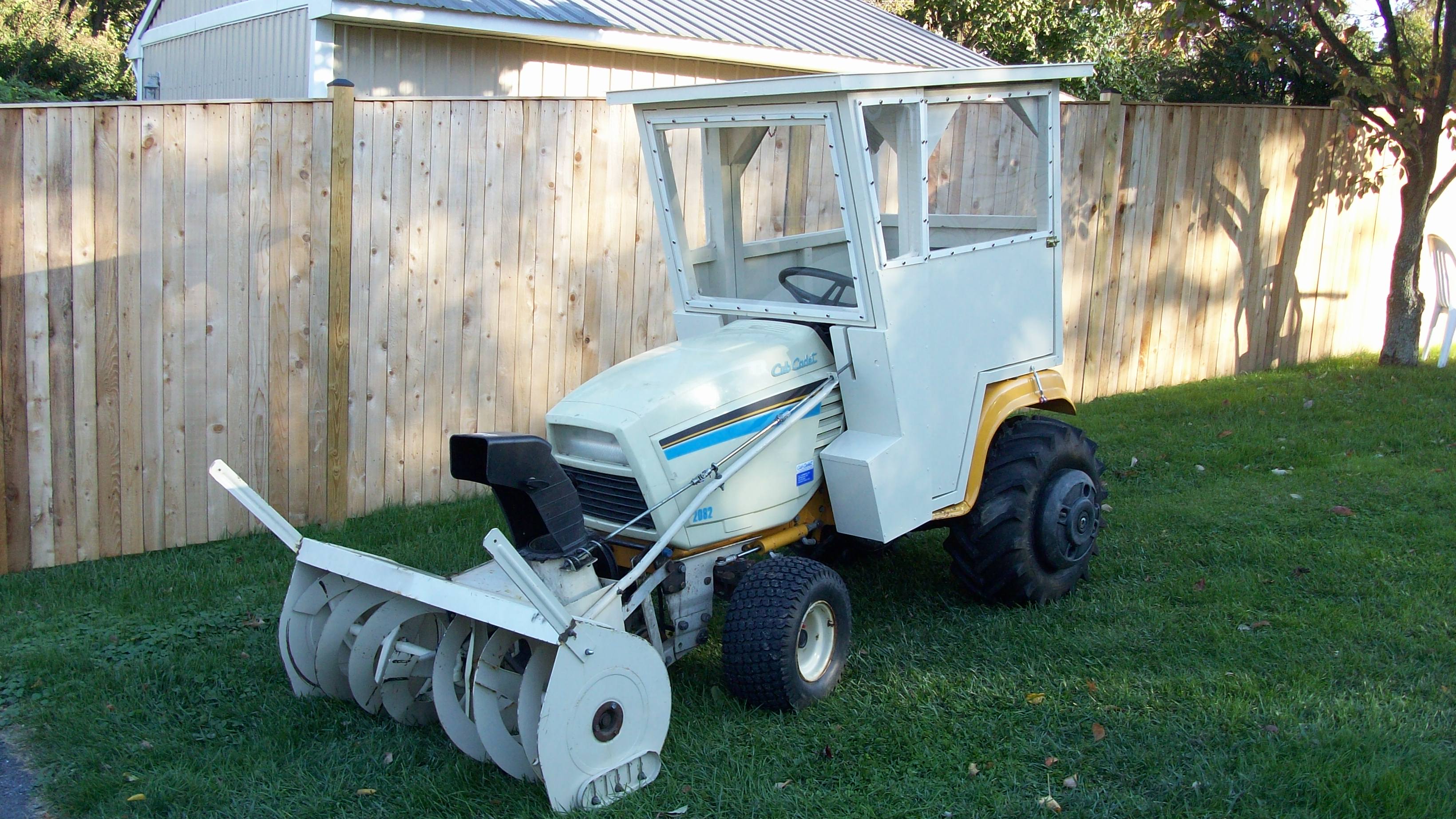

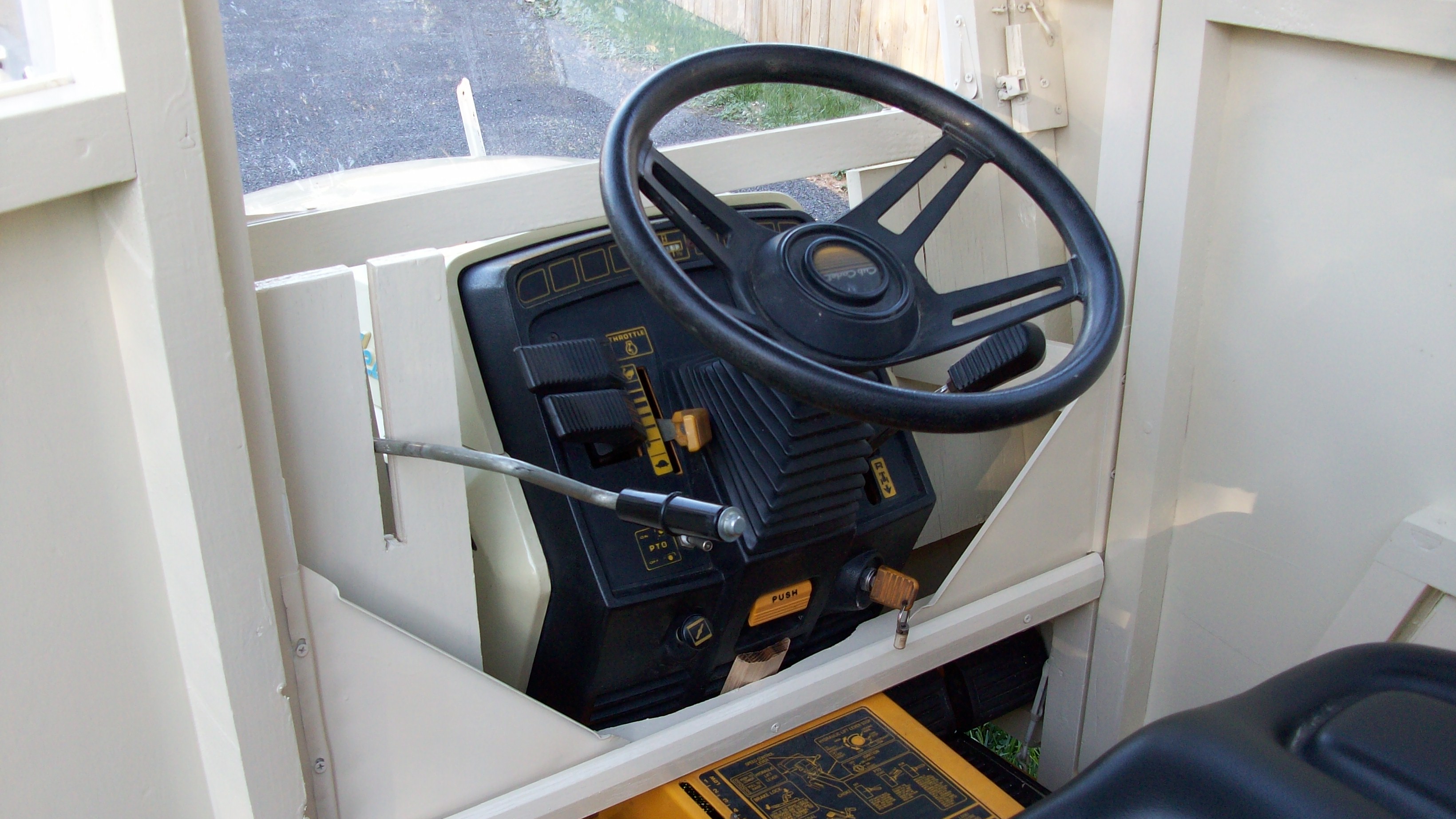

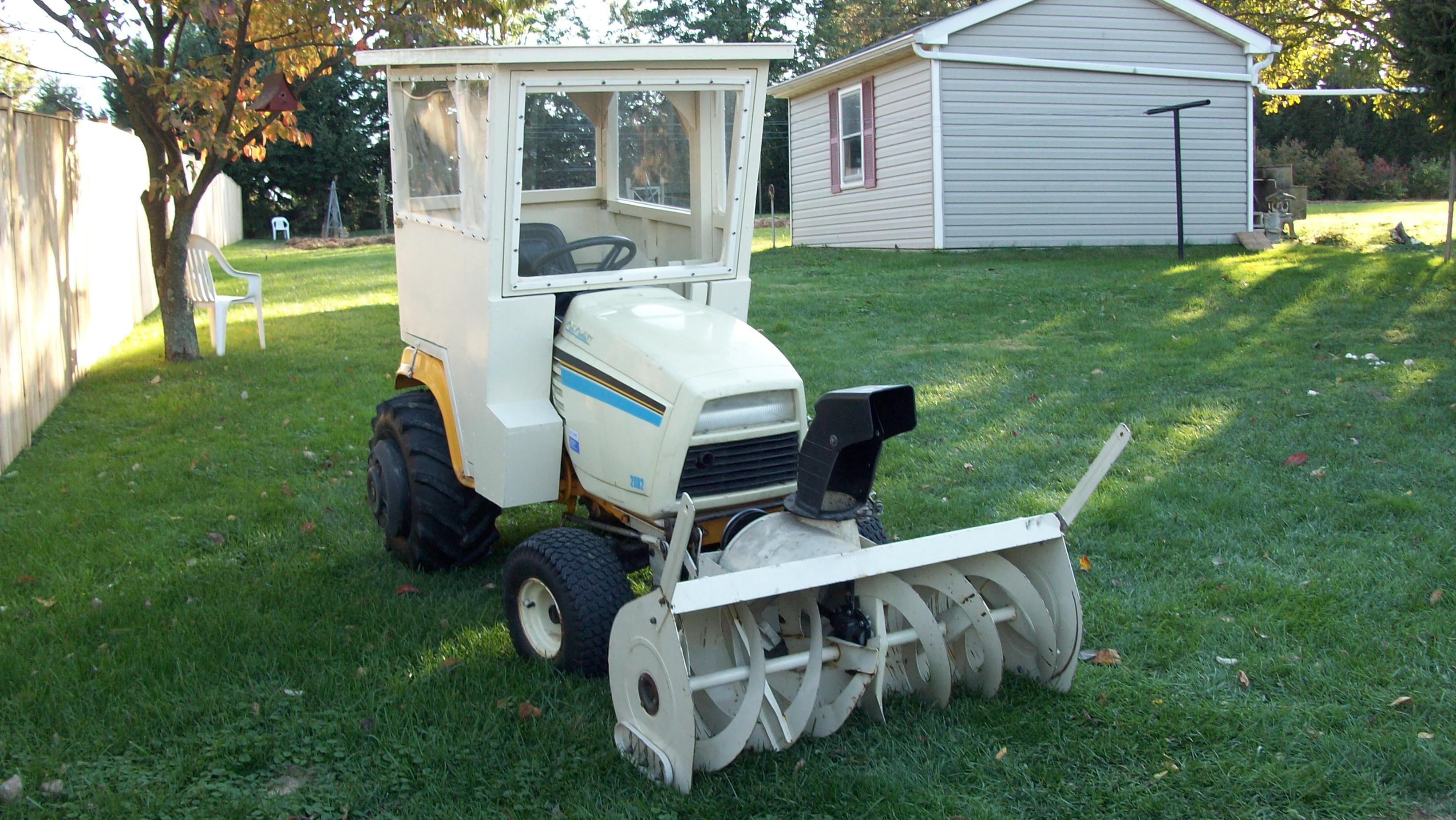

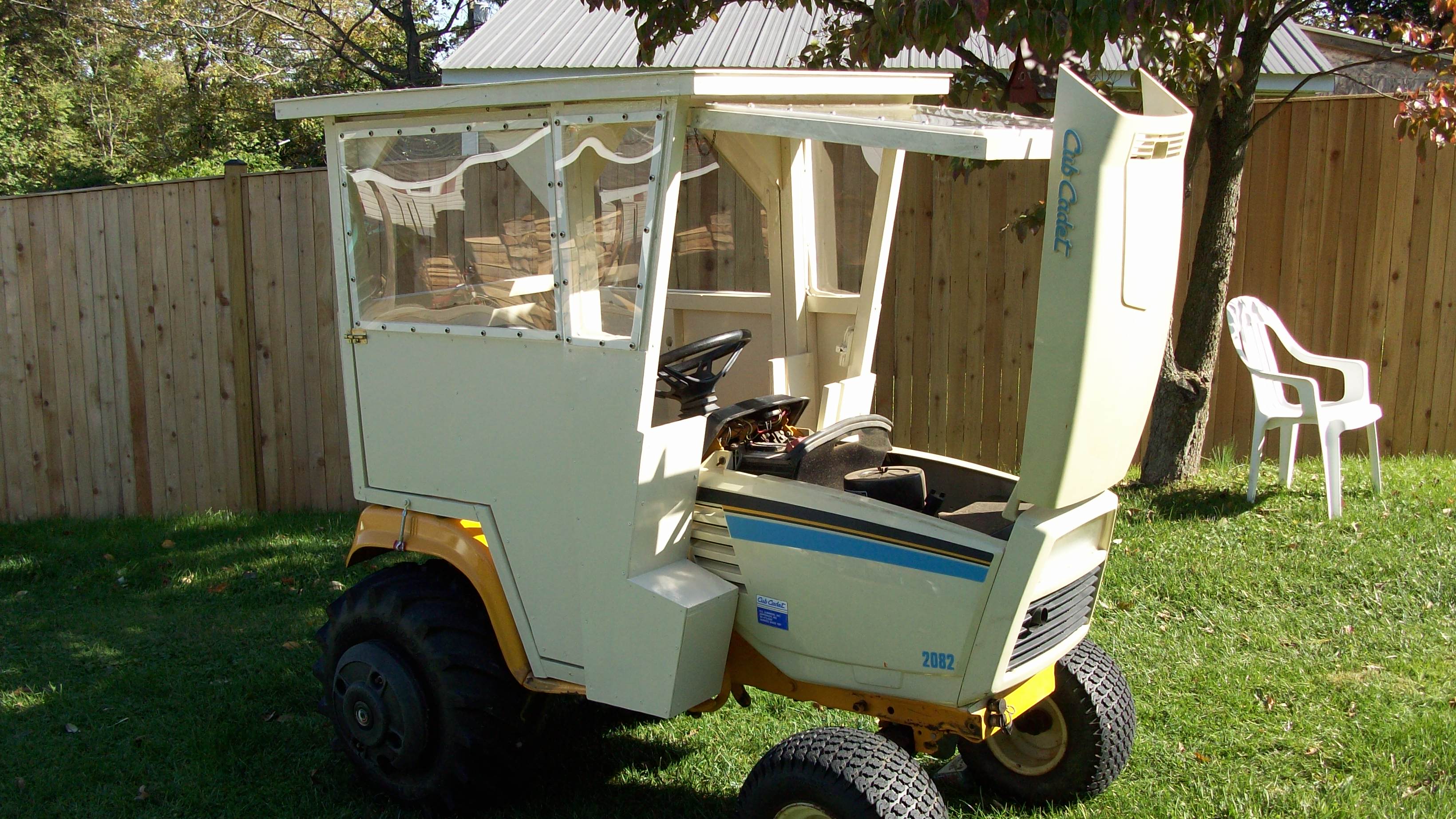

Hi everyone, I live in Frederick MD. I own a 1992 Cub Cadet 2082 which I bought new that year. The past few weeks I have been working on a snow cab for it. See photos. I thind it turned out great. I have a plow and snow blower for it so today I also mounted the snow blower. Take notice i hinged the windshield so I can get the hood up if needed. Any question on the details how I made it feel free to email me. Thanks for taking the time to read my post.

I had 60 year old full 2 x 8 inch boards i ripped into 2x2,s 1/4 inch plywood for skin and plexiglass. I made one years ago for a 1250 I had and it held up forever.

OK I have to ask. In the last pic you can see the latch for the door on the outside:confused: How do you latch it once you are inside?

I tried to find some wiper assemblies but got no where. I vae seen some that have a single arem and blade and would mount on the top. Just dont think I have the right phrase on my search.. Got me interested now..

Need a wiper assembly? Look no further than your local junkyard. Get a rear wiper off of a Subaru wagon or hatchback. Cheap. :D

I have the same latches on the inside, have to remember to unlatch outside ones on both sides before I get in. I left plenty of air space around all the doors botton of cab,and above the windshield so air will circulate. I did that on my old cab years ago I made and had no steaming, I use several of the microwave cushions you heat up to sit on and one down the front of my jacket, keeps me nice and warm. Plus a coffee holder for my hot drink? Did not try to make air tight just keep the cold winds and moisture off me. At 56 I am getting soft Thanks for all the comments.

Search for boat wipers, there are many types and with mounting sleeve that has treads long enough for your frame.

What are you holding it onto the tractor with? It kind of looks like a turnbuckle, but I can't tell for sure.

He Jimmer, my son lives in hagerstown, I used turnbuckles, on each rear fender and one behind the brake pedals attached to the front of the floorboards on each side. I shake the cab and the entire tractor shakes, very solid, yes I am looking foward to trying it out. I ordered
