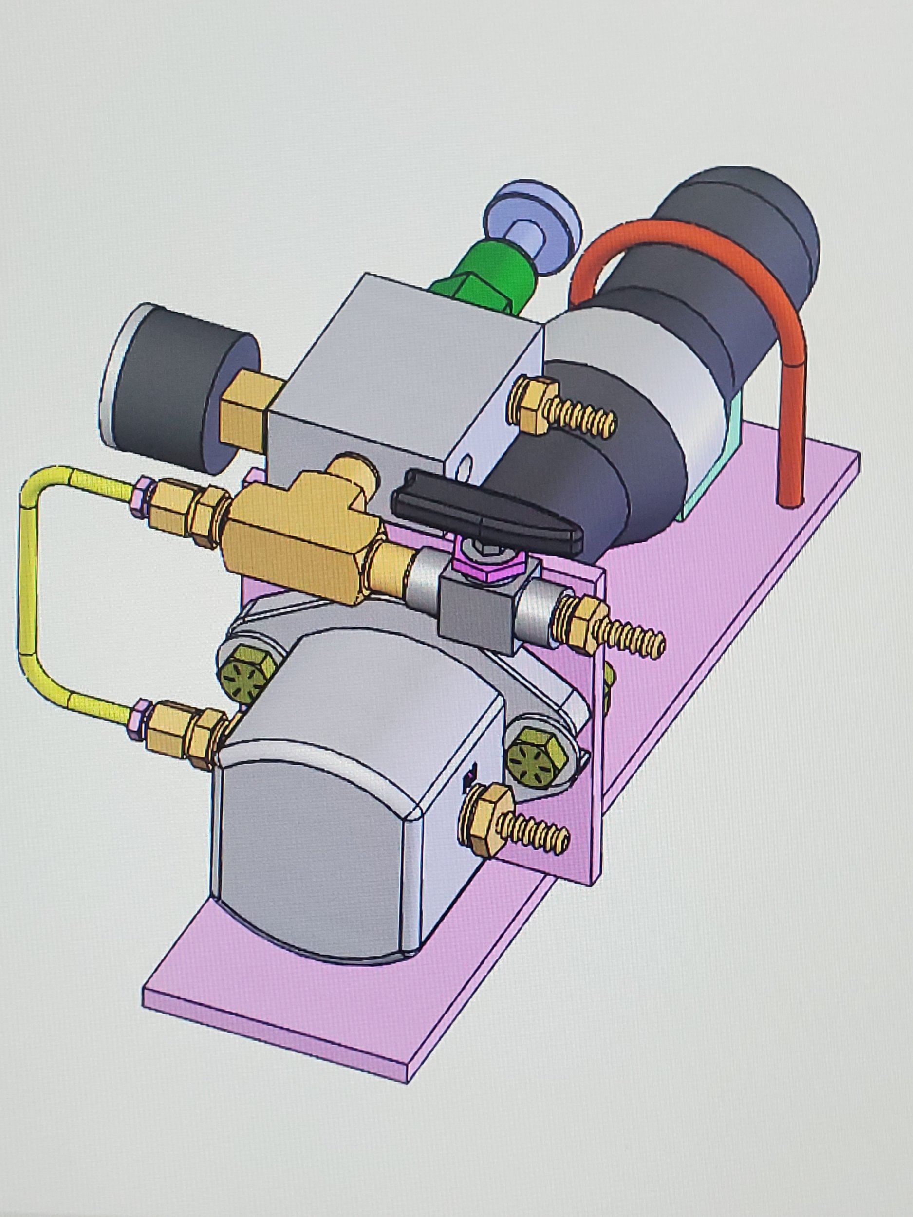

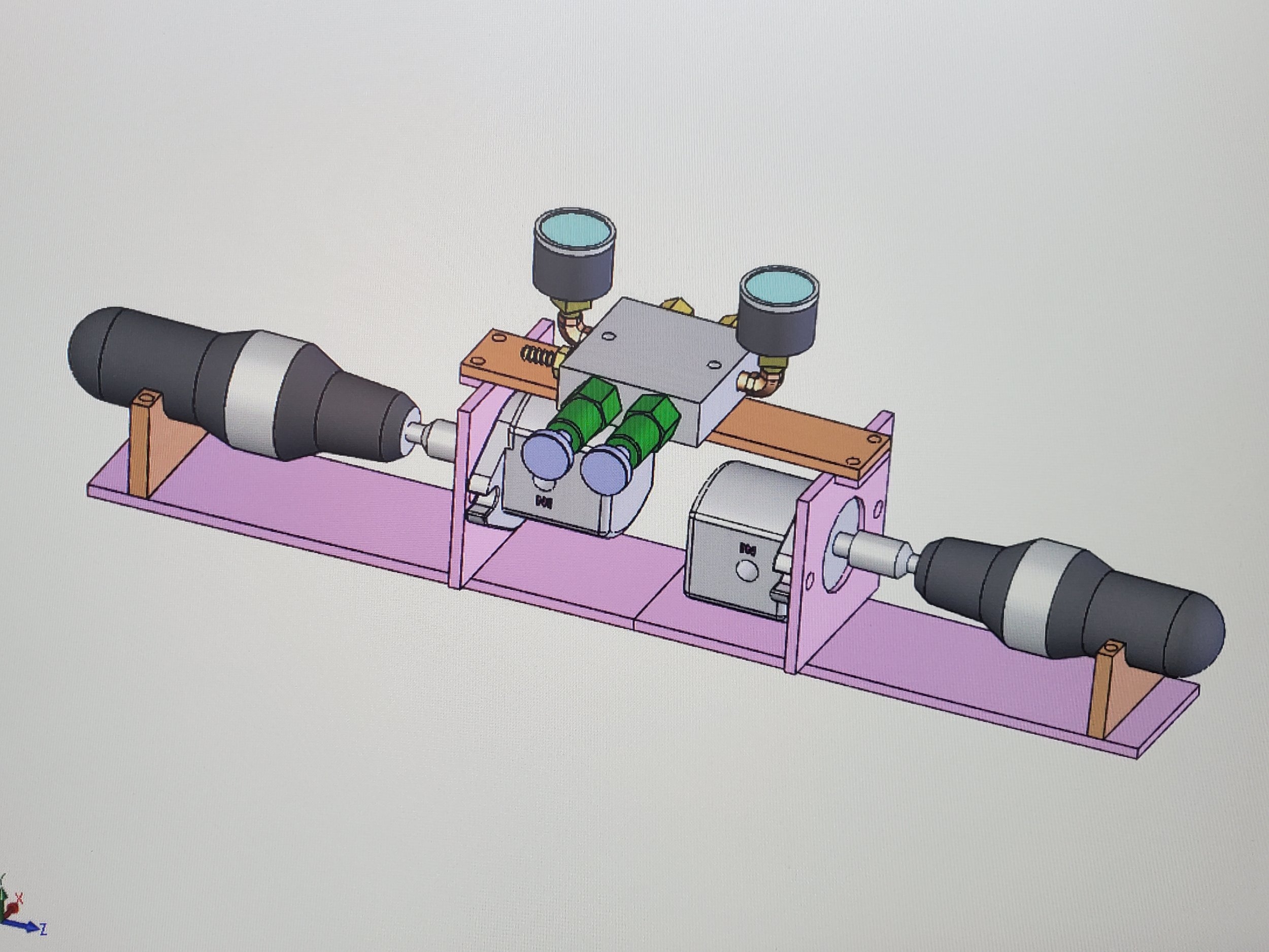

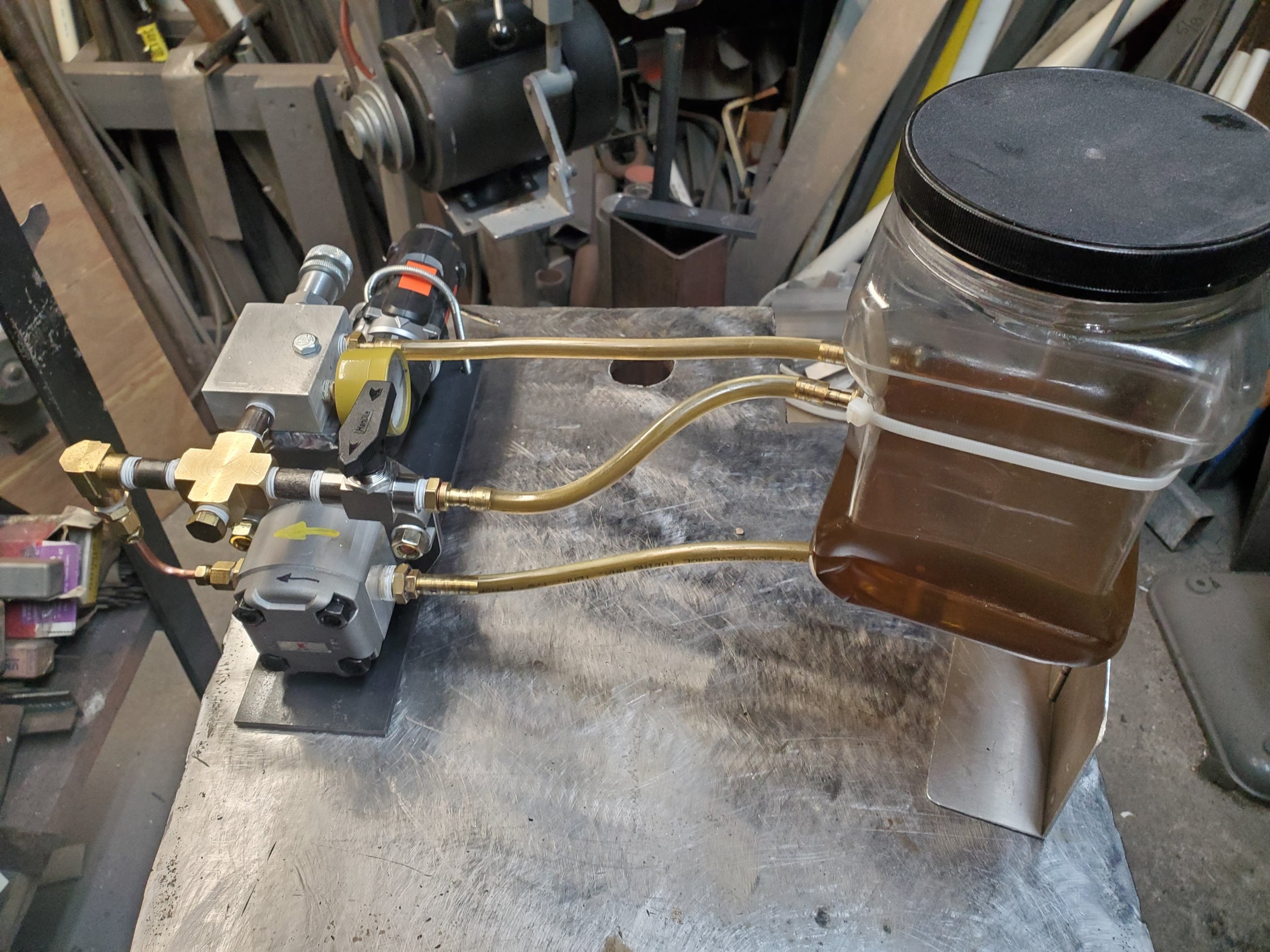

I've been playing around with designing an electro-hydraulic pressure control system for the brake steering. Instead of using a master cylinder for each rotor, I thought a small hydraulic pump could be used to increase the net pressure at the calipers. I set up a small test system (yes, that is a HF 12v drill motor) a while back and was able to see 3600 psi on my 4000# pressure gauge (see first photo). When I checked into the availability of another pump kit, I found they were no longer available. I bought another small pump and will be testing it out soon once I plumb it up (2nd image). The third image shows what a dual pump setup may look like. I envision using a roller chain setup connected to each steering arm to rotate a ball valve to control the pressure. Will it work?

I ran the test hydraulic setup today and got over 3600 psi out of it. The poor little HF drill motor was not happy at all and was very noisy. I may buy a used 12v Dewalt drill and try it instead as I'll bet it has a bit more power and would last longer.

You might want to check to see how much pressure the brake calipers will take. I don't think that they are design for such high pressure.
You may be right and plan B would be to use lower pressure of say 2000 psi and use the two service calipers for additional steering friction. The service brake would then move to a new rotor and caliper mounted to the input of the front diff. I looked at calipers used on Audis and VWs that incorporate a manual parking brake lever which may be a useful feature. I think I covered this in an earlier post.
