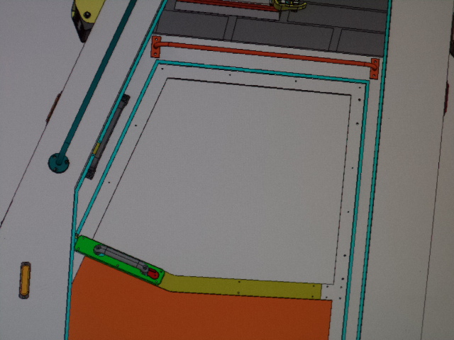

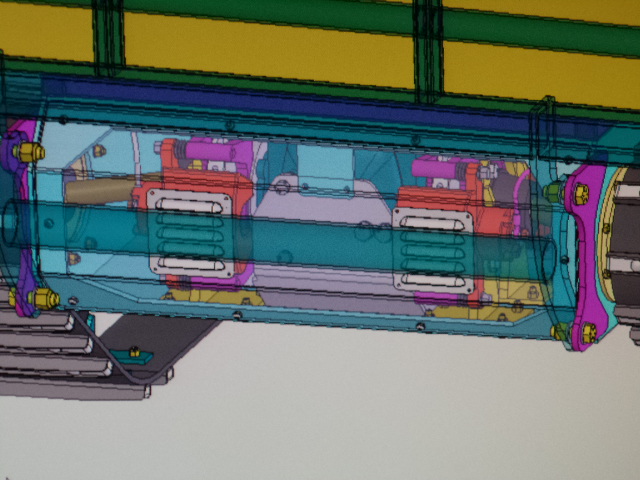

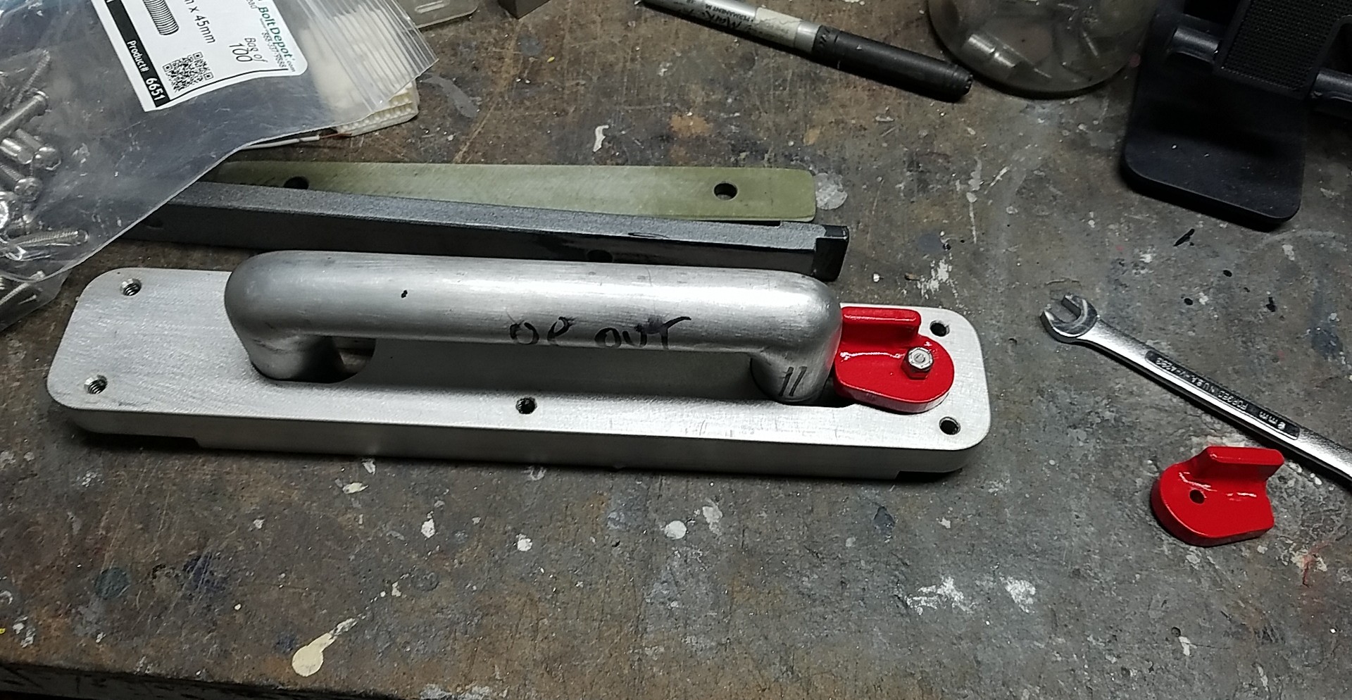

It has been a bit quiet around here but I did take the wife for a joy ride around the yard a few days ago. A couple of items needed to be addressed from the test run: a) there was a distinct aroma of overheated brake pads, b) My wife grabbed the door handle and opened the passenger door slightly while underway, c) excessive noisy chugging sounds were heard when I pulled it to a stop for the night. To address (a), I ordered a 5" x 9" SST louvered vent panel which I cut in half and, after cutting some 3" x 3.5" openings in the front access panel behind the bumper, riveted them into place. Originally, there was no air circulation around the steering brakes so these vents will now allow outside air to be sucked in right past the rotors. To address (b), I made up some simple stops and mounted them to the door latch assembly. As seen in the photo below, they can be rotated around to secure the sliding door handle to keep it from opening the door. I will also add a "monkey bar" above the door opening which will allow my passenger to hold onto something for stability. I traced the noise in (c) to one of the tracks that had ridden up onto the guide teeth on the rear idler spool. The teeth have a flat spot on top onto which the track bars were resting instead of on the spool's curved surface. I assume while making a turn I stretched a track belts a bit and it landed on top of the teeth. After loosening the track tensioner, I repositioned the track bars properly and retensioned the track. If it happens again, I will make another set of guide teeth with pointed tops thus fixing this issue. Until next time, stay healthy!
