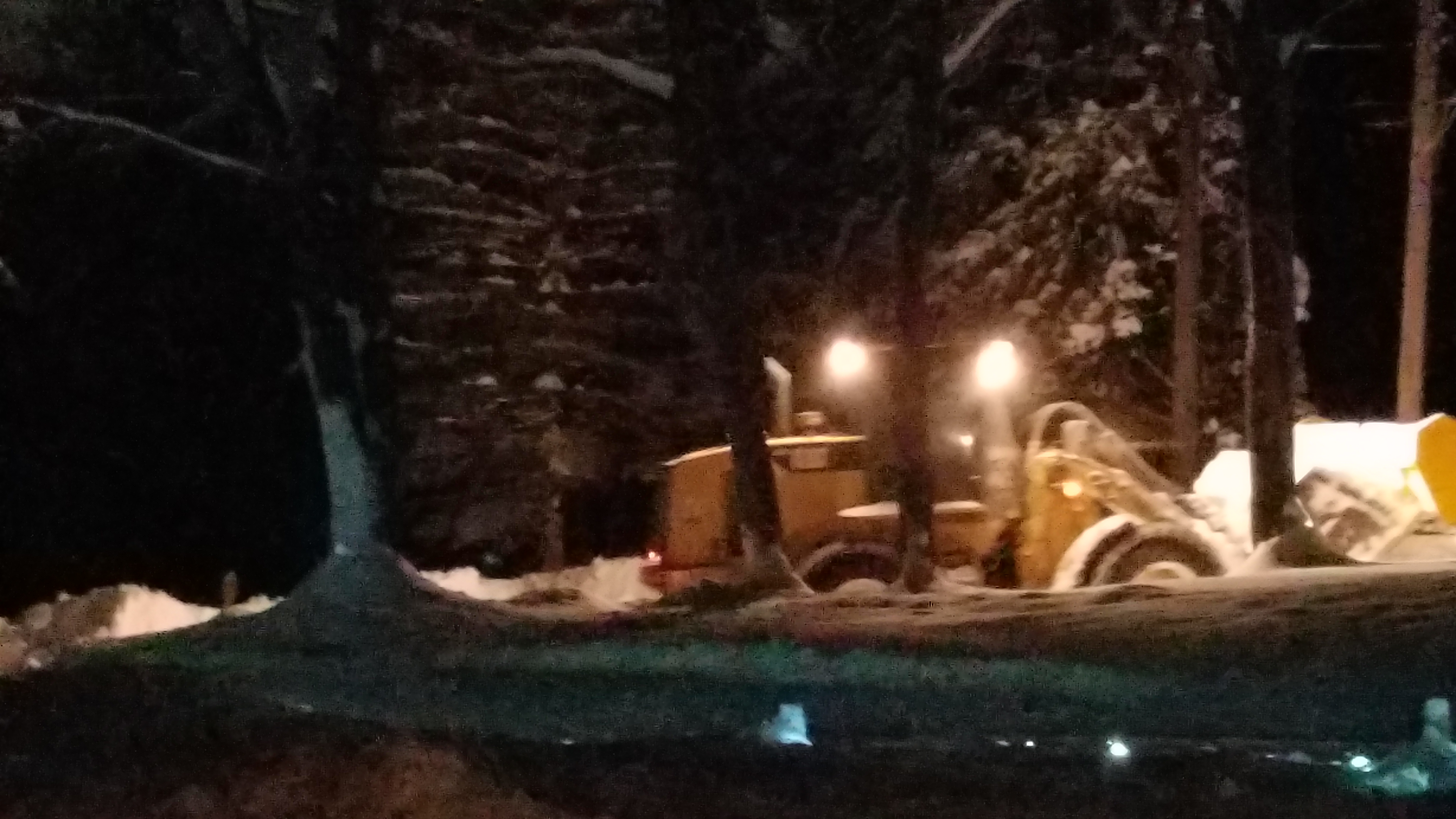

They plowed our road out yesterday with a front-end loader.

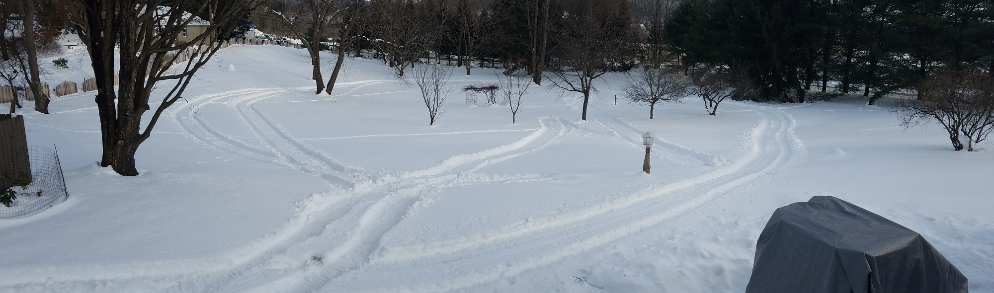

#448
Fresh Snowzer tracks. It definitely turns easier in the snow. :thumbsup:
   / My Senior design project - a "Swamp Thing" tracked vehicle clone #449
I found the same thing with 4 pods on atv's and utv's. Snow is your friend for steering. :)
