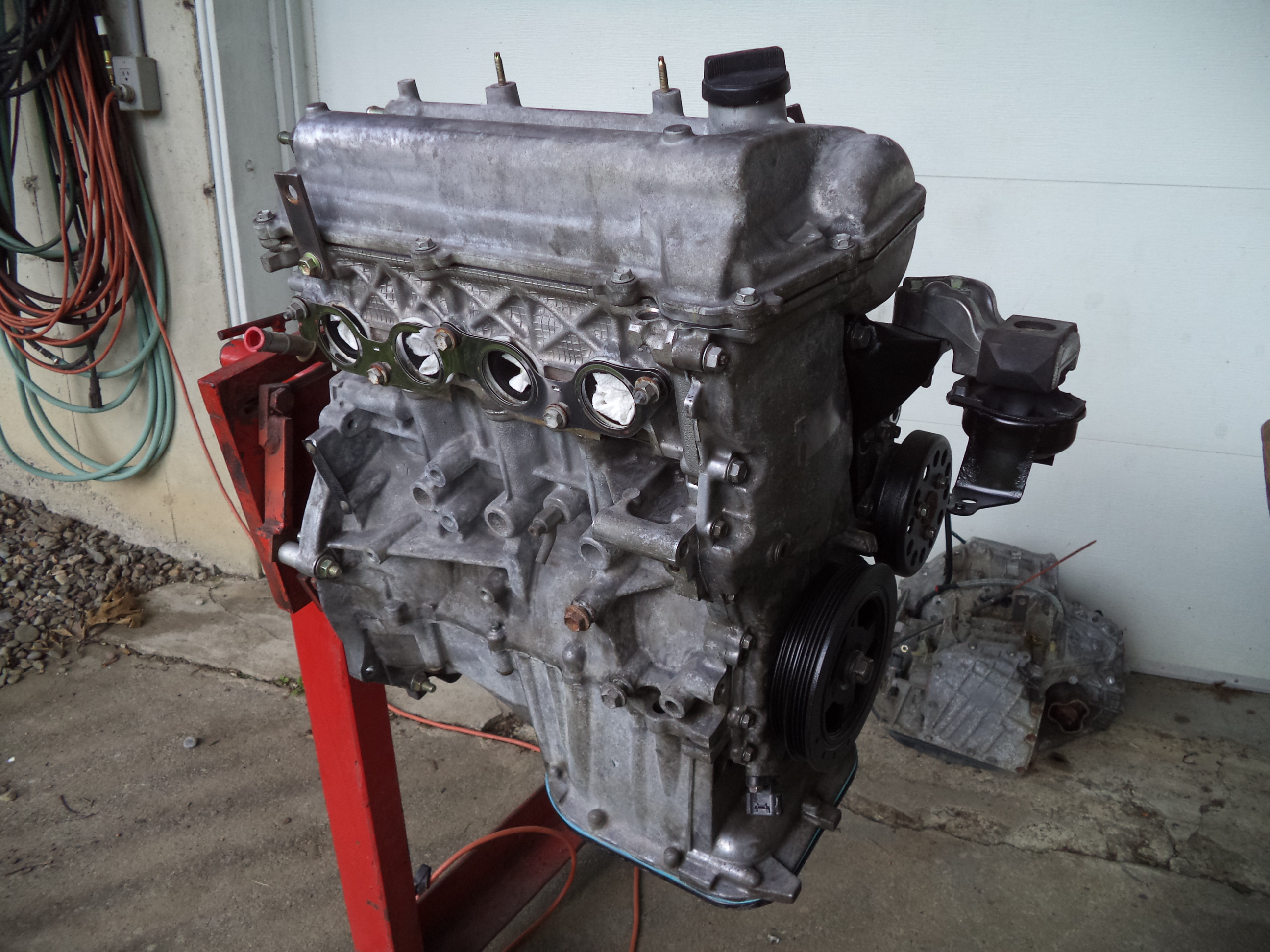

Status update: over the last couple weeks, I have refined some of my part models on the computer and have also been working on the Toyota Echo engine. The 1.5L engine came from a car that was flipped upside down after the driver lost control on an icy road. Luckily, the driver was not hurt. The wrecker driver tried to start it but to no avail. Over a year later when I went to see/buy it, it ran but had a fairly loud tink noise. Long story short, it has a pair of bent connecting rods that need to be replaced. I pulled the cams today and will, hopefully, get the head and lower housing off tomorrow so I can get access to the conn rod bolt nuts. Once I get it back together, I plan to mock up a full sized cabin from 2x3s and cheap paneling. I ordered some conveyor belting for the tracks and bid out the steel sheet I will use for the tub (or frame, if you will).
When the driver tried it after being flipped it probably had oil leak by causing it to hydraulically lock, bending the rods.

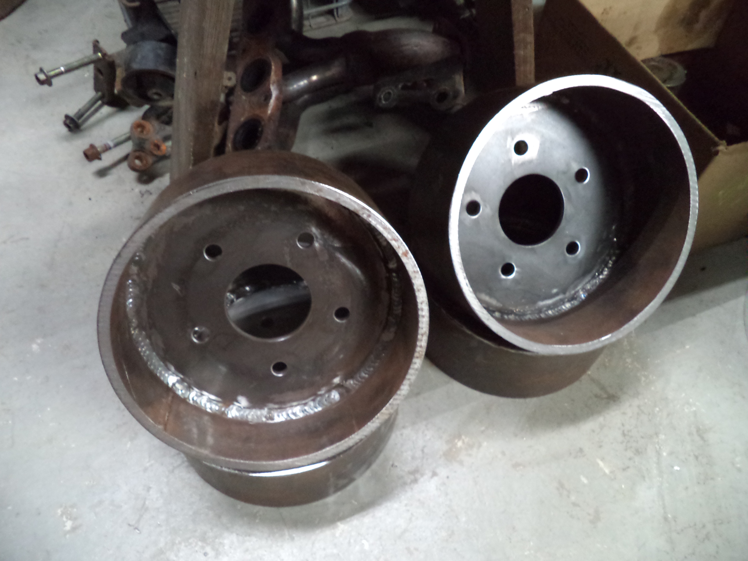

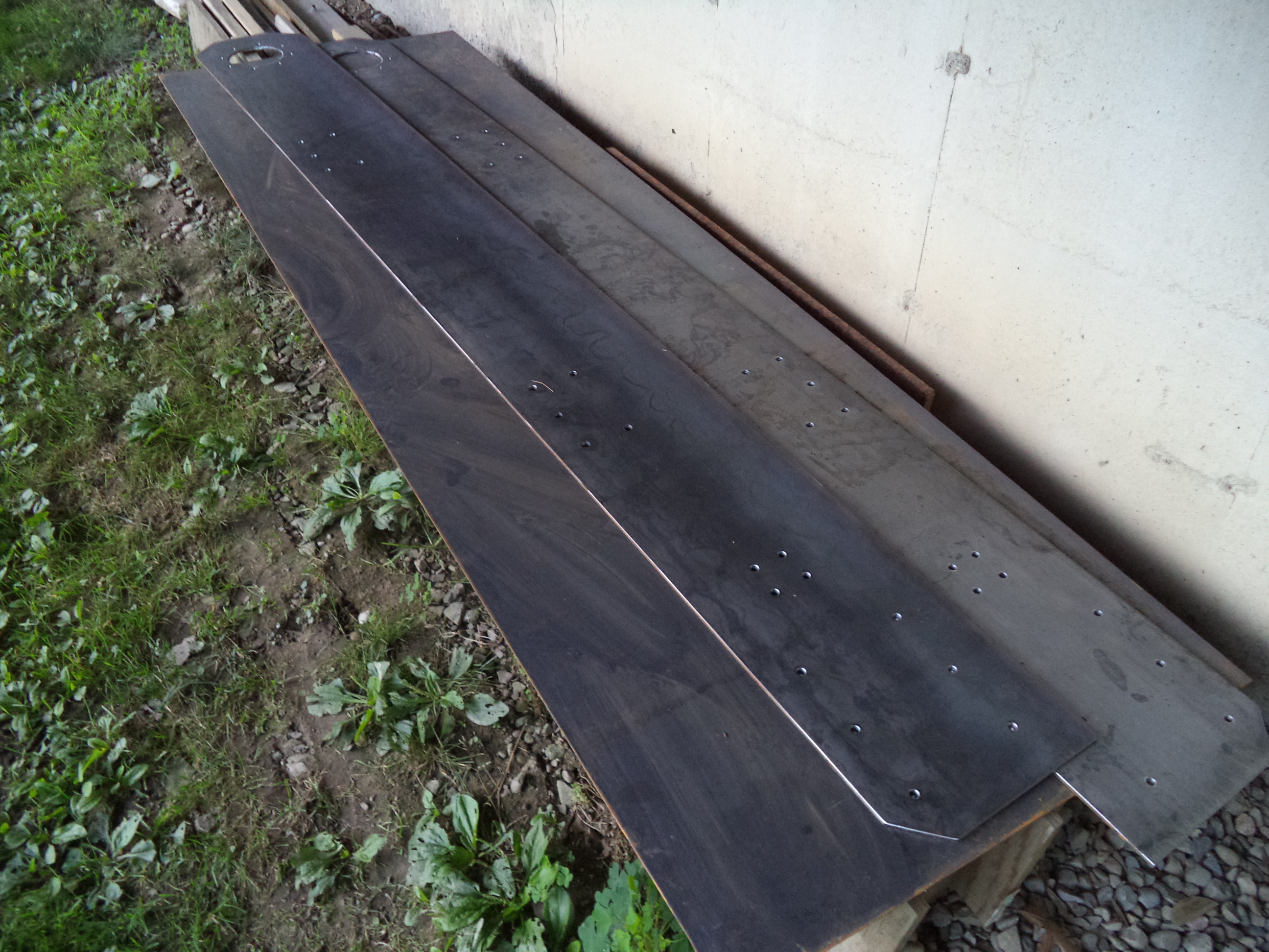

Yes, there was oil in the intake manifold so hydrolock probably occurred. The Echo engine is now back together with straight rods and new gaskets. No other damage was noted. I finished making up the two idler wheels and two sprocket wheels, all made from 8" sch 40 pipe. I also have the tub sides drilled out for the various undercarriage attachments. I hope to weld up the tub in the next couple of days and then I can put the wheels on it.

Yup, I got to follow the rules. Here's some images of the reassembled Echo engine, the idler & drive wheels, and the drilled tub side rails. I still need to drill the perimeter holes on the drive wheels for the sprocket teeth.
