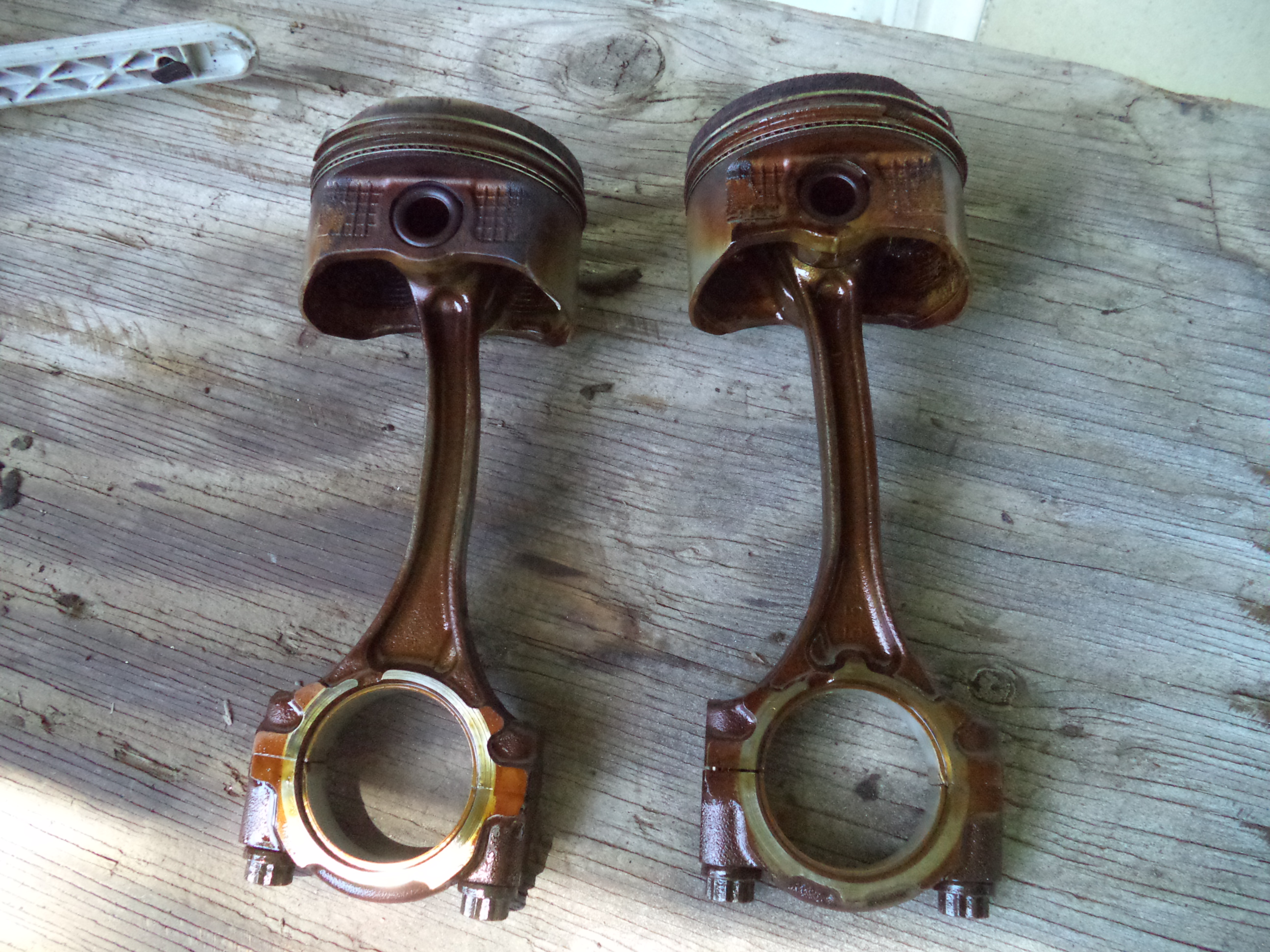

Status update: over the last couple weeks, I have refined some of my part models on the computer and have also been working on the Toyota Echo engine. The 1.5L engine came from a car that was flipped upside down after the driver lost control on an icy road. Luckily, the driver was not hurt. The wrecker driver tried to start it but to no avail. Over a year later when I went to see/buy it, it ran but had a fairly loud tink noise. Long story short, it has a pair of bent connecting rods that need to be replaced. I pulled the cams today and will, hopefully, get the head and lower housing off tomorrow so I can get access to the conn rod bolt nuts. Once I get it back together, I plan to mock up a full sized cabin from 2x3s and cheap paneling. I ordered some conveyor belting for the tracks and bid out the steel sheet I will use for the tub (or frame, if you will).

I suspect that it isn't just con rods.

Today I finally got around to splitting off the lower oil cover from the Echo block to gain access to the conn rod ends. As suspected, I had a couple of noodly rods:
I found a couple of used rods on Ebay which I ordered along with a new gasket set, head bolts and a rubber Chevy auto transmission mounting block that will be repurposed as a front engine mount. The pistons, bores and crank in the Echo engine all looked fine so there are no plans to futz with them unless I have an issue with installing the replacement rods. I also ordered 316 lb of steel sheet for the frame or what I call the tub. Next up is to order some trailer wheels to run on the tracks. I'll be able to roll the body around once those are mounted. I previously ordered some 5/16" 2-ply conveyor belt that will need to be cut into 5" wide strips for the 14" tracks - that should be here soon too. Stay tuned...
