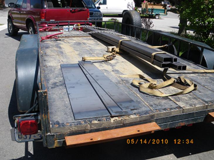

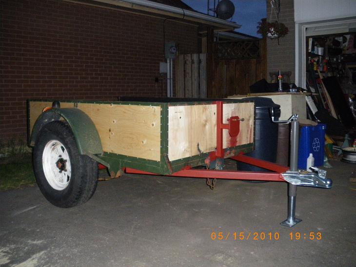

Well I now have 700 bucks into this thing and have not yet started. I decided it was more urgent to rebuilt a trailer I built about 10 years ago. I put a new tongue and tire carrier on it, as well as all new plywood, flipped the axle so it hugs the ground. Previously it was an off-road trailer. I run P235x75R 15 on the trailer to match my SUV. Gonna paint it red to sort of match the Blazer. Anyway thats what I worked on so I only have a picture of what $400 in steel tubing and plate looks like. The tubing is 3/16 wall 2x2 and 2x4, plus quarter inch plate. Will try next weekend to put a day in on the build. Thanks for the info about HP needed. Will have to watch for sales on motors and will try for 20 horse. Local store had a 17.5 hp with 9 amp charging system but it was vertical shaft and I think I will go horizontal. The pump puts out 10 GPM x2500 PSI at 1000 RPM so I will need to gear down 3 to 1. Likely to go double belt pully system.

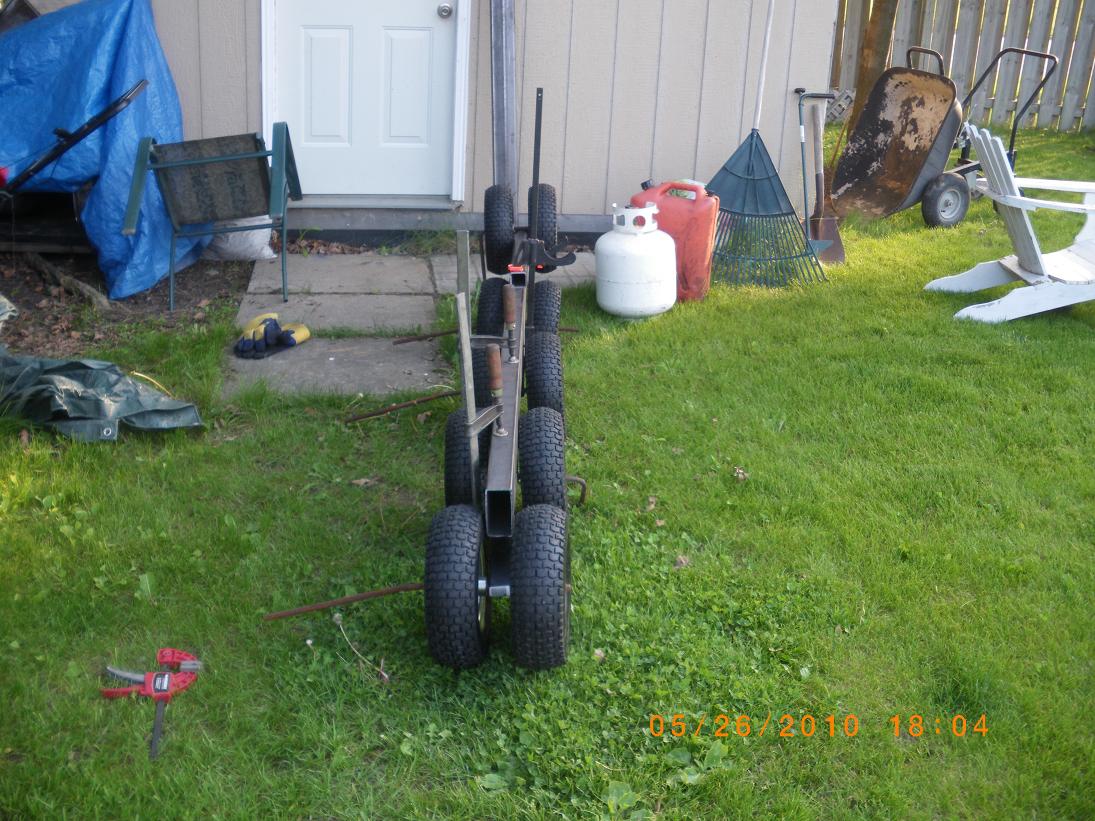

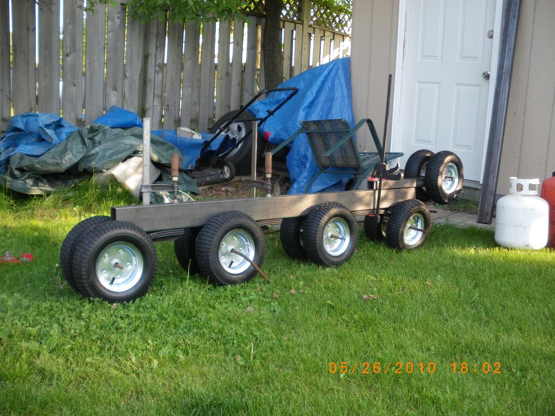

I cut some steel today and mocked up a track frame. The front wheel will be sprung to tension the track. I am looking at a Snowplow spring hooked up to a turnbuckle. its looking like its going to be quite large though I am going to try and keep it to 8 feet long by 4 feet wide, not including a front blade. In that space I need to mount a front seat, motor, tank and pump tray, then a dump bed.

Looking good. I assume that the picture is of one side of the eventual vehicle.

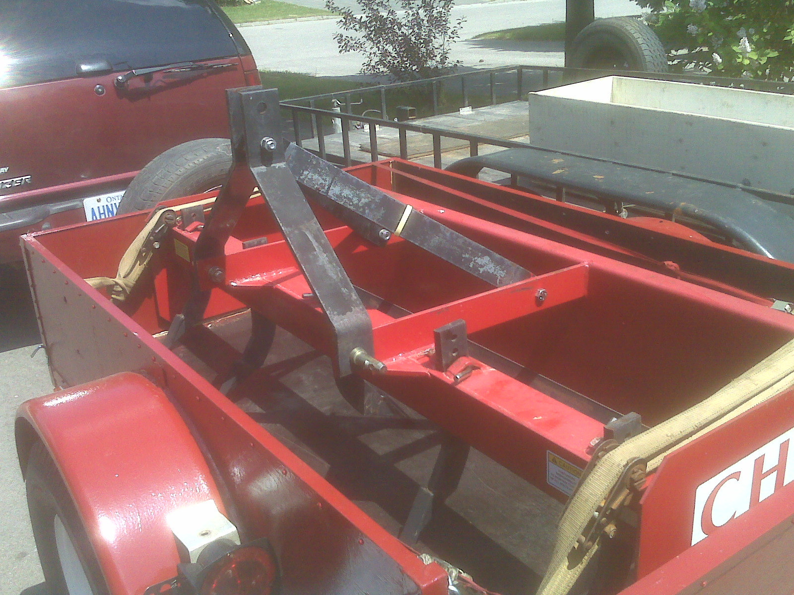

Ya I just mocked up one track. I am looking at a 17.5 HP motor. its a vertical shaft so will be interesting setting up a double pully system, but this motor has a 9 amp starter generator so I will be able to have a couple 35 watt lamps. I bought a 5 gallon Reservoir which I might have to add some heatsinks or a tranny cooler\fan if too much heat is developed. Anyway hoping I can get a good start next weekend. I just brought home a new 6' Box blade today, so eager to go to the camp and try it out tomorrow.

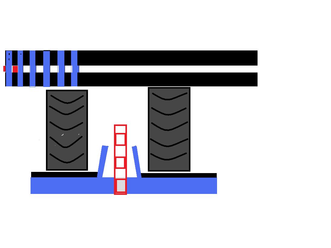

Those excargo tracks look interesting but the combination grousser\ connecting pads look like they would be hard to reproduce. As I have dual tires I would have too much open area with such a design. I think I have decided to go with groussers (device to keep the tracks from falling off) between the tires. This will allow me to weld them to the c-channel connecting pieces. This drawing shows a cross section of my design.
