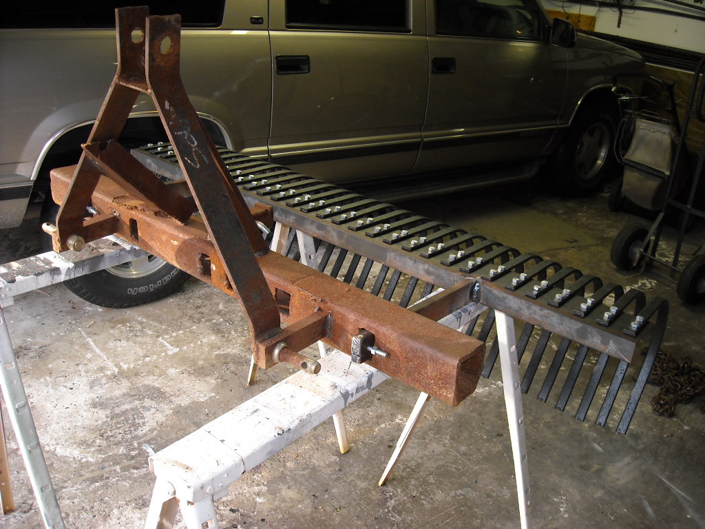

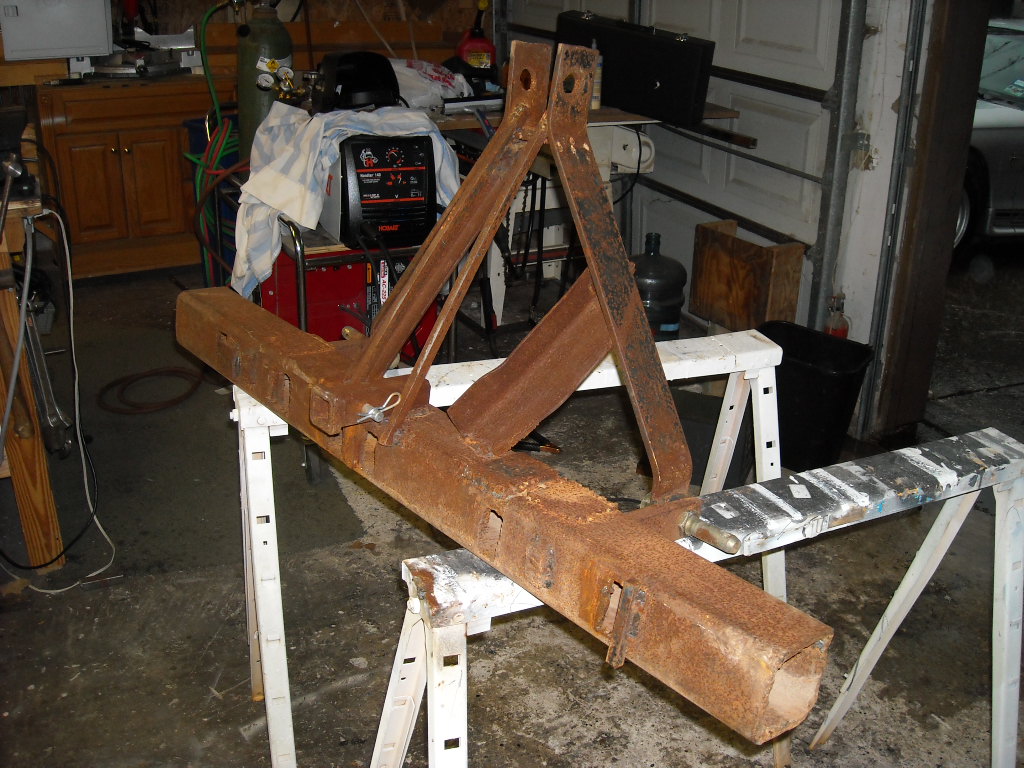

Not having a plasma cutter on a CNC machine, I'm keeping it simple. After building a few, the 3pt connection part of the project is the most PITA. So a while back as some might recall I made sort of a utility tool bar thing out of some 4"x4"x1/4" square tubing I found. I have turning plows that fit in it, middle busters, cultivators, etc, and a class 1 hitch. In hind sight(as always) I should have thought it out a little better. You can see some extra mods to strenghten the 3pt which I pulled off the first time I tried to use it. Yes the attachements are a little loose, but they still work fine. Plus it's hard as heck to cut a straight through hole in 4" square tubing.

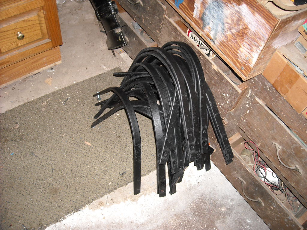

So the project, I bought 30 of the Agri Supply tines, the 2 hole better ones at about $2.98 each. Thought I was going to have a spare or 2 but didn't. I had a 5'3" piece of 5" channel (light stuff, about 5.3# per foot) left over and use it, no cutting!! Basically that's the project, drill 60 holes in the channel, weld on some solid bar to attach to the utility bar, bolt on the tines and away we go.
So the pics, Start off with the utility bar. I think I'm going to "clean" it up a bit while it's in the main garage. Might paint it, but mainly clean up some of the welds and add'ons.
Forgot, here is the pile of tines I got from Agri Supply..

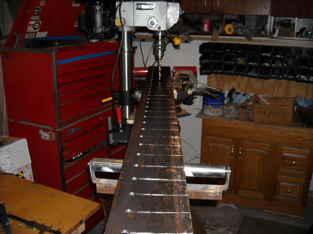

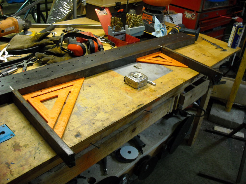

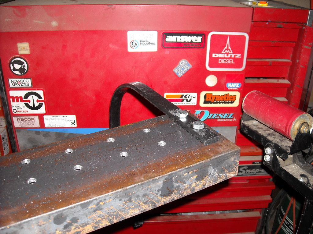

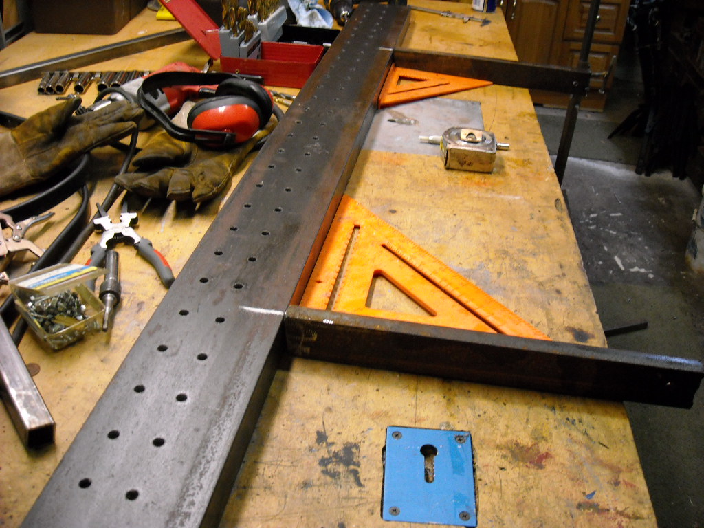

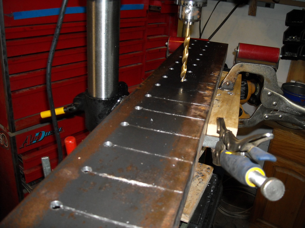

Phase one, the drilling, read a couple threads by Eddie (can't believe he didn't have a drill press), and the latest thread by Larry using a spaced out flat bar and the single hole tines and metal spacers(cool idea BTW). I've had good luck with drilling lately, so I'm drilling holes.

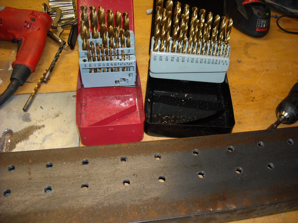

Using my new cheapo HF DP, I clamp on a guide, prop it up on some rollers I made, and slide it from hole to hole. I use WD-40 to keep the bit cool. And I have found these $15 HF drill bit sets to be very good. Just don't burn them up and they will last a long time. First hole was just as easy as the last on an already used 3/8" bit. After the first row I realigned the stop block for the second row of holes. Just used a speed square and soap to mark the location.

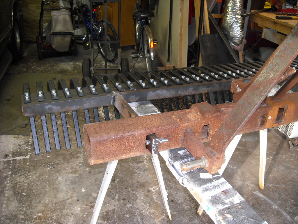

Next the simple process of putting on the arms that attach to the bar. I think these are 3/4"x2", not sure actually. I had this piece about 30" long and cut it in half, perfect fit! ;) I had some heavier stuff but good thing I didn't use it, little to thick for easy install into the tool bar. I drill a simple hole in the end to keep it from sliding out of the tool bar. This is how I keep all the stuff in the bar. I figure with the 3pt down, even with some jiggle it'll still float and stay flat on the ground.

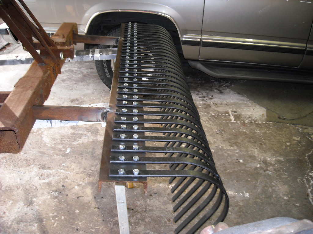

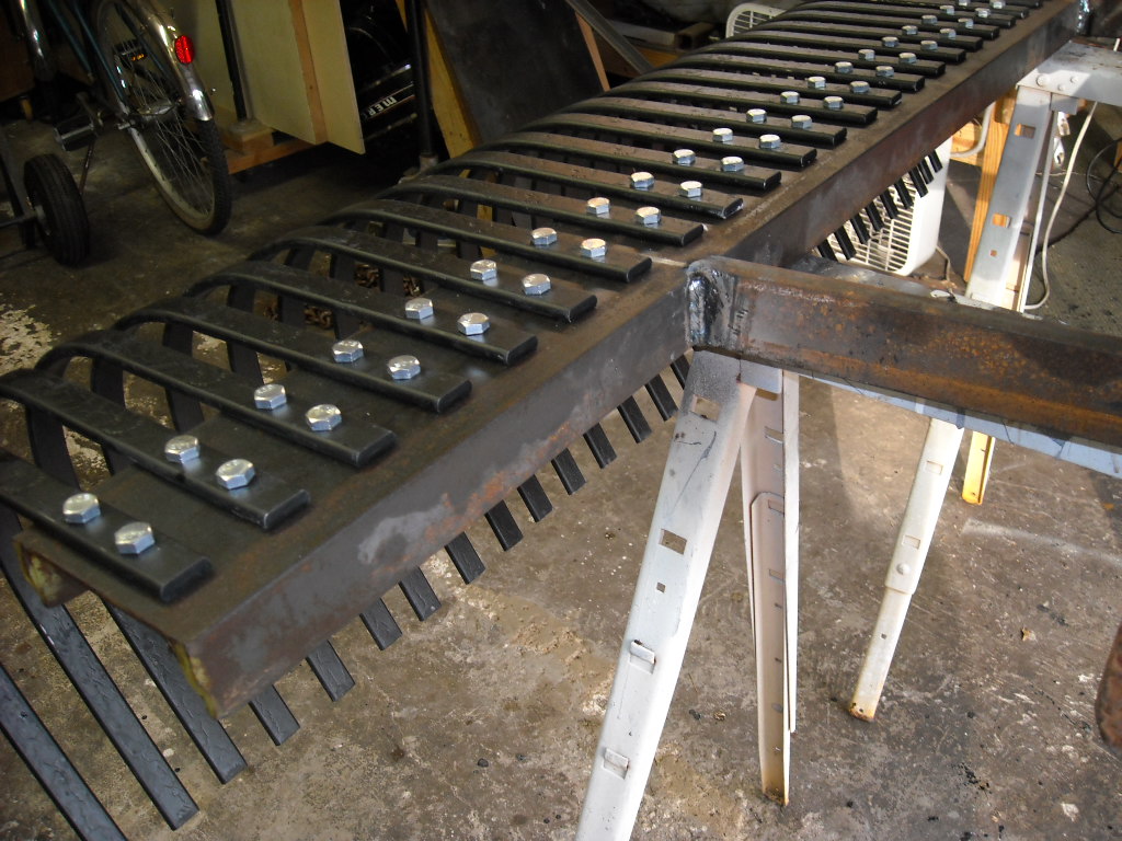

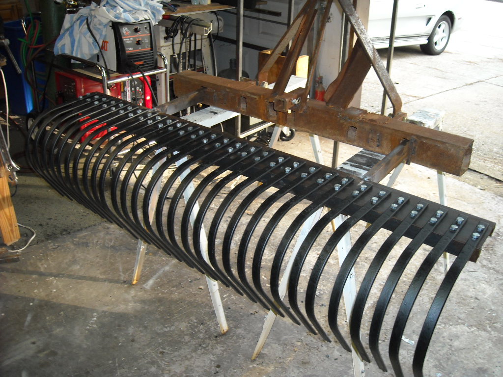

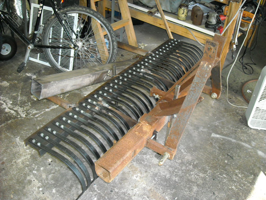

Yesterday I spent a whole hour to finish it...maybe less.
I used my new HH140 to heavy tack the arms on the channel, surprised I got some good penitration with the little 110 unit. Gas is sweet!
But use the Lincoln Ac stick for the main weld. 7014 rod, 125 amps. 2 passes on 3 sides, one side was just 2 darn pretty to go over. :D

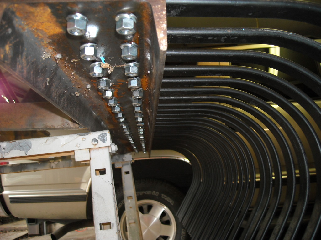

Then is was to put on the new tines. I read how yall went with grade 8 bolts. I thought it out differently. I figure a grade 8 bolt is way stronger than the tine. So what would I rather break, a bolt that I can replace for $.14, or a $3 tine. Yeah I know what you are saying, I scare myself sometimes!! :D

And the last of the pics. Again really simple project. I'm in for about $130 or so. No it doesn't angle, won't windrow, but it'll drag on the ground I bet. I did take a look this morning about being able to make it push while going in reverse. All I need to do is put some arms on the back side and reverse it that way. Not a simple swivel, but might work.
Oh just remembered, I spaced the tines 1.25" apart. I decided to open them up a little more than an inch. In hindsight, I probably should have gone 1.5"
Enjoy the pics, thanks for looking and listening!
