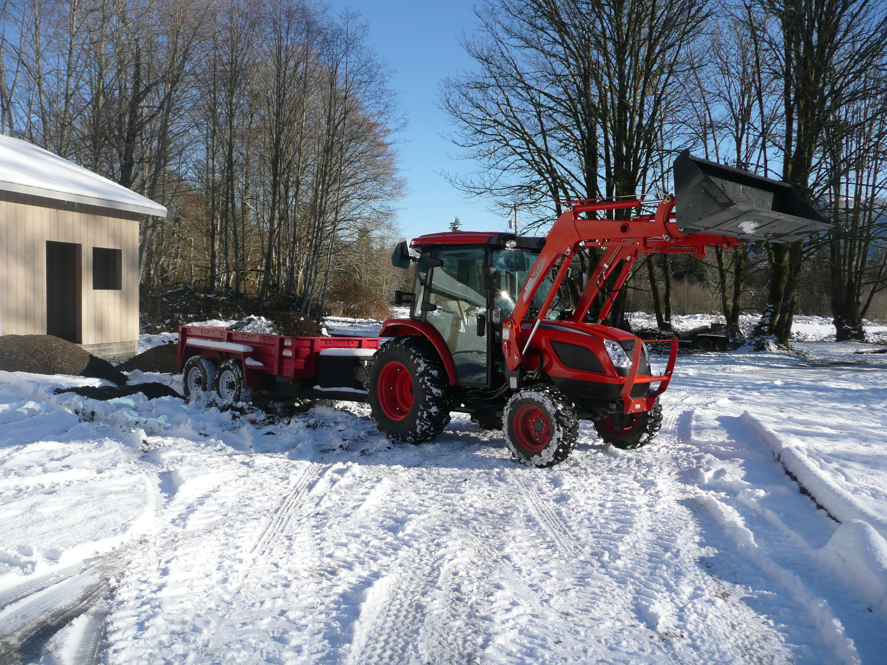

Finally! Tractor time:D
Installed a ball on draw bar. Have run about 5 loads so far. Seems to be working out real well. Only issue so far is that frozen material is sticking to the dump trailer and I have to do a lot of prodding with a shovel to get it out (and the dump trailer has a pretty extreme dump angle!). Now have 13 hours on the tractor!

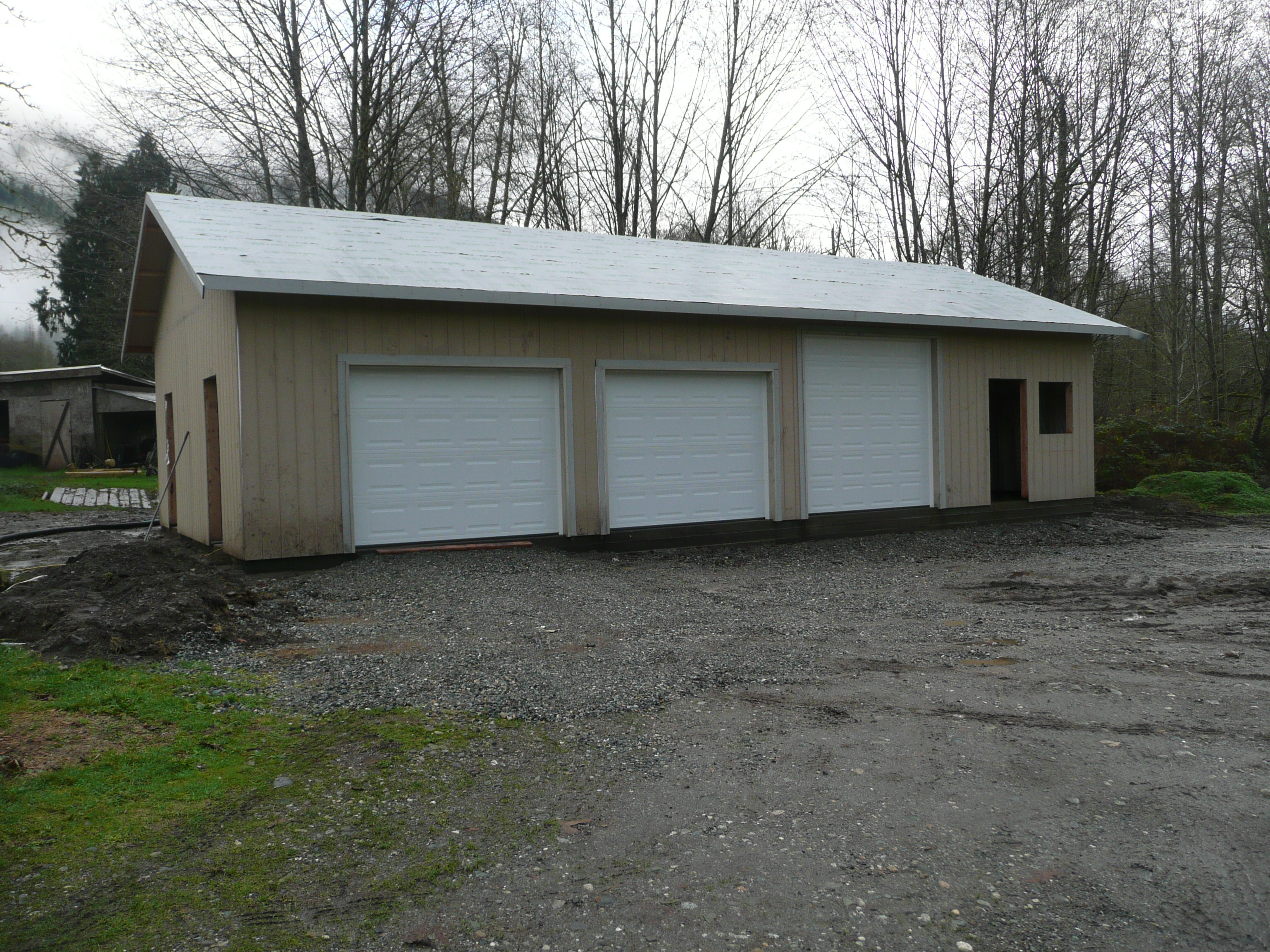

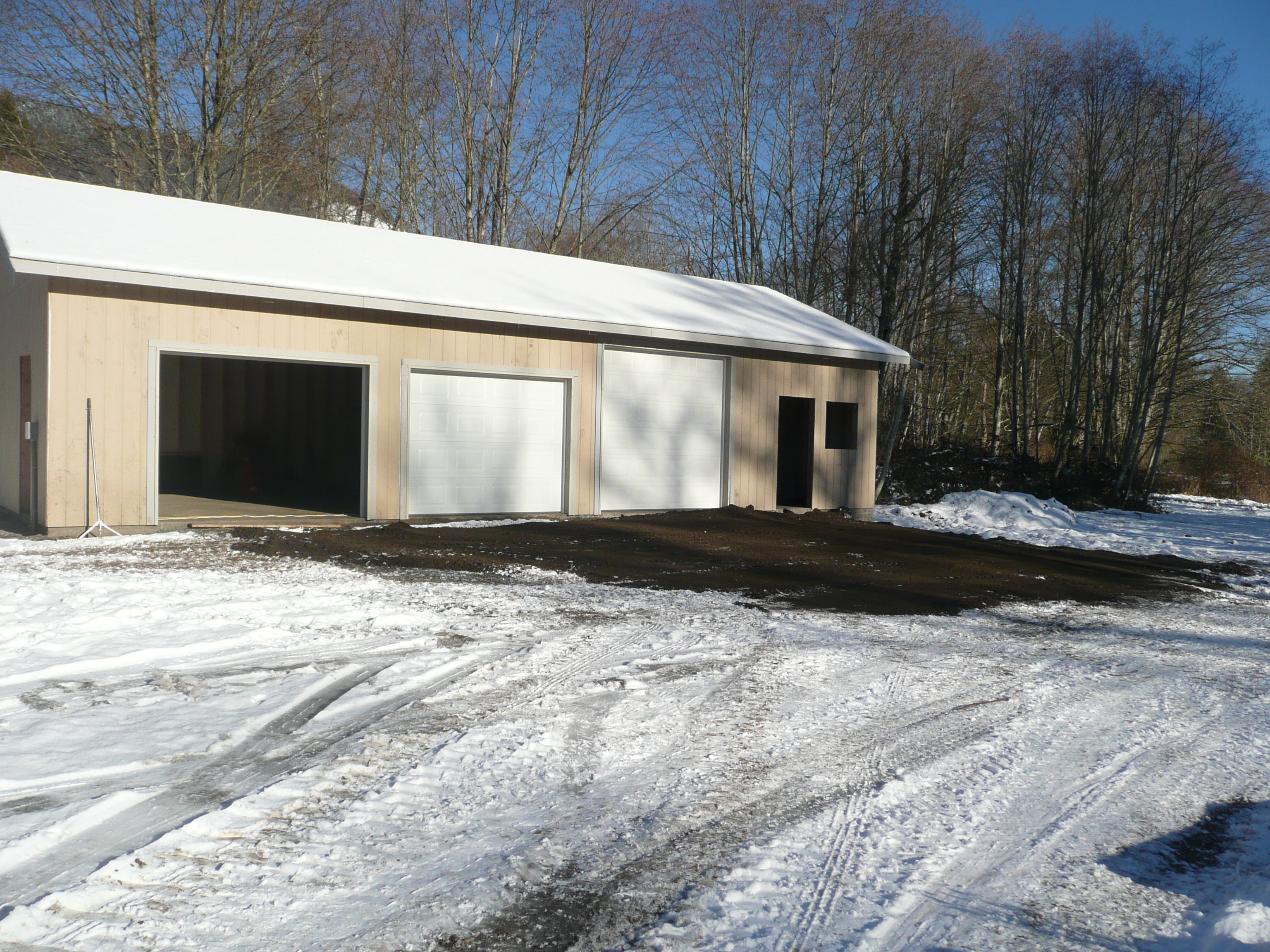

Been getting in several more material runs. Tractor now up just over 25 hrs.
I've hauled and graded 30+ yds of material (not including about 2 yds of leftover 5/8" minus from the site prep) for the garage. Here's what it looked like (with only those couple of yds of 5/8" down in front of the first bay):
Here's how it's shaping up (I will let it settle and pack for now):

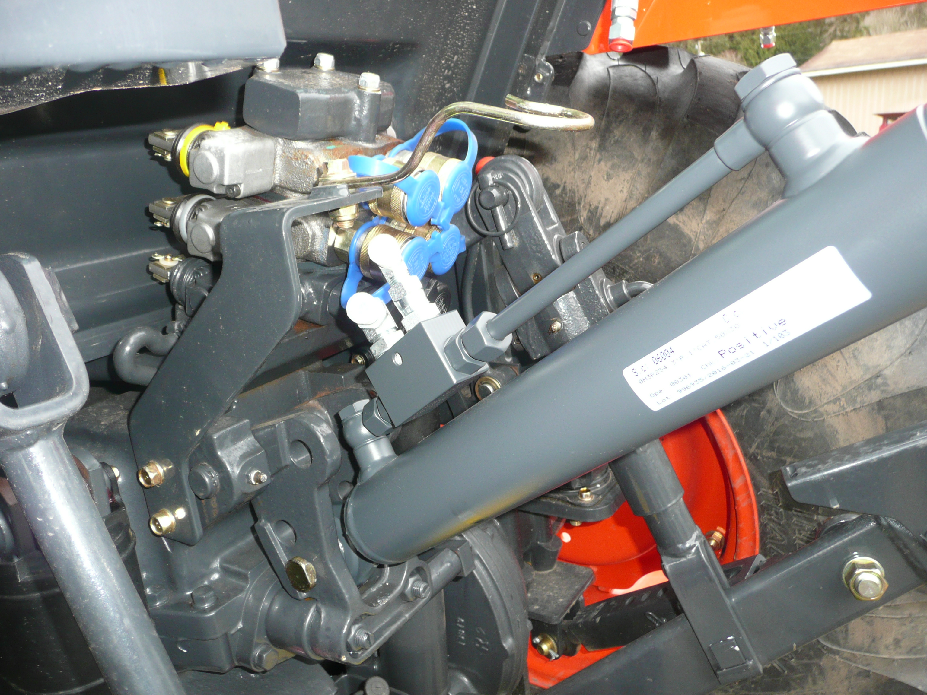

Things are finally settling down here and I'm itching to get underway installing my extra hydraulic bits. First I figured I'd do the top-link. Looking for some input on how best to route the hoses and position the fittings on the top-link.
The factory top-link holder bracket seems to limit full upward travel of the top-link with hoses coming out to the left. Not sure how much travel I'd be losing, don't think it's much; but, I don't want to jam hoses. So, I'm thinking that I should remove that hanger and bracket. I'd need to use something like a bungee until I get a quick hitch.
I'll likely swap the positions of the two fittings so that the taller one is at the rear (toward the tractor): I was moving them around to see if it would buy me more clearance/travel (not much, and not enough).

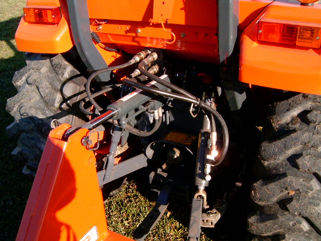

I put my check valve down for more room

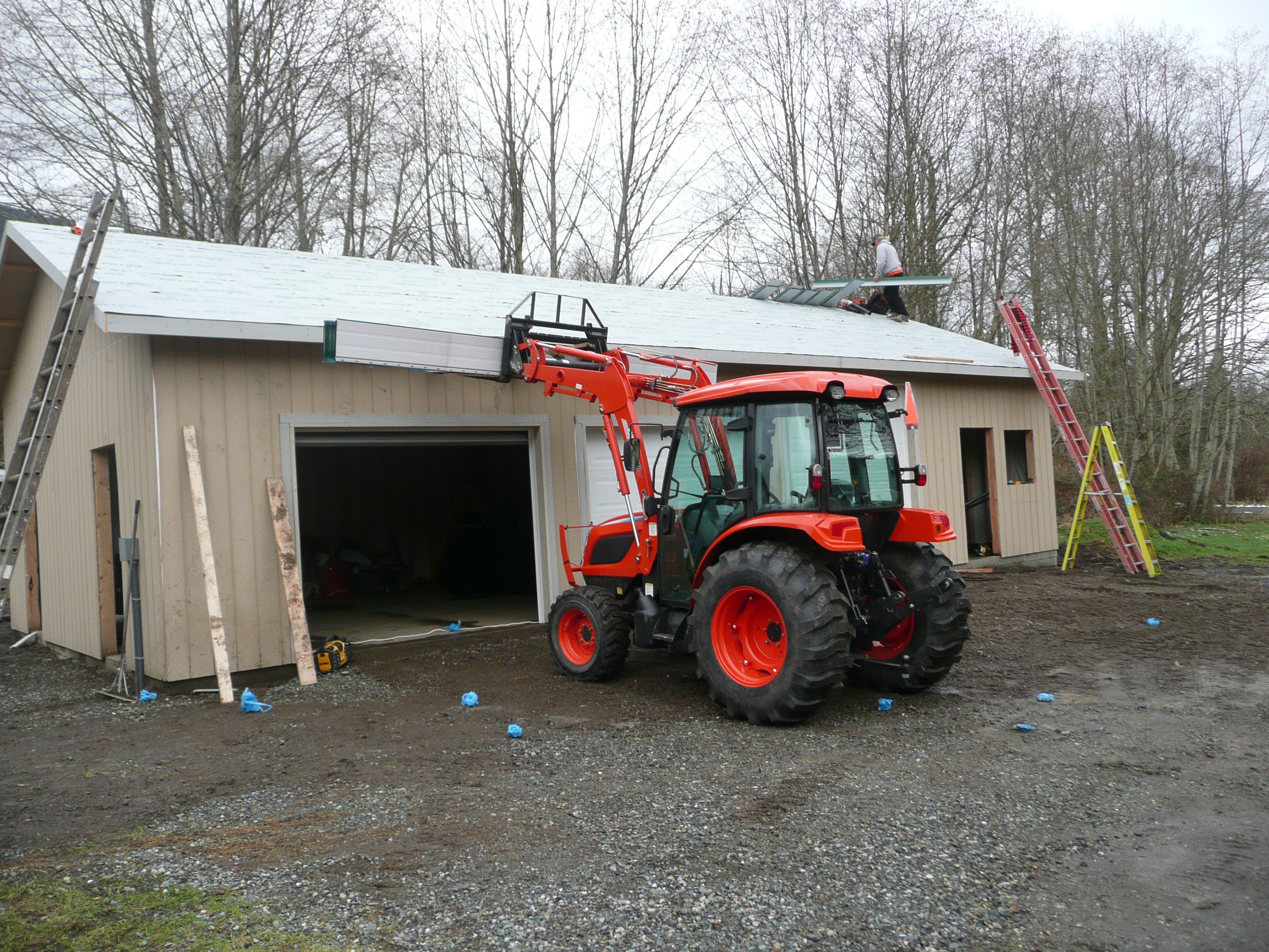

While I was contemplating the top-link issue my tractor was called in to service:

Vince, now you've got me thinking... Is there any reason why a person couldn't loosen up and rotate that block 90 degrees (in my case I'd look to rotate it counterclockwise)?
