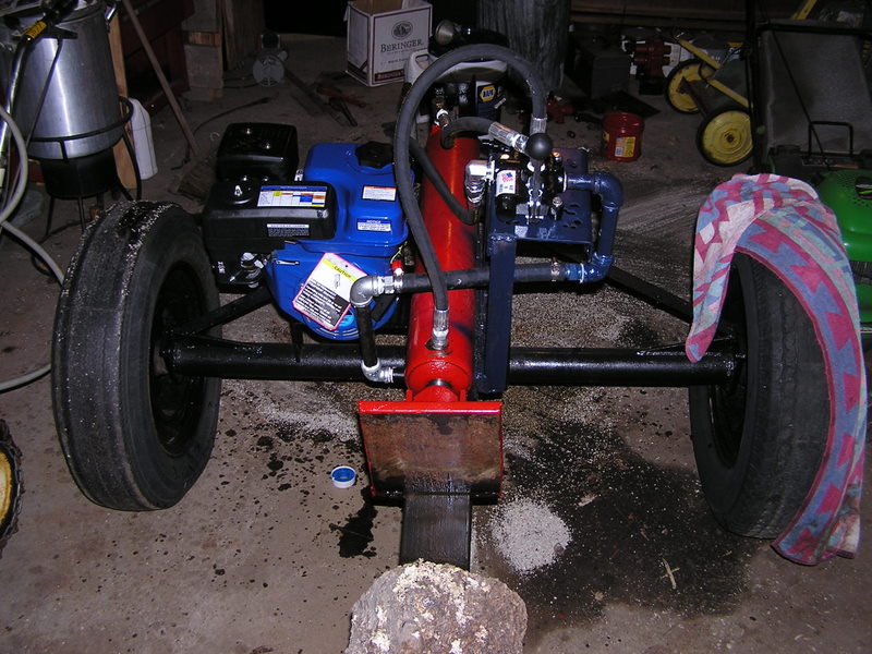

I bought someone else's project log splitter (frame with piston) and started building the rest
of it up with some new parts from Northern Hydraulics. Got it assembled, filled it with Hydrualic fluid, fired it up and yahoo the piston goes in and out no problem! Tested many in/out cycles and she works great. Put a small oak long on it, and pull the lever and guess what? She won't even attempt to split the log! Ram comes out up against the log and stops. Engine loads up, but no push. I try to hear if the relief is opening, but of course my ears aren't working their best at this stage in the game. I mean this thing just comes up against the log and stops. The wedge barely puts a mark in the log. I have ordered a 3000 psi gauge to put on the pressure side of the valve to see whats going on, but thought I might bounce this off a few of you for your thoughts as well. All the hydraulic components are NEW with the exception of the piston and Tank. I am using a Haldex 2 stage 11 GPM pump, a Prince LS 3000 25 GPM detent valve, Northern brand external 125 micro 15 gal/min suction strainer (cartridge type), 3/4 suction and return lines (proper suction hose) and 1/2" pressure lines. The tank is full of new Hydro fluid. although it does appear to be a little foamy to me. Could I be sucking Air on this external suction screen?
Other notes: the tank was originaly pretty gummed up and I flushed it a few times to remove Gak and sludge with some tranny fluid prior to filling with new fluid. Could the strainer be plugged up already with more sludge from the tank?
At any rate. I do plan to put a gauge on this (more money) and see what is going on. Any and all opinions are very much welcomed!!
thanks, Phil

can't really see the top of the valve but it looks as if the port near the handle is going to the base of the cylinder???? that should be the "A" port and it should be on the rod side of the cylinder????
could have some crap under the PR valve that may need to be cleaned out... the pressure gauge will tell the tale.
/ My no split log splitter!
Port "A" is the port away from the Handle. Also the when retracting the ram, the detent portion of the valve functions correctly and kicks out upon completion of the Ram retracting. Waiting on that gauge at this point. I'll be a bit up set if the relief valve is not set right. According to the spec it is suppose to be factory set at 2250 PSI. time will tell on that one.
thanks, Phil
/ My no split log splitter! #4
sorry about that Phil... looked at the wrong valve on the web site, just checked mine and it's plumbed like yours... when you first start these things there is a lot of STUFF floating around and it can jam under the PR valve or the pressure/flow valve in the pump, the gauge will tell all. Jim
/ My no split log splitter! #5
Hard to tell without a gauge inline. Could be the seals are shot in the cylinder.
On another note, galvanized fittings are not the best thing to use on a hydraulic system. The zinc had a tendancy to spall off which obviously is not a good thing.
Is the tank vented? Hard to tell from the pics, it looks like a plug in top of the fill pipe. If it's not vented to atmosphere you'll either cause a vacuum or pressure in the tank.
Your filter, is it a correct type, a suction filter since you have it on the suction side of the pump? Most filters go on the return side of the valve just before the tank. Suction strainers are a lot coarser because if the suction side of the pump plugs up, the pump will cavitate causing more damage than a small piece of dirt. I've never used a suction filter, don't like 'em for that reason.....Mike

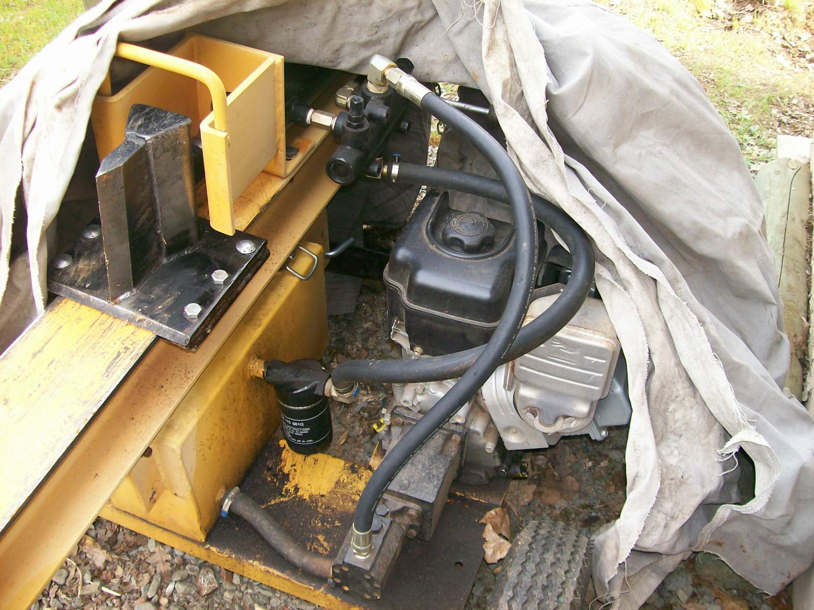

Here is what my splitter looks like :
Fred H.

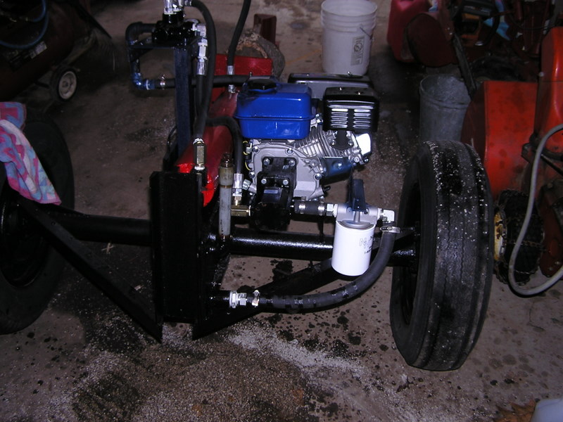

To all. that is a SUCTION STRAINER in the photo not a Filter. It is a cartridge model, (northern 4014) as the tank design, (not mine) didn't fit the usual in tank strainer very well. The filler for the tank has a breather on it at this time. I am planning on adding one that has the proper filtering there as well. However operation of the unit with the filler unplugged has no effect.
thnaks, PHil C.
Depending on bore diameter vs rod diameter, your max return flow will be between 25-33% higher than pump flow when retracting. Take that in concideration when choosing return filter and return lines...
3/4" is ok for return line, but way below size for proper suction line, especially with a long bend, a 90 deg elbow, suction strainer, fittings ID smaller than 3/4", no help from gravity/pump above tank...3/4" will make 8ft/sec, and not more than 4 ft/sec is recommended in suction lines...1" >> 4.5 ft/sec and 1 1/8" >> 3.6 ft/sec
good
Ideal plumbing on suction side is a one piece, short, large size, straight hose, with no strainer....You have nothing of that....if you use high viscosity oil, it is really asking for trouble....the more restricted suction side is, the more likely air will be sucked in....you have 9 (nine) potential spots for suction air leak
Not if you really cleaned the entire tank....but it is possible. Check it out...I would start with bypassing the strainer, upgrade suction line size, will require some new fittings on the pump, tank port seem to be 1" or more already...

Ideal plumping bigger is better, however I went with 3/4 since that was the fitting on the pump. I can't aggree with you regarding NO use of a suction strainer. Every Hydrualic unit I have. uses a suction strainer. The Diagram from Haldex shows a suction strainer as well.
Cleaning the tank was some what of a blind chore. the tank was made from Boxing in the H beam with 1/4" plate. I filled it with a mixture of Methanol and ATF and rocked the unit back a forth several times and then would repeat the process after draining it. The tank appeared to have had some water mixed with the old hydraulic fluid in it as I would get clumps of some sort of emulsion when it was drain. I repeated this until the draining process ran clear. The new fluid hasn't shown any signs of water or emulsion at this point.
regards, Phil
