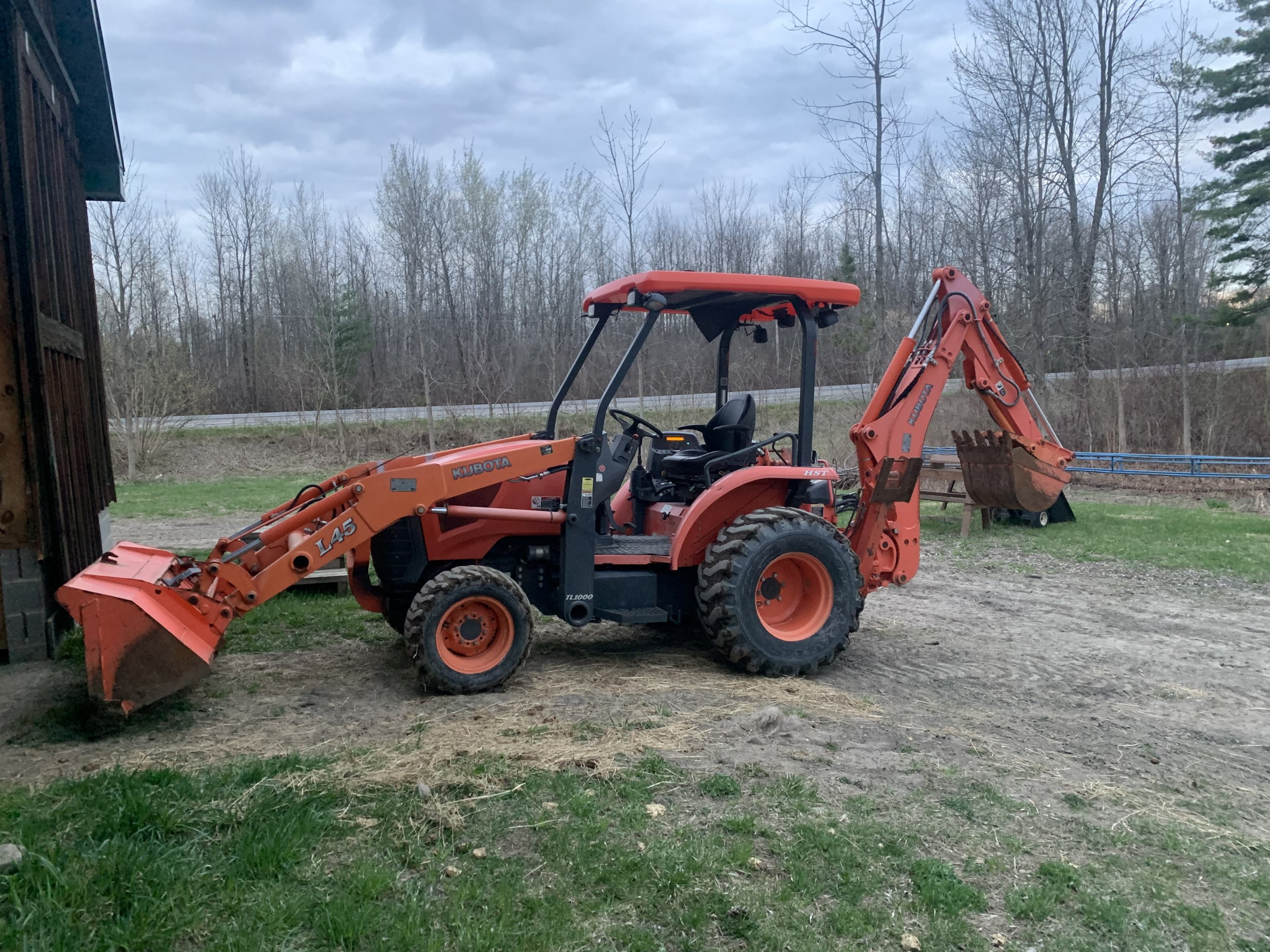

My new to me 2012 L45. She is going to need a little T.L.C. But this one has a hydraulic thumb on the backhoe, auxiliary hydraulics up front (controlled at the loader), and three auxiliary hydraulics at the back for three point hitch operation! I have never had that before. Also came with the factory three point hitch. Unfortunately I am so busy right now I won’t have time to use it much for the next three weeks. Ugh! I did get 20 minutes with it this evening to go push some horse manure up the pile and try the backhoe out for a minute. Can’t wait to get a full day to spend on it after the ground dries up some more. Still pretty wet here.

I was able to use the L45 for a little while today. A question for you folks. While digging a stump up and out I had plenty of hydraulic power. Also plenty of power with front loader and bucket moving heavy, fresh cut, bucket fulls of firewood. The place I did not have enough power was with the hydraulic thumb. The thumb opens and closes, but would not grab strong enough to lift the stump. And it wasn’t that big/heavy of a stump.
Is there an adjustment on a valve or something to increase the holding pressure?
I think it is probably suppose to give way to the bucket strength, but it does not hold strong enough to clamp and hold.
/ My next work partner: Kubota L45 #16
Set the thumb and curl the bucket with what your trying to pick up instead, or at least that's what I do successfully for picking dozens of stumps out every spring. It should have a pressure relief valve on the thumb probably preset so you don't break anything. My mini with thumb does similar it's supposed to, was a slight learning curve of using thumb correctly for me anyway. Have fun enjoying and learning on that nice tractor.

I’ll give it another try. But I couldn’t pick a stump up that didn’t weigh that much. When you say set the thumb. You mean move thumb into position with foot pedal, then take foot off pedal and use buck to clamp. Correct?
/ My next work partner: Kubota L45 #18
Correct, in my case if the stump starts to slip I'll either curl more or apply more pressure to clamp. I have a toggle on joystick for clamp. Learning to use the thumb if it didn't have a pressure relief valve I probably would have bent the hydraulic thumb cylinder at minimum lol. I will say imo I've become pretty profecient at curling the bucket and loosening or tightening the thumb simultaneously.

I’ll let you know when I get time to try it again. Maybe tomorrow, early evening. But I’ve used hydraulic thumbs before and this would not allow any pressure for sufficient clamping.
/ My next work partner: Kubota L45 #20
Similar problem with L45 on OTT discussing lack of grip with backhoe thumb. Knowing the pressure first step in diagnosing the problem.
