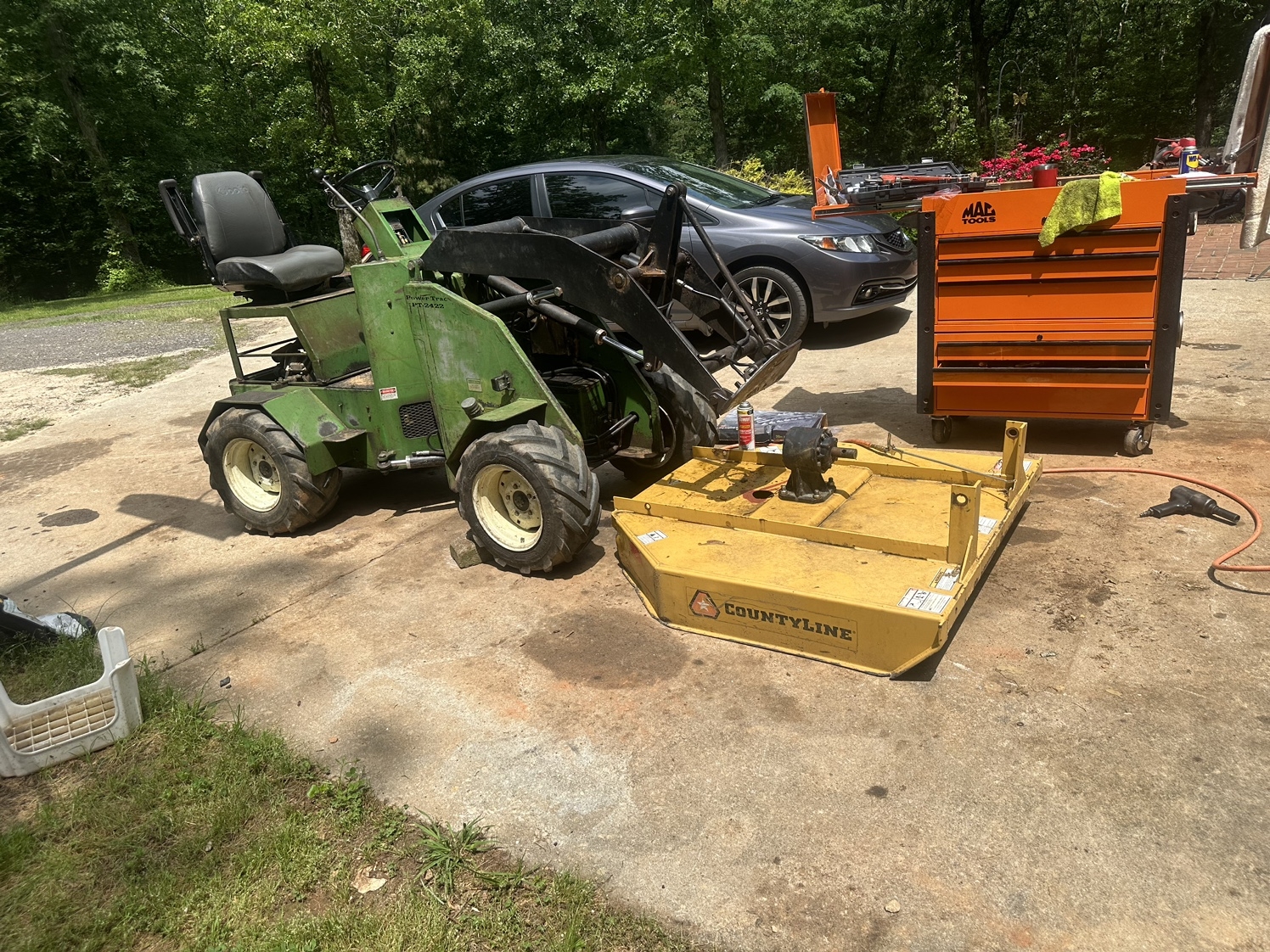

I am wanting to do something like this for my 2422
I have the donor already but need to get a hydraulic motor to run it off my aux lines. If anyone has any suggestions for me for the hydraulic motor to use for the configuration of this, i would appreciate any input. Here is a pic of the donor i am going to be using. Its a 4 foot deck. Picked it up for 300.

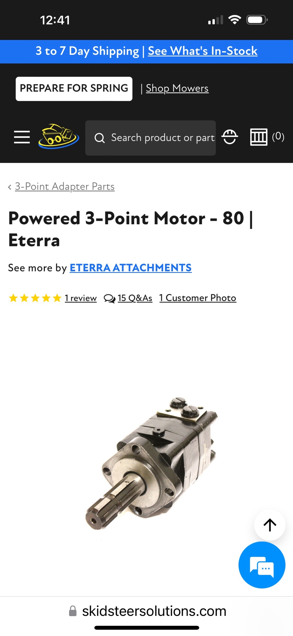

Found motor from skid steer solutions for 210 dollars plus shipping. In the process of getting the adaptor for the motor to the bush hog input shaft then will fabricate the assy to mount motor and quick attach plate to bush hog. Am excited to see how this will work out.
The bush hog turns at 1-1.47 rpm
The flow at 10 gpm is around 473 on the motor. At 10 gpm my rpm should be around 695 rpm, more than enough to do what i want. I am flowing around 9gpm with the pump i have now so i should have enough to run this deck ok. I’m not planning to use it to mow fields with, but just to use to cut underbrush and stuff out of the woods a little at a time.Let me know your opinions
