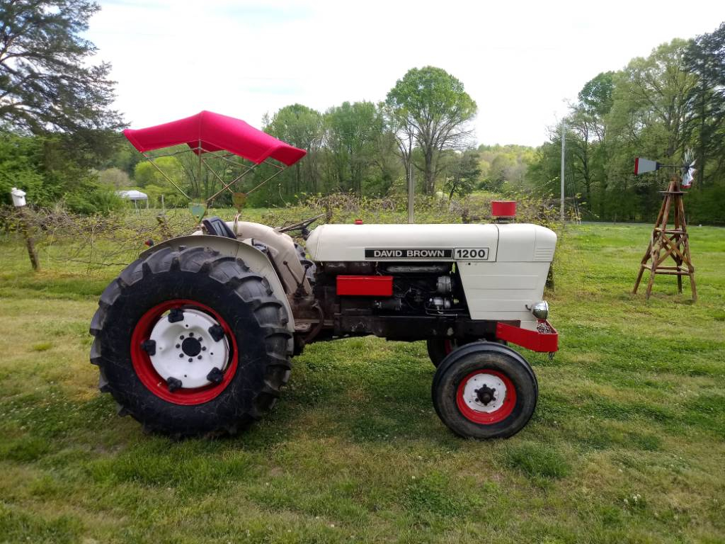

Not planning on using it in heavy first cutting hay or anything. Maybe some thinner second or third cutting hay with light windrows to keep from choking it up. I'm running a new Holland 273 hayliner and while it's not a high capacity baler it does feed rather fast compared to some balers and will not have a problem keeping up in thin hay. In heavy windrow hay I'll stick with the David Brown 1200 for sure.

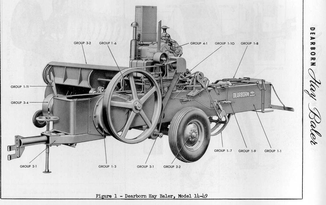

About the only way that you can bale with an 8N is with a baler that has a dedicated engine on it. But, the lack of live PTO really makes baling a chore no matter which baler you use. Here's a Dearborn baler from the 8N era that shows the Wisconsin engine that runs it:

My David brown has a live pto. But I think there is many factors that go into if a 8n can bale hay or not. Which baler? How smooth it is. How worn out everything is. I was curious one time how my grandfather's international 274 would do hooked to a square baler. It is rated at 30 hp. Then I was using a John Deere 14 t. I was in medium hay. That tractor never had one single problem running that baler. In a big chunk of hay you would hear it open up a bit but that's it. With what I have bushhogged with my 8n I have no doubts that it will run my NH 273 no problem. My baler is slick as snot.

I don't think anyone was saying it could not be done with an 8N, just making the point that without a live PTO it would be a royal PIA unless the wind rows were thin. A baler with a dedicated engine as mentioned would definitely be the better option IF the N was all you had to pull the baler. The N series tractors can do lots of things well, plow, disc, cultivate, mow, grade for example and even many things very well but balers and tillers not so much.

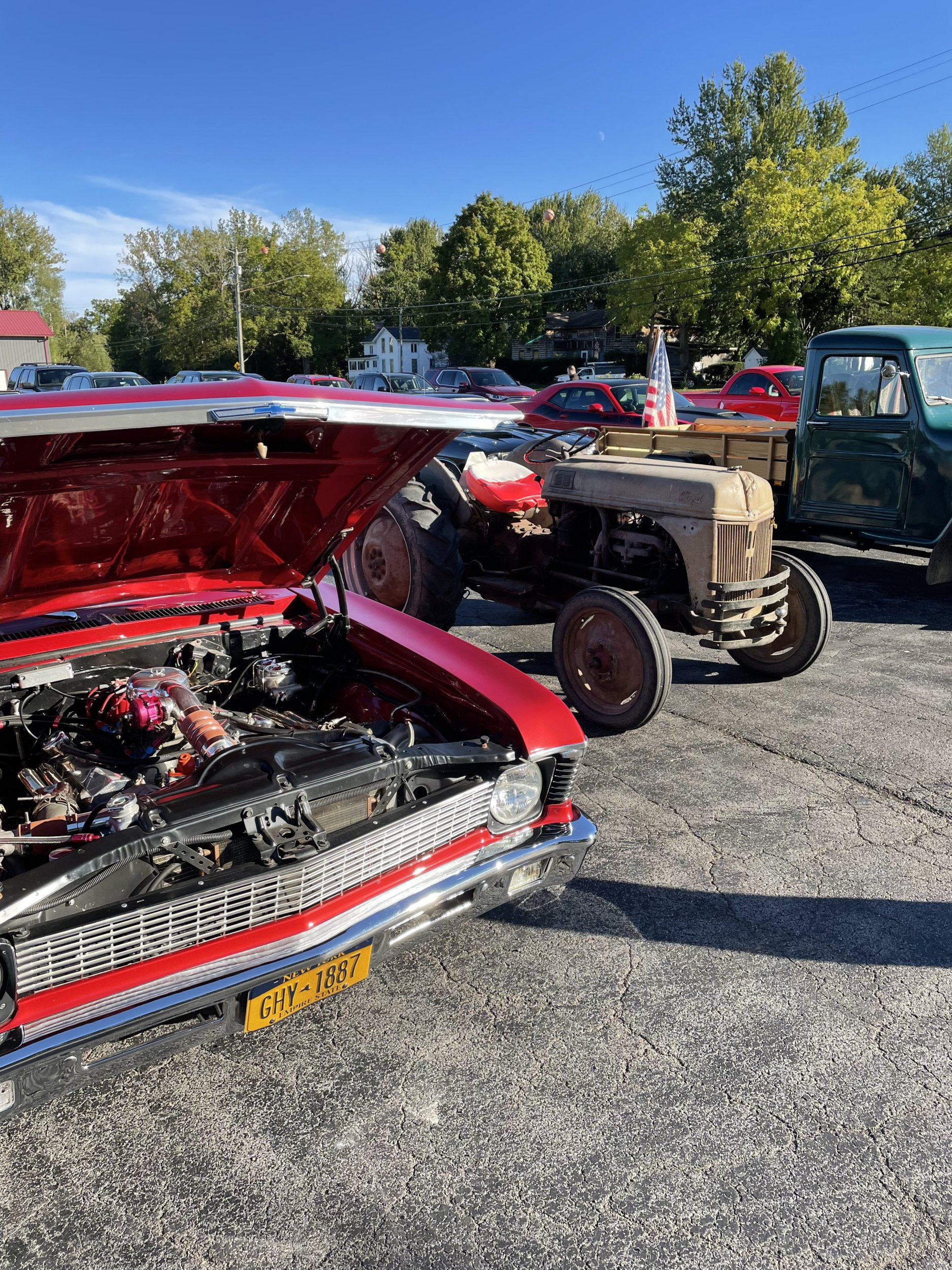

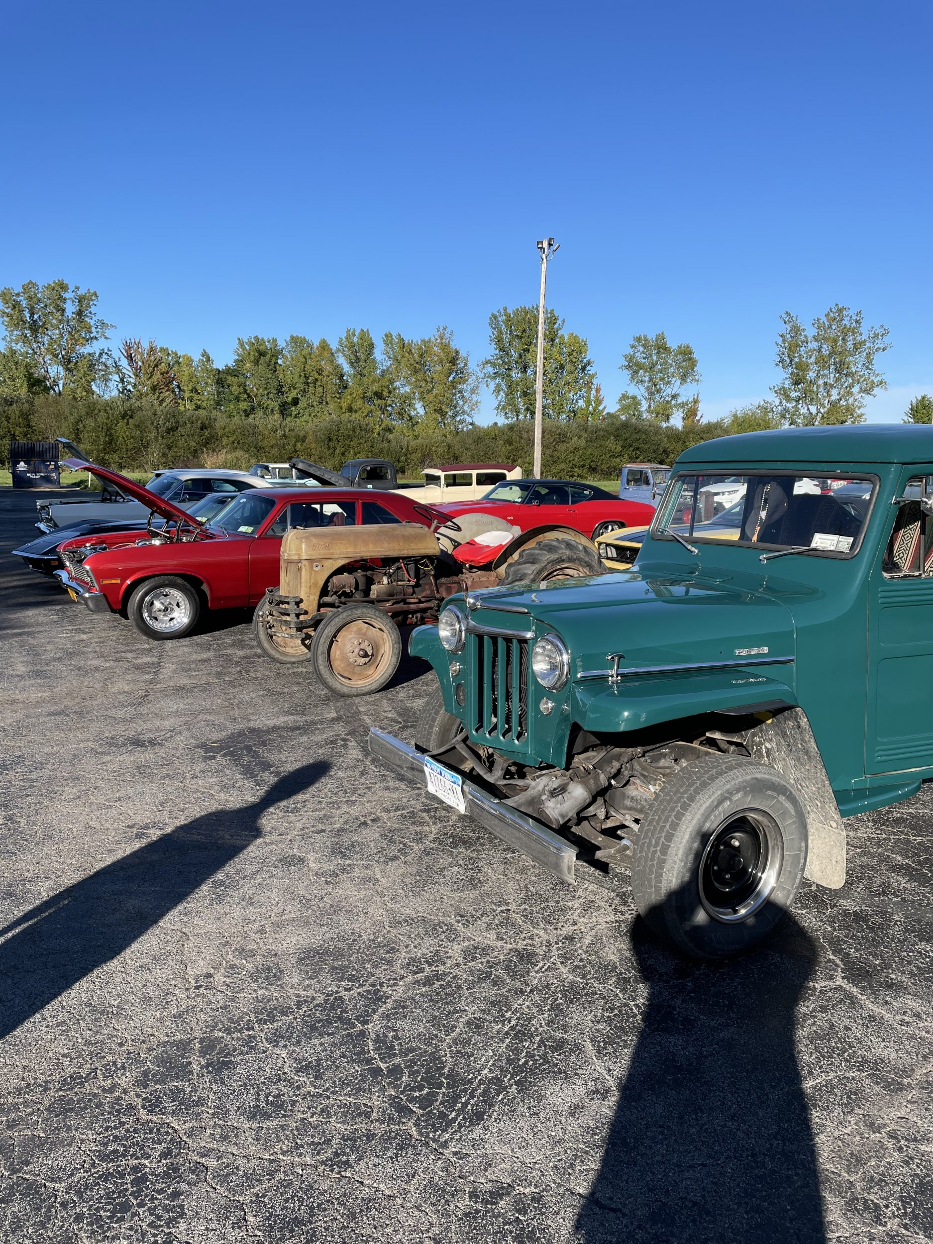

I bought my 1951 8n from the widow of the original owner in 1989. It had 1200 hours on it then, had always been stored inside a barn, and still had the original tires and paint.
The first big job I did with it was digging a 1/4 acre pond with a pond scoop. It needed a valve job after that (the originals don’t do so well with the engine under load with unleaded gas).
It’s got about 2200 hours on it now and there’s still plenty of life left in those original 1951 Goodyear tires. I’ve kept it inside most of the time and haven’t painted it. I did have to replace one of the rear rims a couple years ago, after the calcium solution corroded thru it, around the valve stem.
I drove it to a antique motor vehicle show, down at the local fire hall, last fall. It was the only machine there that still had the original tires and paint:
It got quite a bit of attention compared to all those chromed and polished up wonders. I did get that fancy new seat cover for the iron pan this summer.
