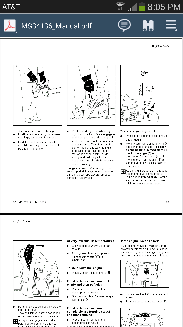

Now it's exceedingly obvious that ovrszd has never seen an MS 361 operators manual.
   / My New Stihl MS 261C-M 18" #33
Is this pix any better?
   / My New Stihl MS 261C-M 18" #34
Whew, I'm glad someone else knows what I'm talking about. Like I said earlier, I always used to "drop start" my saw. I never did it without the chain brake, and figured it was good enough. Then a professional logger and chainsaw safety instructor taught me the leg clamp method and I agree it's better. Especially if you use the decomp to prevent nutting yourself.
I'm not saying that OSHA approves it so that's why I do it, but once i got the hang of it, I like it just fine. If you are going to drop start, use the brake (actually use it however you start the thing) and if you are going to start a saw with one hand on the throttle, make sure there's nothing that saw can grab and kick back on. I've seen pics of a guy doing just that and the saw started, revved, hit a skidder tire, and hit the guy on the seat of his pants. Not life threatening in his case, but wrecked his day to be sure.
