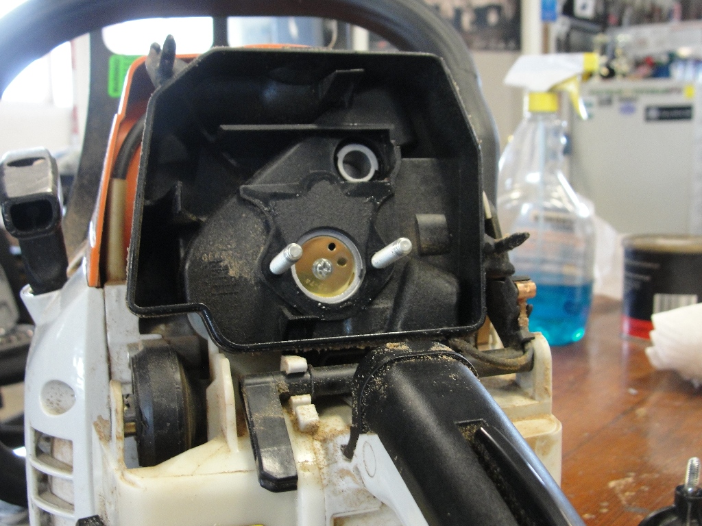

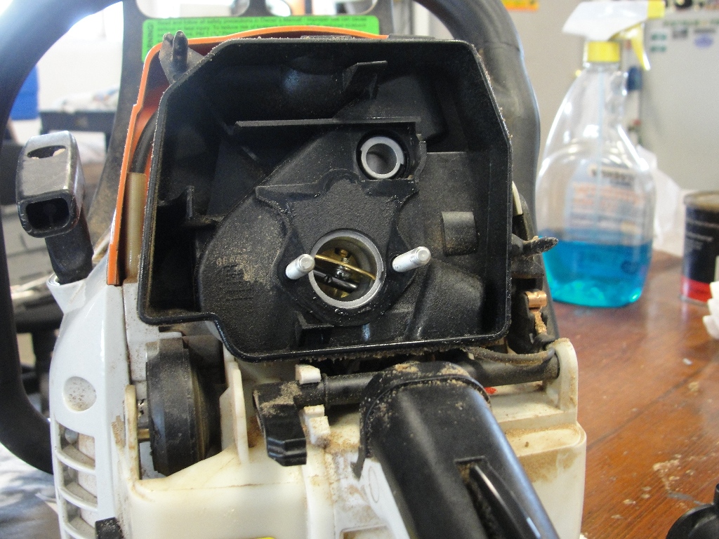

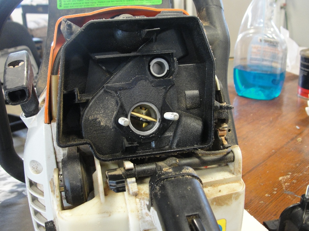

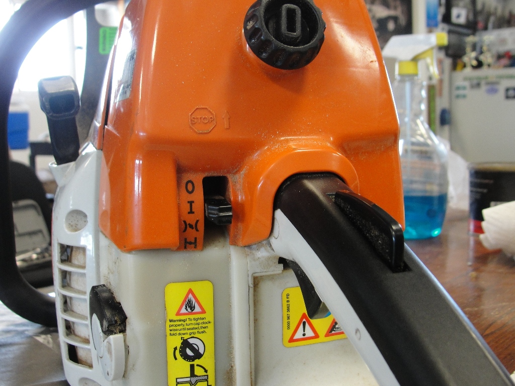

Here's some photos. My MS361 does not have "half choke". First photos are with cover installed showing the marking on the cover of half choke. Next photos with cover off showing the various detent positions of the lever. No half choke.

On most all Stihls I have run except the newer computerized models, you cannot get to the "half choke" position by sliding the lever down (if you try, you'll feel a long spongy section of travel and it will finally click into full choke). You can only do it by going to full choke first and then moving back up. And I use quotes around "half choke" because it's more of a fast-idle / warm-start setting than anything else.
So, slide to full choke and pull until saw burbles. Move lever up, which will engage the "fast idle" position. Pull again until saw fires up, let it rev for an instant, then briefly hit the trigger to disengage fast idle, which also moves the lever into the run position.
In certain cases, where a saw is warm but hasn't been run more than 5-10 minutes, I will start it by sliding lever down to full choke, then move up one into "fast idle". Then pull the string and hit trigger to disengage "fast idle" once it starts. This is called a "warm start" in Stihl terminology.
If a saw has just been running, I just move lever into run and it should start fine there without going to warm start.
Richard, I'd bet a sack of donuts you can engage the warm-start position if you do it on the way back up from full choke. If you can't, then it's broke!
