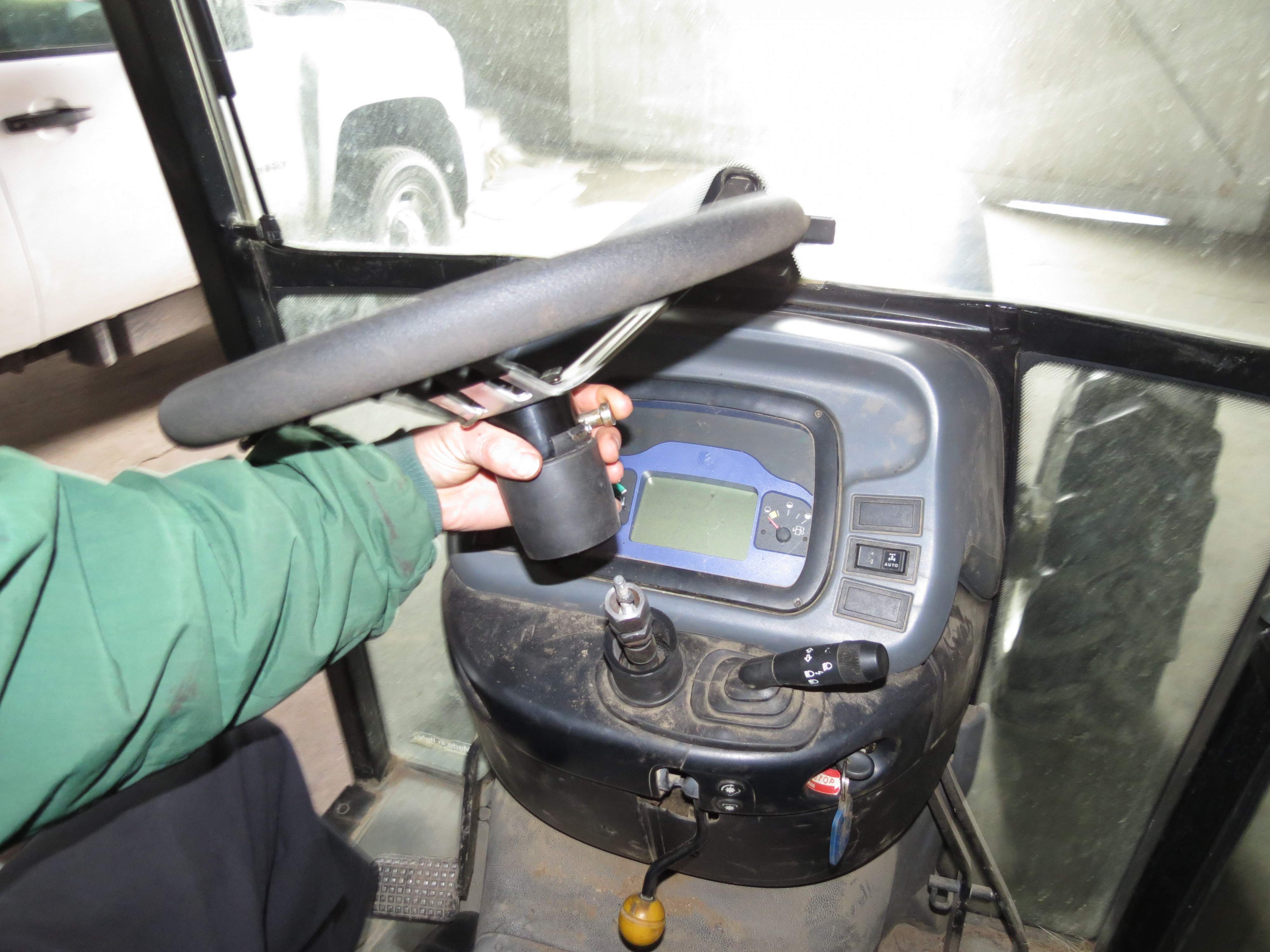

In a time when many people with the slightest disabling condition want to get a government check instead of working, I think we should be excited to help any tradesman with a disability who desires to work. It might not be possible to accomplish all the former tasks, but they can at least work to their potential. This apple grower with a spinal cord injury put a racing steering wheel on his New Holland TN95F orchard tractor. He can pop the steering wheel off to make more space when he pulls himself into the cab since the orchard tractors are so small. detach steering wheel 026.jpg

In a time when many people with the slightest disabling condition want to get a government check instead of working, I think we should be excited to help any tradesman with a disability who desires to work. It might not be possible to accomplish all the former tasks, but they can at least work to their potential. This apple grower with a spinal cord injury put a racing steering wheel on his New Holland TN95F orchard tractor. He can pop the steering wheel off to make more space when he pulls himself into the cab since the orchard tractors are so small.View attachment 387152
I agree completely, we have several TBN members with disabilities who have adapted, not long ago there was an inquiry from a paraplegic needing help.

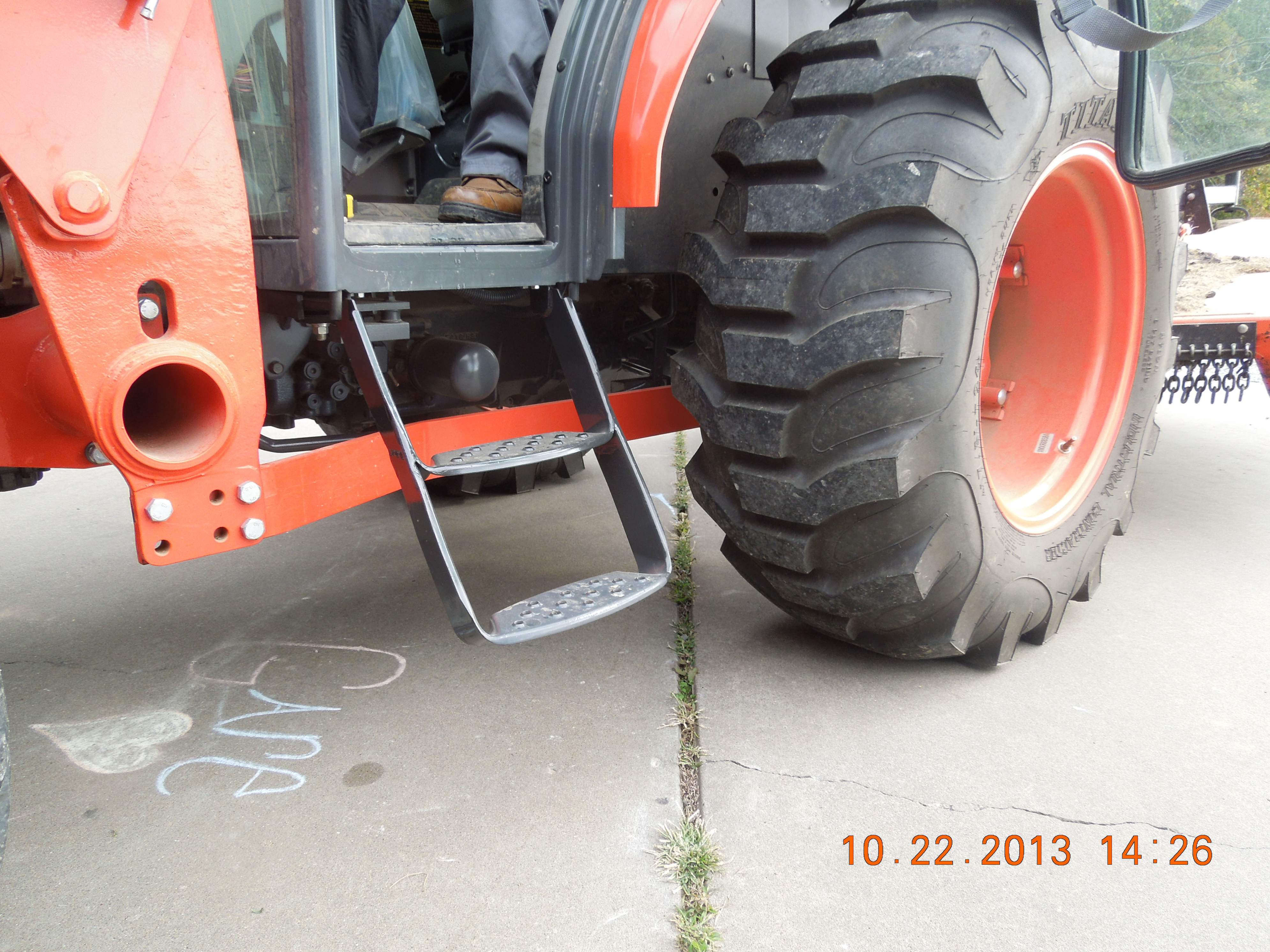

Waxman came up with this modification to help me get on/off mine and 4shorts modified my base for an air ride seat.
   / My new Kubota with Air ride seat #68
Sure will, thanks.
This modification makes the steps look like factory models! Is the frame of the upper step and mounting point on the cab strong enough to support the second step? When I have tried adding a second step onto an upper one, the torque of the second step really makes the upper step and mounting point flex.
   / My new Kubota with Air ride seat #69
No problems so far.
