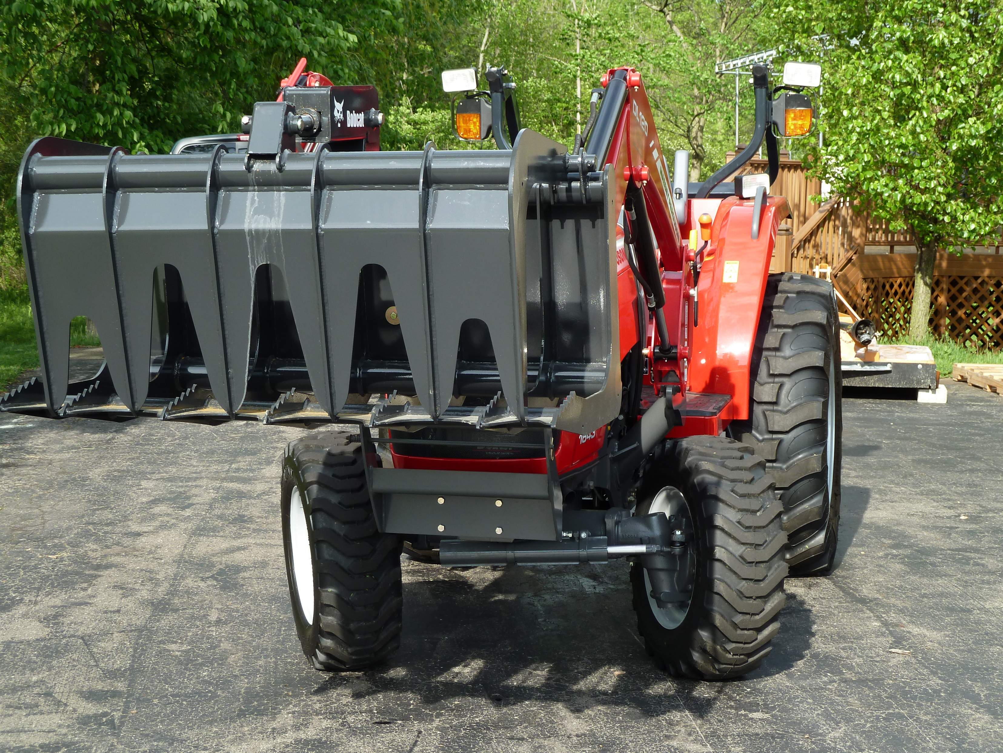

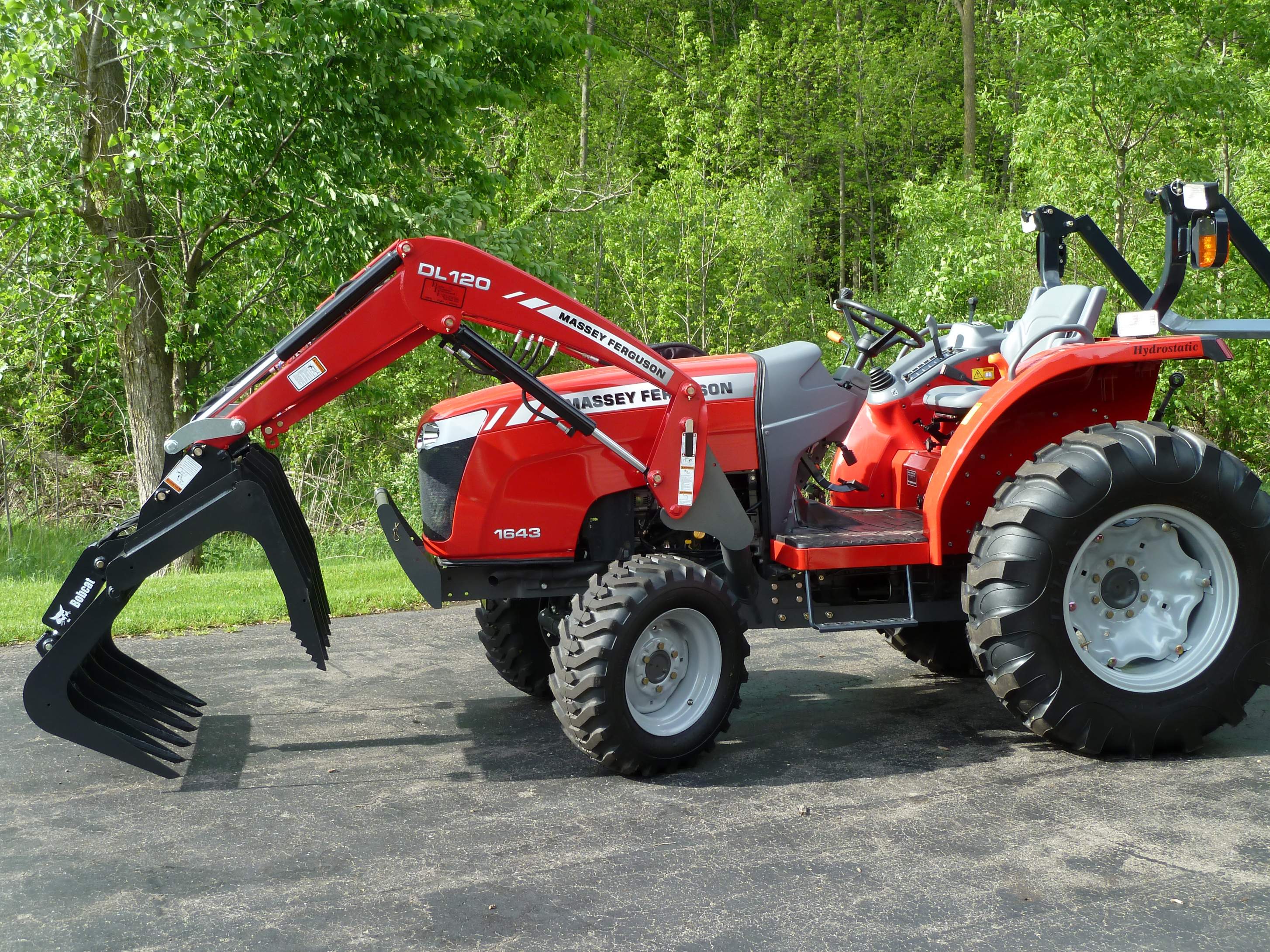

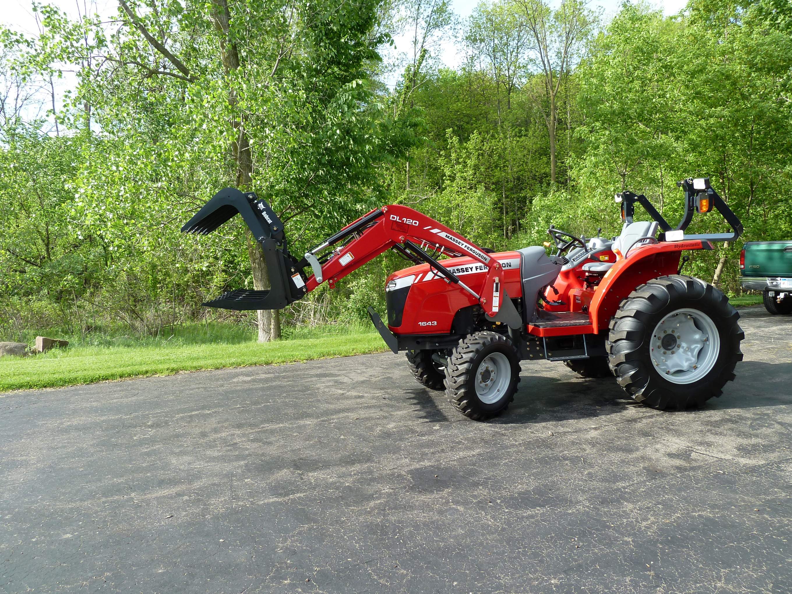

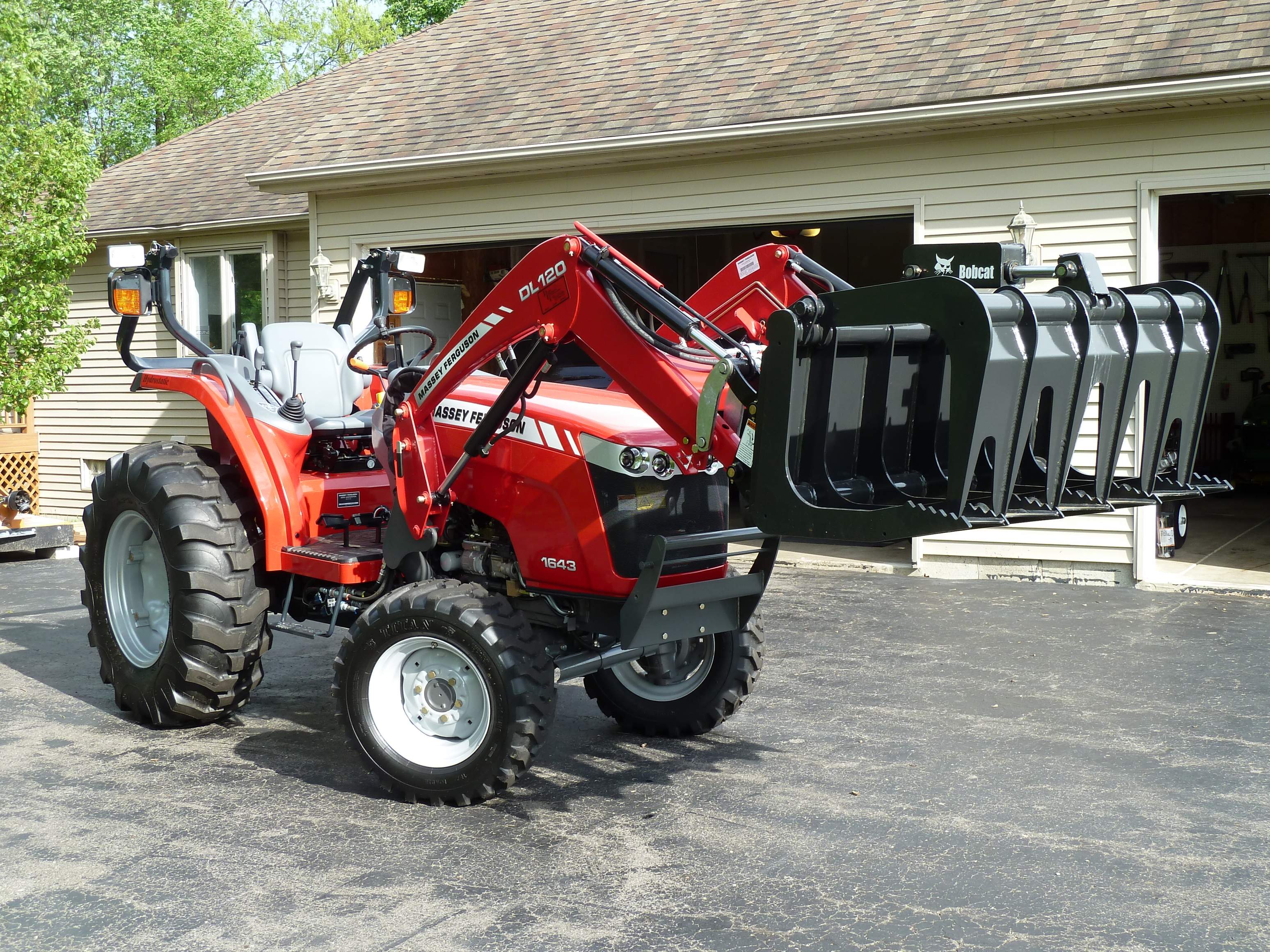

My Bobcat RG48 grapple finally came in last week, so I picked it up Saturday from my dealer. Hooked it up on Sunday and took some pictures. I haven't had time to use it yet, but I am certainly looking forward to putting it to work!

Congratulations! Looks nice on your Massey too. :thumbsup:

WOW that sure looks heavy-how much does it weigh?

I like it much better than the markham/gator grapple- by looking at yours it looks built a lot stronger.

Very nice, both the tractor and the grapple. Should work very well:thumbsup:

According to the specifications, it weighs in at 379 lbs. When I was wrestling it out of the bed of my truck, I swore it weighed a ton!

My thoughts too. What is the dimension at full open from tip to tip on the tines?
I measured it fully open and its about 29" from the top of the lower tines to the bottom of the upper tines.

That's about the same as the Markham/Gator 48", for anyone who is curious. The solid back will solve some problems (the lack of staying put on some QA like Kubota's, is the primary issue it solves), but it does cut down on visibility. Would have been nice if they put expanded metal or a grate in the center section to see through. Looks like a solid unit. You can't beat a grapple for a lot of work with brush and trees.

I agree with you. Like I said, I haven't actually used it yet, but I can already tell that there will be some visibility issues. I was concerned about objects poking through and taking out hydraulic lines or the radiator, so I decided to go with the solid back and live with the reduced visibility. Hopefully I made the right decision.

Try it out, give it some time and see. If you find the visibility is an issue, it isn't that hard of a change to make.

I'd cut a bunch of viewports into that back plate. You'll never see what you are trying to grapple otherwise. Might save you about thirty or forty pounds of weight too. I wonder why Bobcat makes them that way. I guess for scooping up construction debris or just blindly running into brush there would be no issue. However, for more precise work like digging up a stump or picking up individual logs or rocks it will be a challenge to see what you are doing.
I have an open back grapple. I can recall only a few instances where something like a branch poked through. In each case it is pretty obvious because that is exactly where you are looking so you just stop forward movement, back up a bit, raise or lower the grapple to bend the offending stick and keep going. Never poked anything into the engine compartment in the past six years of brush removal.
I do like the upper grapple jaw compared to a traditional clamshell. This grapple still has a forward projecting bottom jaw that will hold material with just gravity while a clamshell will not. I imagine this one will not open as wide as a clamshell but there are relatively few times when that is an issue.

I've had lots of stuff poke through, and even hit the grill occasion. Now I added some expanded metal in the center and it helps grab brush better as it provides a "stop" for it to push against better. And doesn't hurt visibility.
I assumed bobcat made it that way as the basic standard interface for a SSQA implement is a solid flat plate across the back like that (with the angled hook at the top and the bent hook slots at the bottom, of course). Maybe they had another reason to offer this option...dunno.

The "standard" SSQA mount does not require a solid back even though most are built that way. It is possible to just have two smaller solid pieces at each side with a clear area in the middle. This second type, perhaps with a mesh brush protector would allow much better visibility for the grapple operator.

Ya just KNOW the safety police are gonna jump on Ya for having that ROPS folded (-:

Let them jump away! I only pulled the tractor out of the garage to take pictures of the new grapple, so I wasn't about to put the ROPS up for that.
