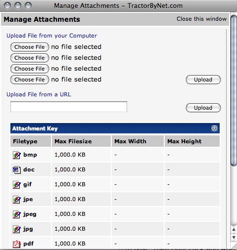

Look for "Manage Attachments" under the "Additional Options" when you are replying to a post - that what it's for - to attach photos directly to a web post.
See attached photos .... :rolleyes:

If you have saved the photos to your hard drive on your computer, just click the paper clip in the posting dialogue box to bring up the attachment wizard, then click in the blank line next to "Browse". This function will let you navigate to the folder on your computer where the photo's are, then click on the file of the photo. After that, click "upload". As long as the file is smaller than 1 MB, it should upload it. After it uploads, click Preview Post to see if it's there. Good luck.
PS - you have to use the "Go Advanced" posting feature to see the paper clip for uploading.
