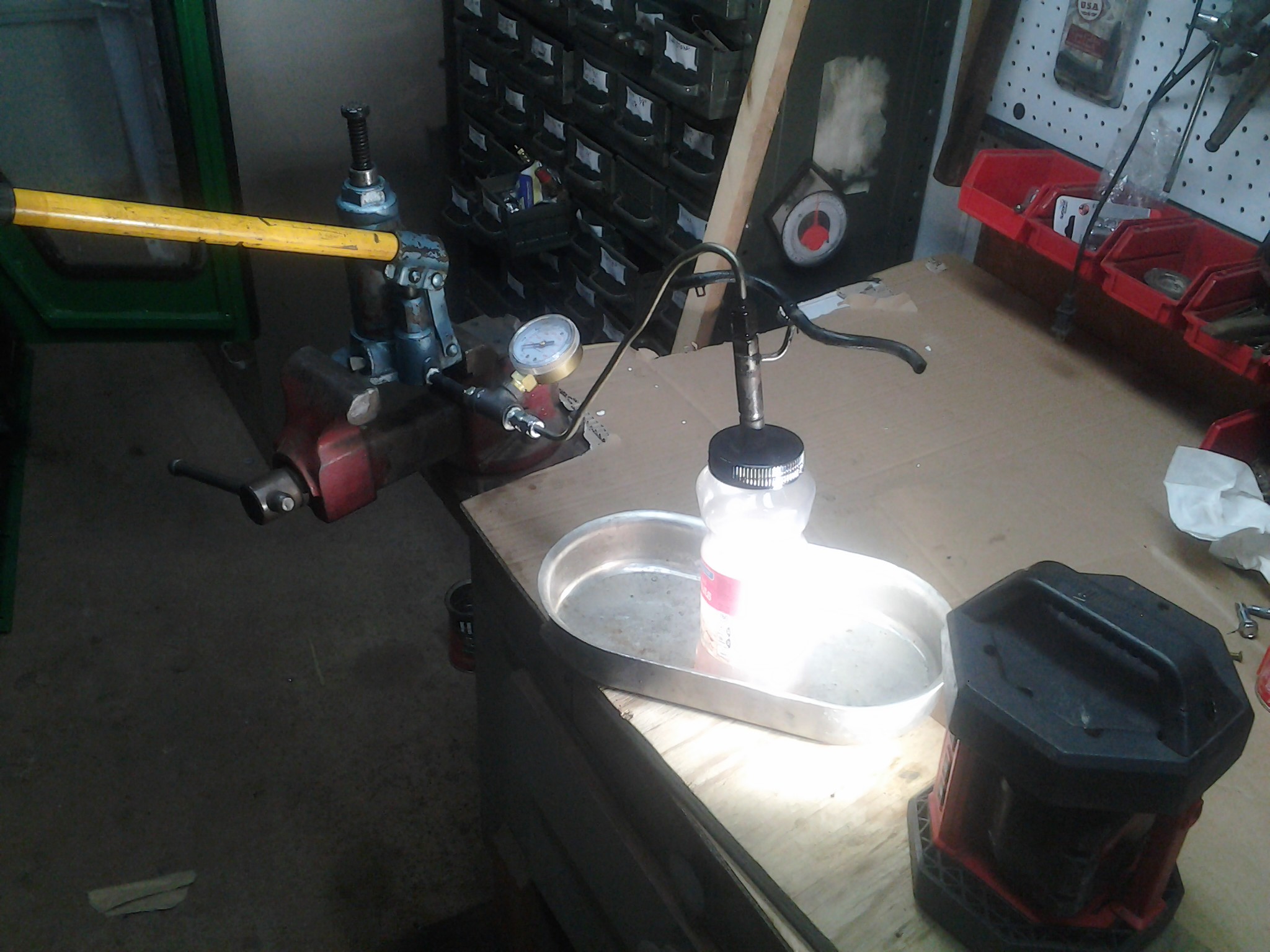

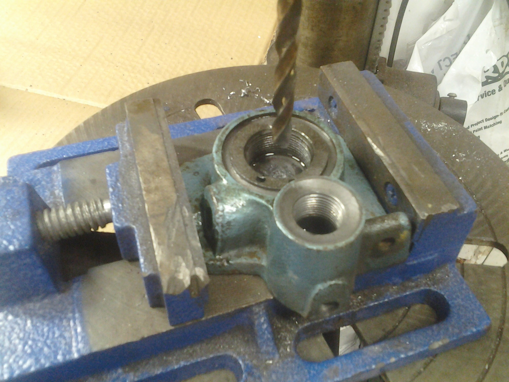

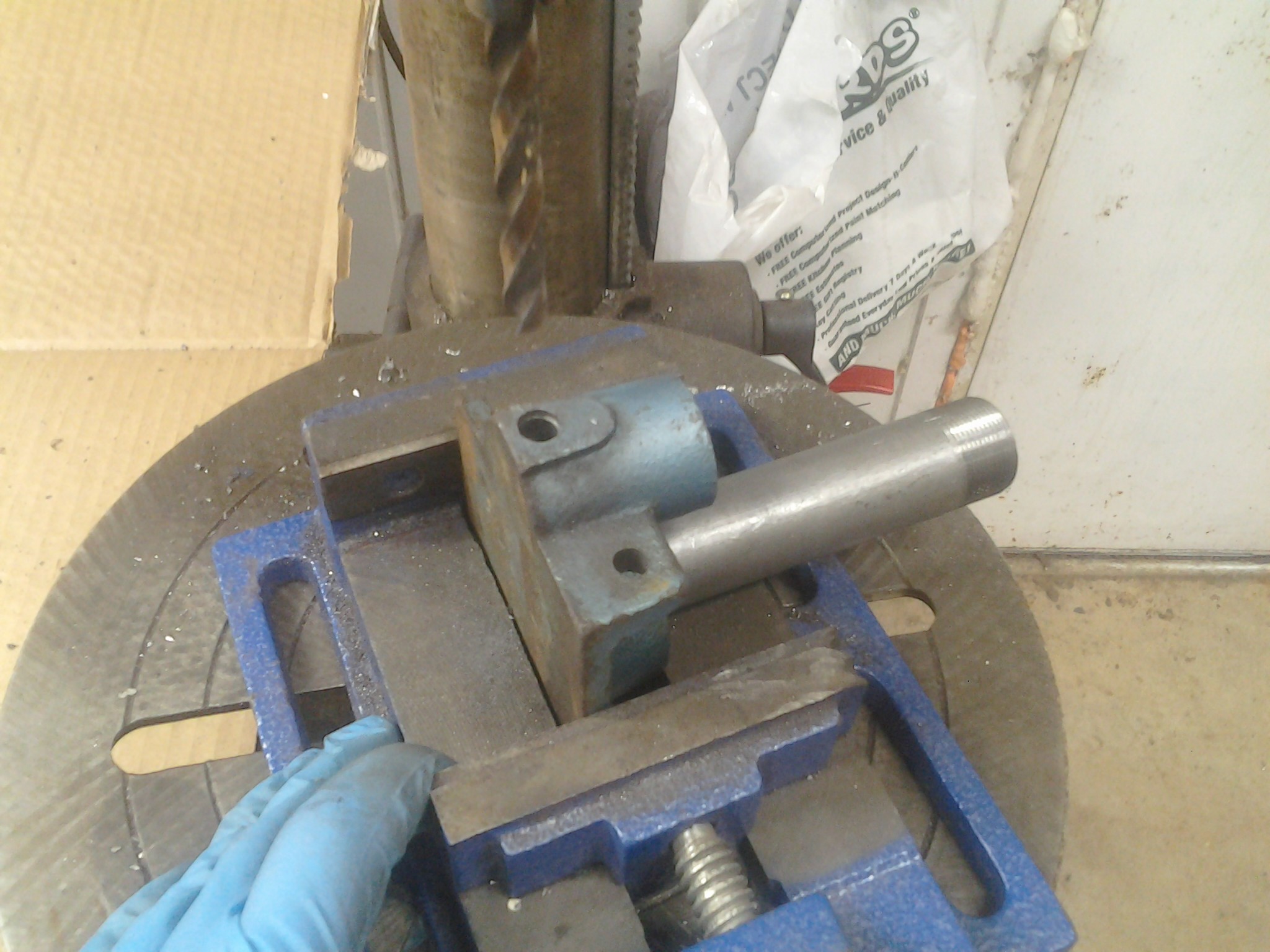

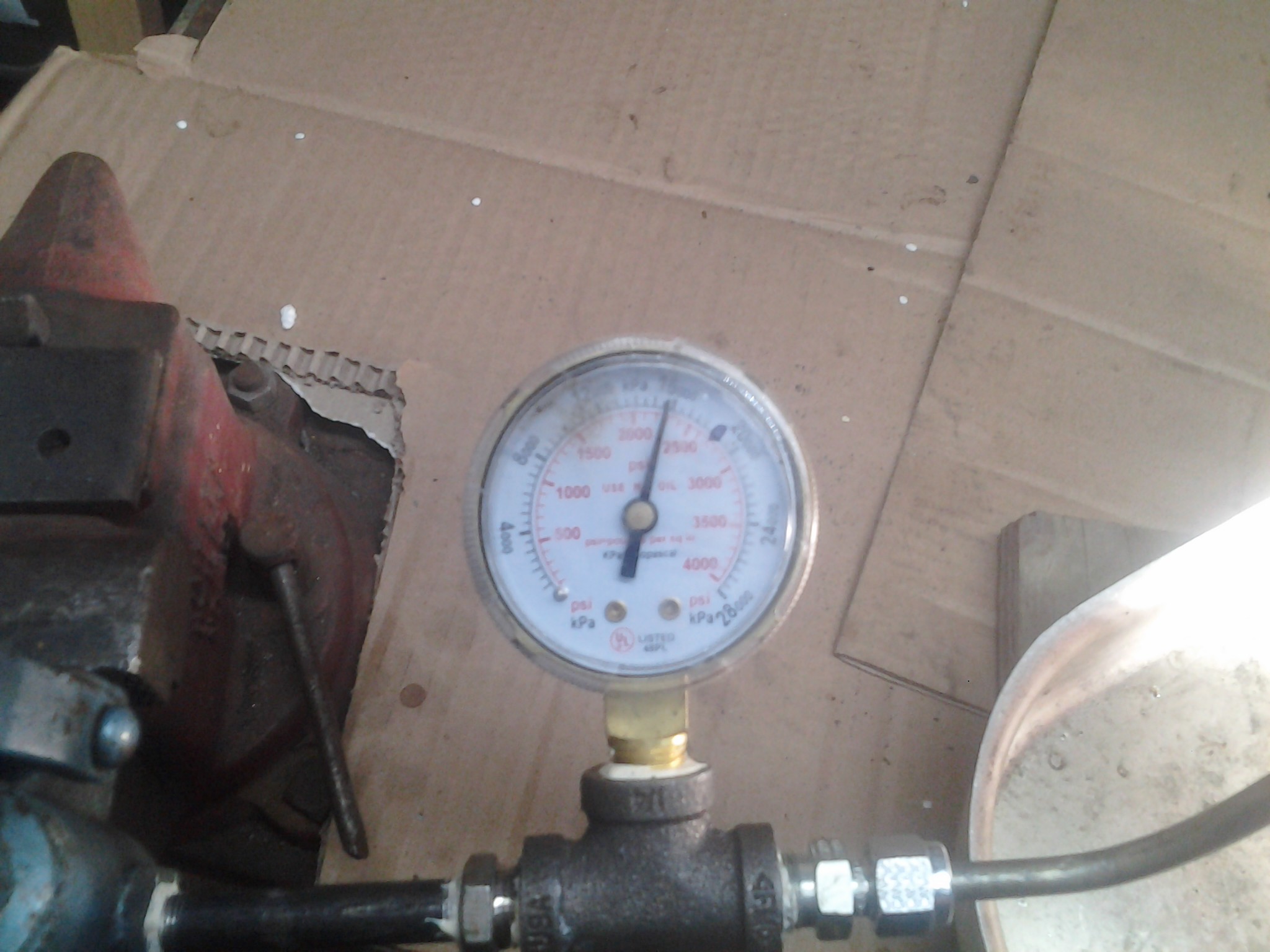

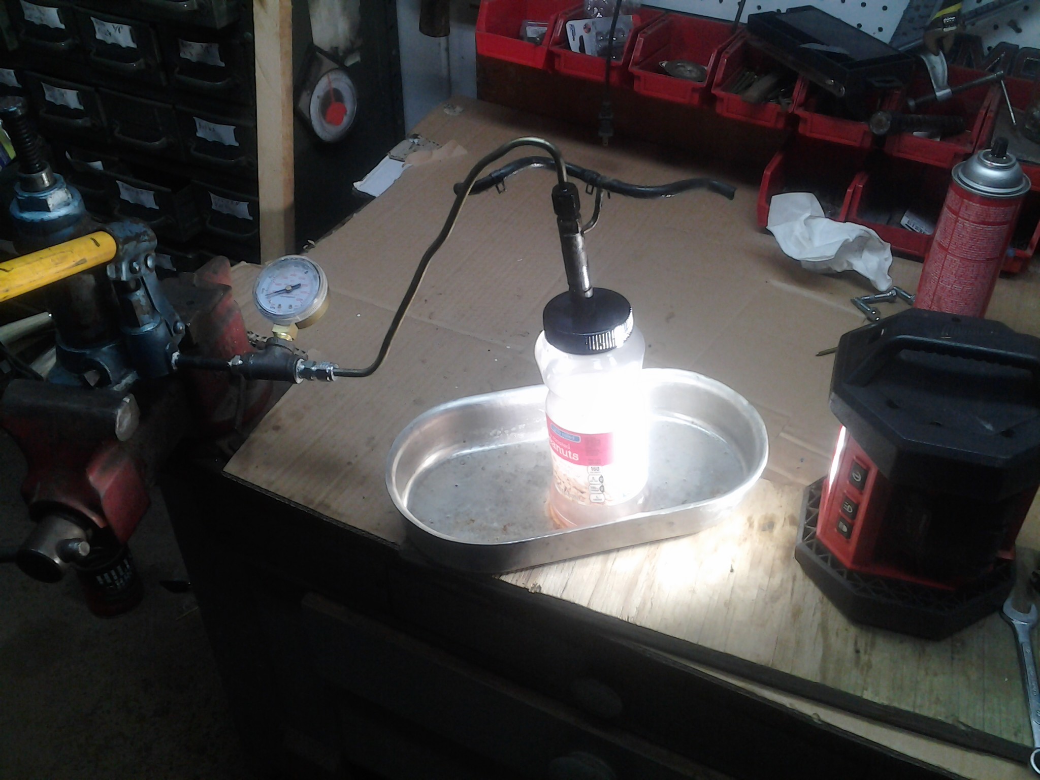

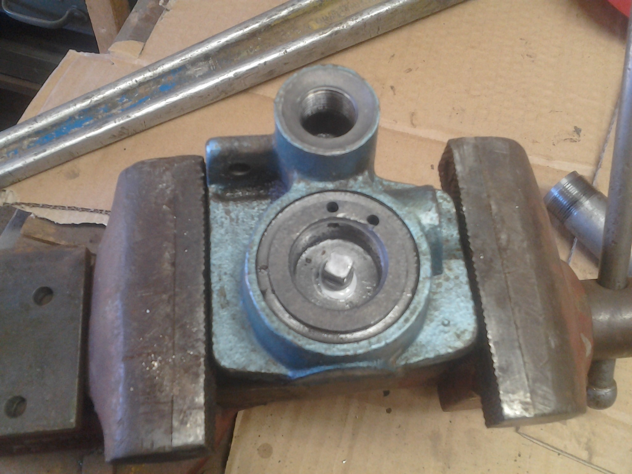

I had an old bottle jack I'd gotten for free while scrapping years ago setting on the shelf. I tore it apart, cleaned it, and then converted it. To convert it was simple, I just drilled and tapped 1/8npt threads in the hole where the oil used to come out to go to the piston, and then plugged it. Then I drilled out the rifle bore plug under the pump to 1/8npt and then tee'd that to a gauge and a 1/4" compression fitting. I attached 1/2 of an injector line off a 350 olds diesel to the compression fitting. I put the bottle jack back together and filled with diesel instead of jack oil, purged some fuel through it to clean it, then put the injector into a hole in the lid of an old peanut jar so I didn't fill the shop with diesel vapor and I was off and running.
I was going to take more pictures but I forgot to. No welds to leak, and if I want to I could convert it back to a bottle jack easily which appeales to my fear of commitment.
The only thing I had to buy was the gauge, got it on clearance from northern tool for $1.99.
