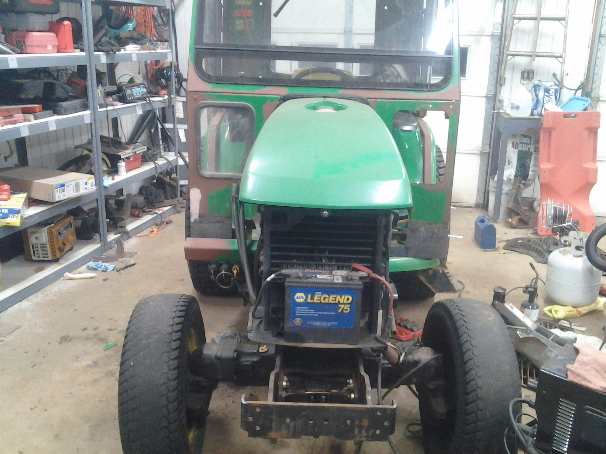

Well I brushed on the Majic this weekend. Mixed results. Being able to cut in the difficult to get to areas without spending all day masking was nice, but on the large sections the brush streaks are unacceptable. I should have waited till it warmed up outside, reduced it, and run in through the gun.
On the bright side it's all one color now and has a thick layer of green on now. I'll give it a couple weeks to fully harden and sand it all flush. The thick layer of green will be kind of nice in a way because I can sand out some of the imperfections coming through. Using the hardener definitely helped, but the OEM Valspar JD yellow I sprayed on the wheels still dried quicker.
Once I've sanded the visible areas of the cab I'll mask it off and paint with rattle cans of the Valspar JD green. The OEM JD paint comes in a valspar box from valspar so I'm going to guess that the Valspar brand from Fleet Farm is going to be just about the same stuff as long as I can find it. I think the Majic paint is good stuff, I just didn't apply it right and it's taking a long time to dry in the cold.

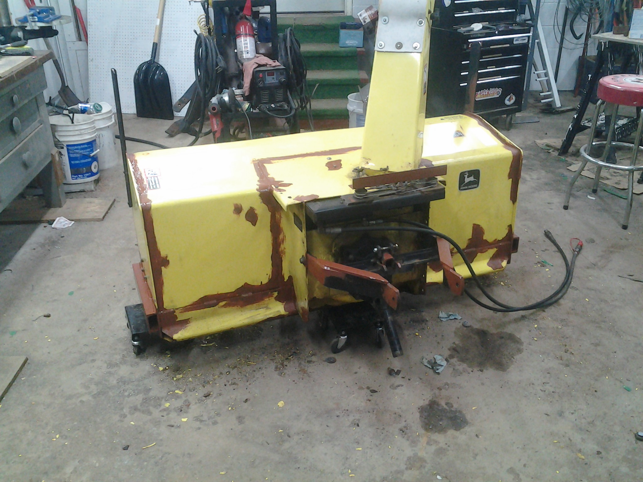

Been stupid busy at work, haven't had a chance to play with the tractor much. It's been snowing a lot recently so I've been back at it in the evenings. Made some pallet forks and started making a new 3-point arm to replace my missing one after giving up the search for a used one. Should be pretty simple and a whole lot cheaper than new from deere. None of the aftermarket ones were very close to being the same so I figured I'd be better off making my own so it's exactly the same (or better) than factory.

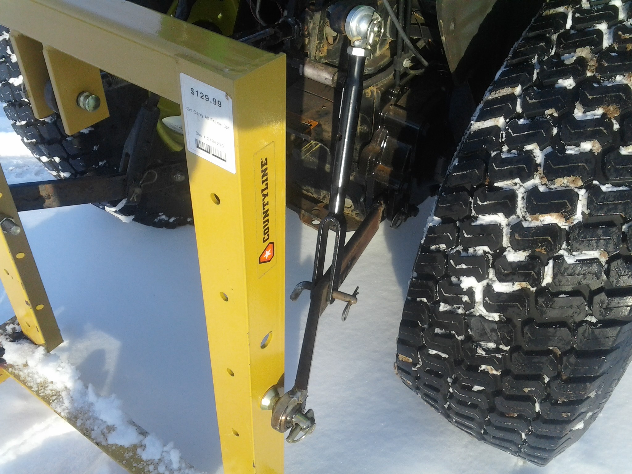

Got the draft link done. Turned out pretty good. I ended up breaking the tack welds from above and grinding the tip of the bar stock at an angle. It now is identical to the dimensions of the JD link. Ball centerline and angles are the same. It also has more freedom in the transmission ears than the stock arm and more room to the inside of the arm to the attachment. I'm not sure why the stock arms had such strange offset ends.
I made mine from a 24" piece of 2.5" x 3/4" bar stock, bent it with a 50 ton press, welded on ball ends from agri supply that were $5 a piece, and drill the holes in the same spots as the original. I also made the lift link from a $15 agri supply link and cut off the top and welded a ball on that. >$500 savings over JD. I haven't made a stabalizer yet, not sure if I want to duplicate the pin hole thing that is stock, I haven't used it much but I think I'd prefer to have a chain and bell crank. I find the multipin hole link unnecessarily complicated.

Comment: Your welds look great as does your build/fab job. :thumbsup:
Suggestion, if you are going to use this rig in brush, change out the quick clips (shown in pic #3) with bolt/lock nuts or you risk losing that arm and some serious damage to casting can happen.
Also, with using the quick hitch you show, then the need for frequent changes in the stabilizers is reduced considerably. I only have one 3 pt attachment now that isn't iMatch ready to hook up and go.

That's actually a pallet carrier that I'm using to carry a pallet with weight on it in lieu of a weight box (next thing to build). I don't have a quick hitch but that's on my list, I'll probably wait for a 25% off coupon and get one from harbor freight. It seems like they are the same as all the rest unless you buck up for the deere brand. I guess I've been lucky enough to not lose those clips on tractors in the past. Usually I rotate the pins so that gravity is helping the pin stay in. At the very least I replace those pins when they don't spring as well any more, but I'll probably take your advice and use bolts when I get a quick hitch.

K on the carry all... see it now.
And only takes one well placed stick to rip off the bail on the pins.. regardless of how much spring is left. So rare that those arms are ever removed.. unless you exchange with a backhoe. Good on your builds.

O I see what you are saying, you said third picture which confused me. You meant the first picture which shows the pins at the transmission case? Yes, I'll bolt those, good idea. Makes sense now!

Yes, but thought that was 3rd pic.
Need glasses.. :)

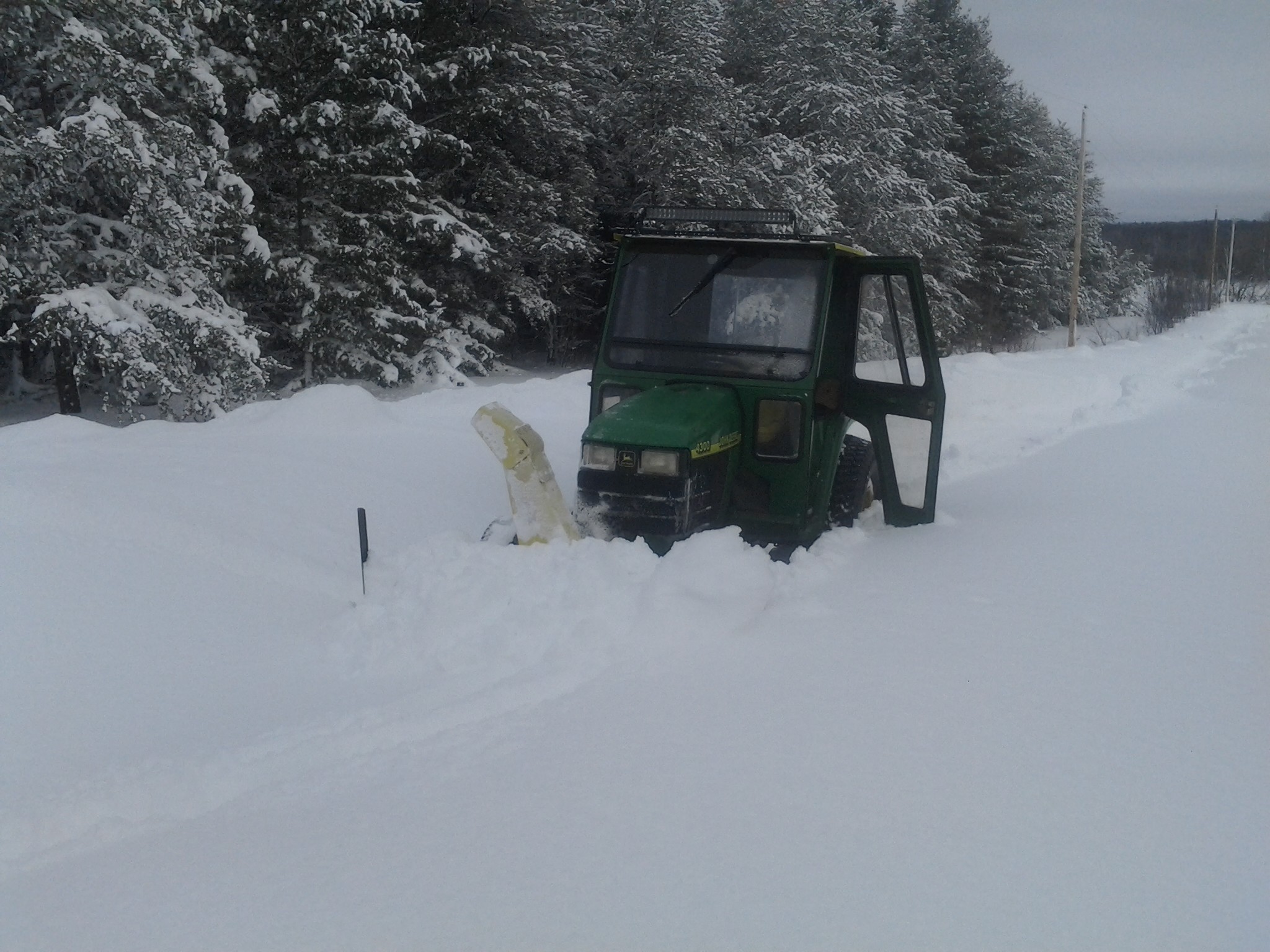

Kinda forgot to update this, everything's been working well. I love having the heated cab.
Had to go open up the neighbors driveway last weekend. They hadn't been keeping up on plowing and it drifted in on them. I took my time in low gear and the model 59 blower just kept doing it's thing. Never got stuck despite a coating of ice on the driveway underneath.

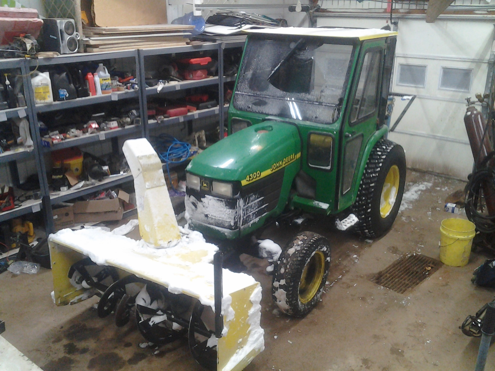

Pulled it in the shop last night to de-ice and get some more lighting.

Yeah, turf tires are great in the snow!
LED lights are great...might want to consider good quality lamps. I'm still using factory lighting (I also have a Curtis Cab) on the front...replaced the rear work light with an LED Light Bar
