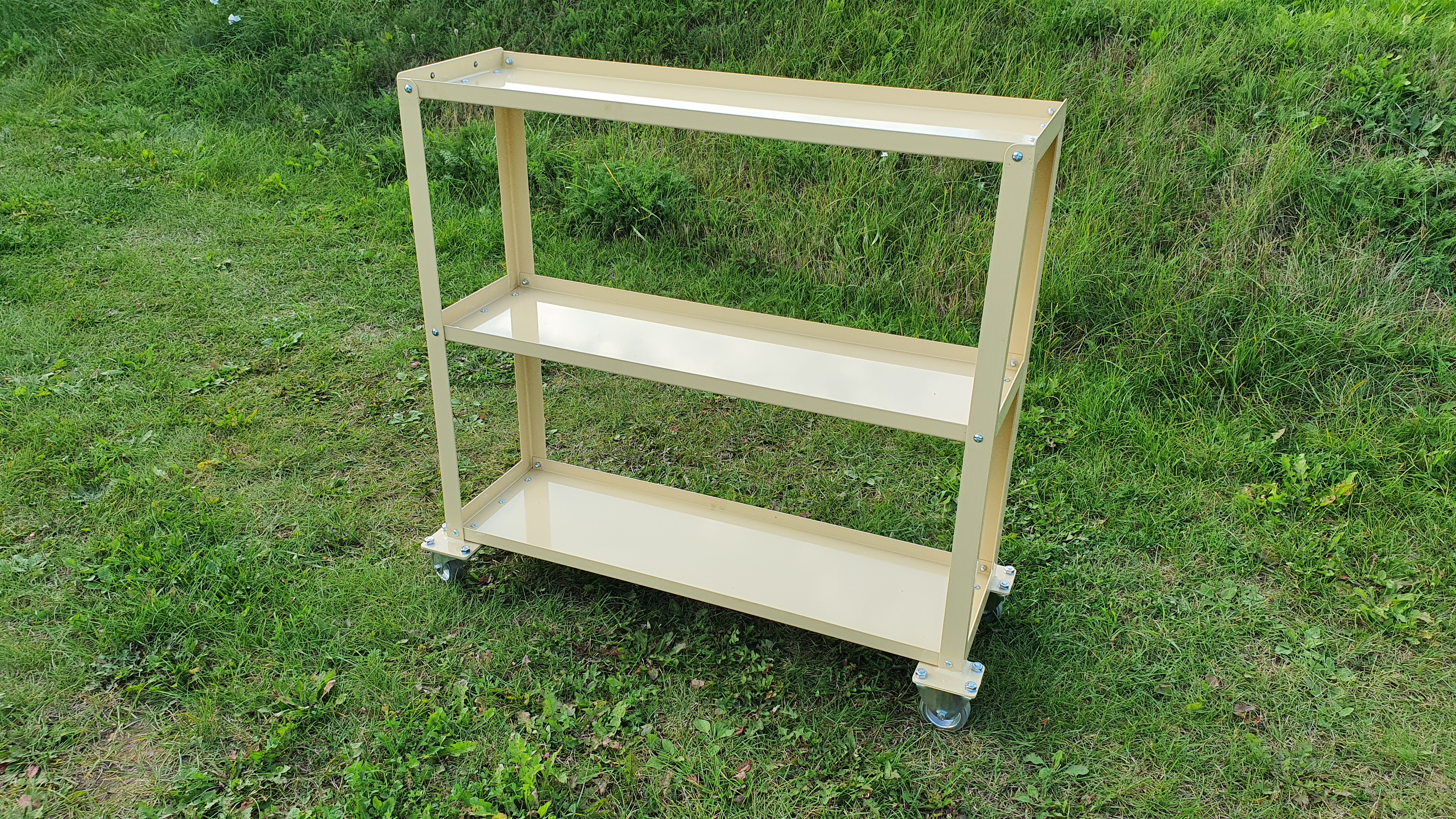

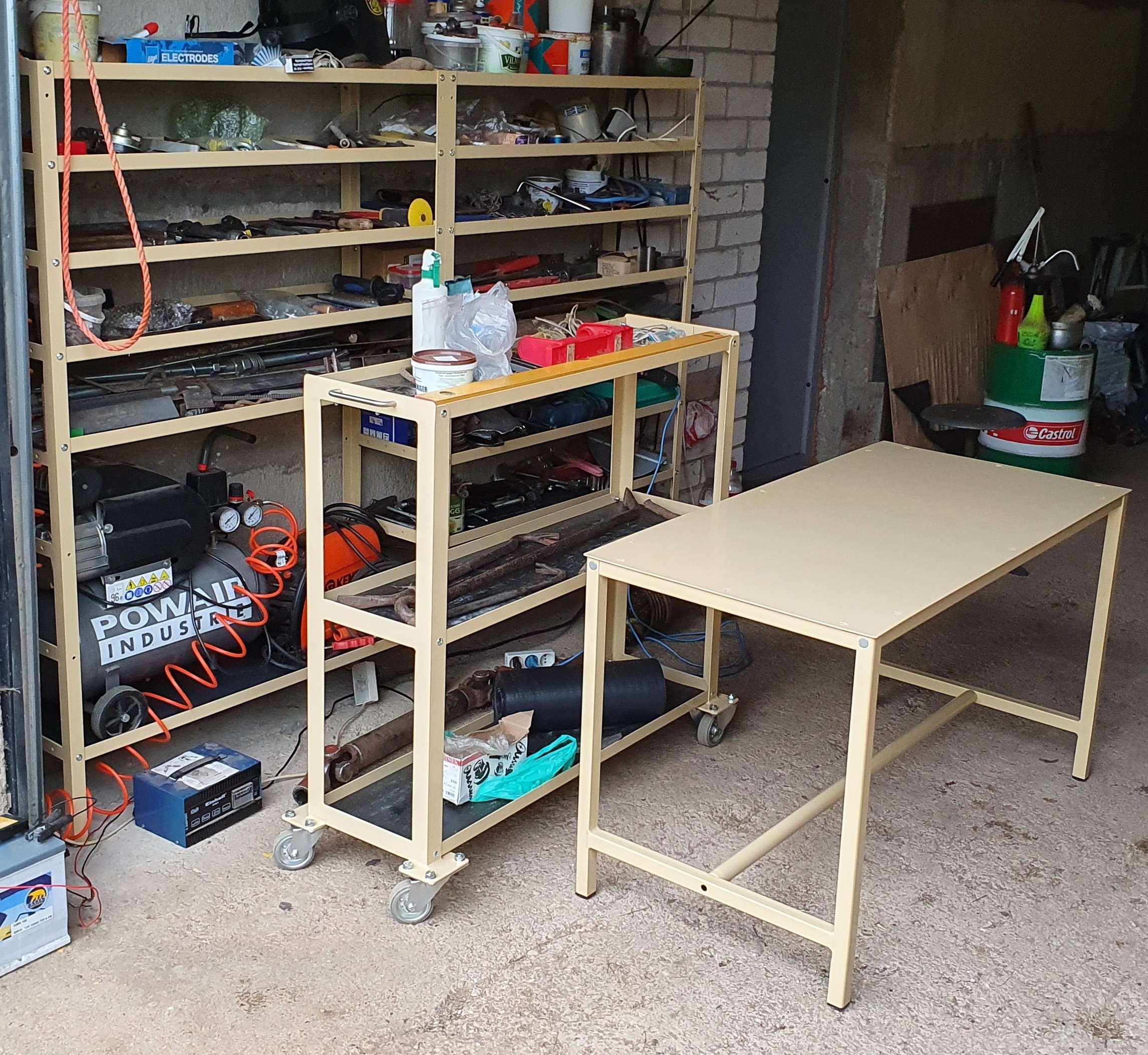

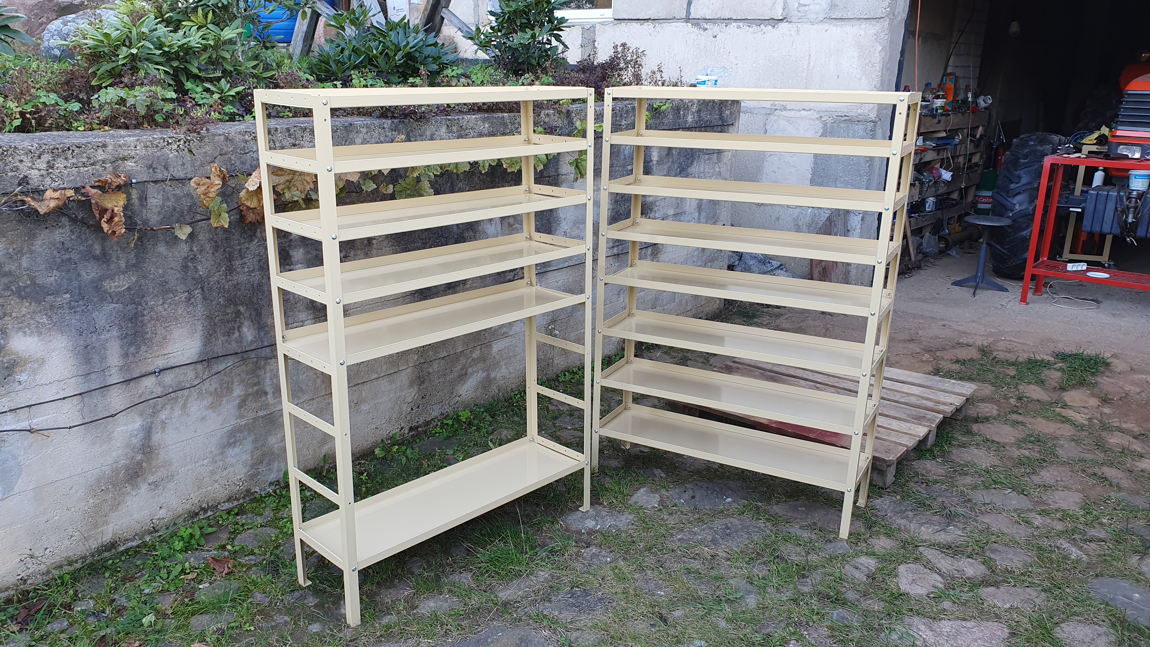

I didn’t want to start a new topic to share what I did this year, so I’ll stick here if no one objects.
I've started this work in the early spring, when the first pandemic lockdown was announced in the country. I finished it recently, within the second lockdown. When I realized that I could no longer live without these things, I took on these jobs. And that’s what came out of it. The biggest problem still remains - to accommodate the most necessary items and discard the unnecessary ones. Some of them, though unused, it’s still hard to throw away. But it is necessary.
Here is a video about how it was done.

   / My Lumber and Plywood Cart #25
Very nice!!! I have a shelving unit similar to your tall one with all the shelves, but it has wheels on it, and that's very handy. I like being able to move it out of the way when I need the floor space, or I can have stuff on shelves behind it, and it's easy to move when I want to get to those things.
   / My Lumber and Plywood Cart #26
If it concernes me, that would be possibe if I wouldn't keep heavy stuff in the shelves, for instance steel profiles. OTOH the depth of them is only 1 feet, what means might be unstable.
But your idea of wheels is good if once I'll decide to stick them together by their backs.

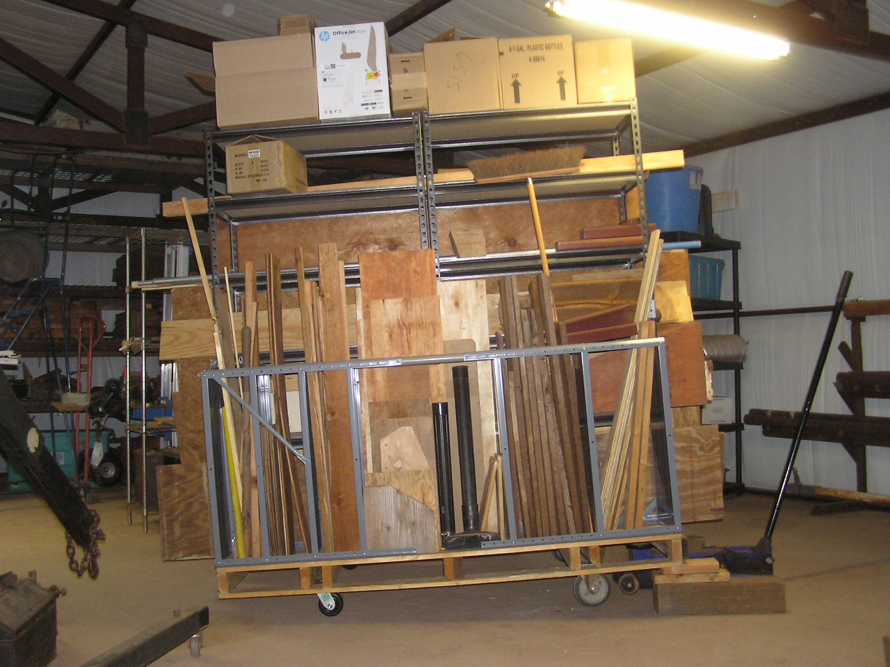

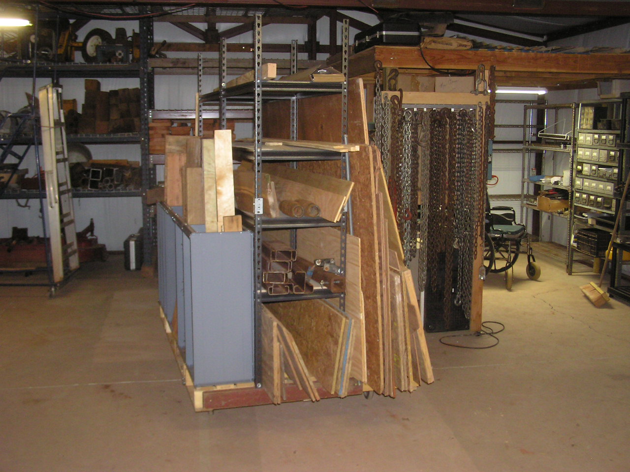

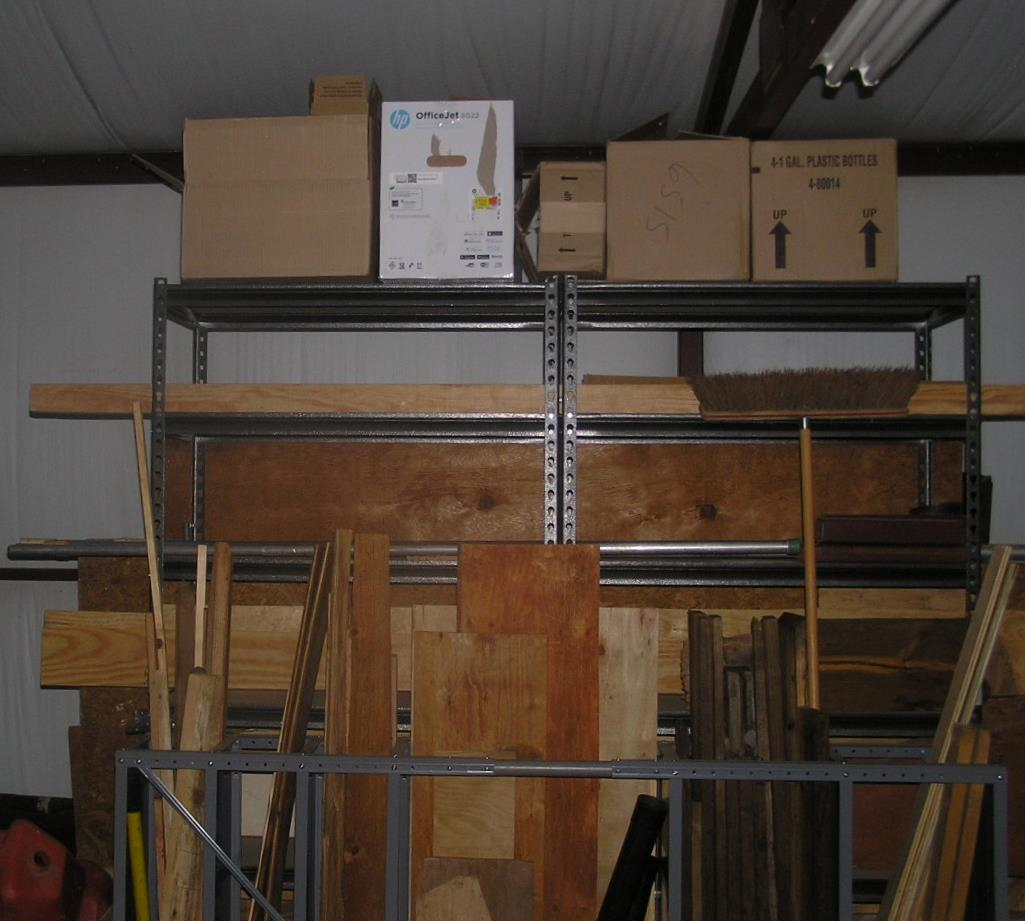

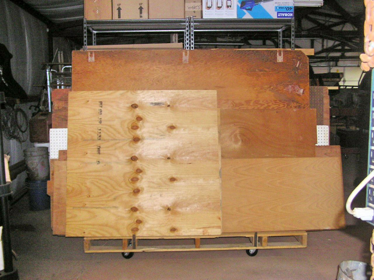

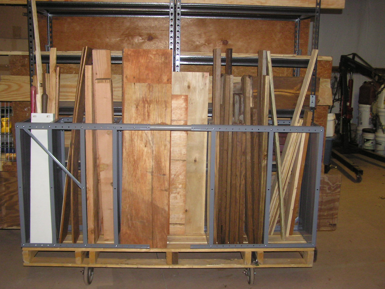

Still have one set of shelves, need to decide if I want them at the top or in the bottom section.
Decided not to use the last set of shelves for now. I can install them later if needed. So it is finished for now. (y)
Changed my mind, put the last set of shelves on top to store empty boxes on:

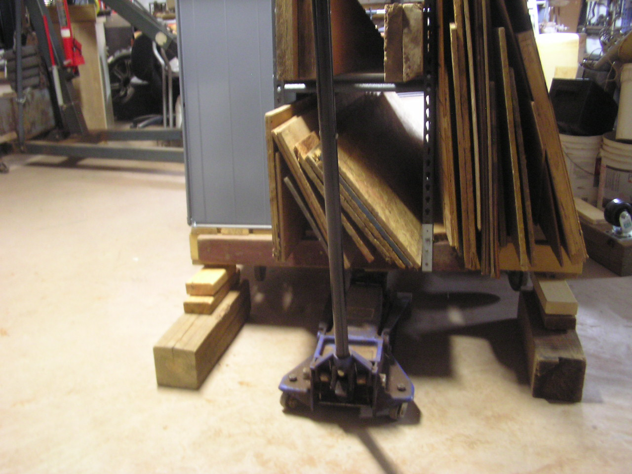

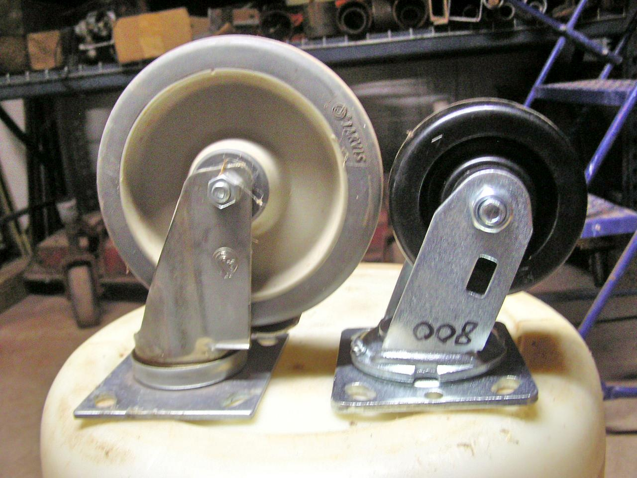

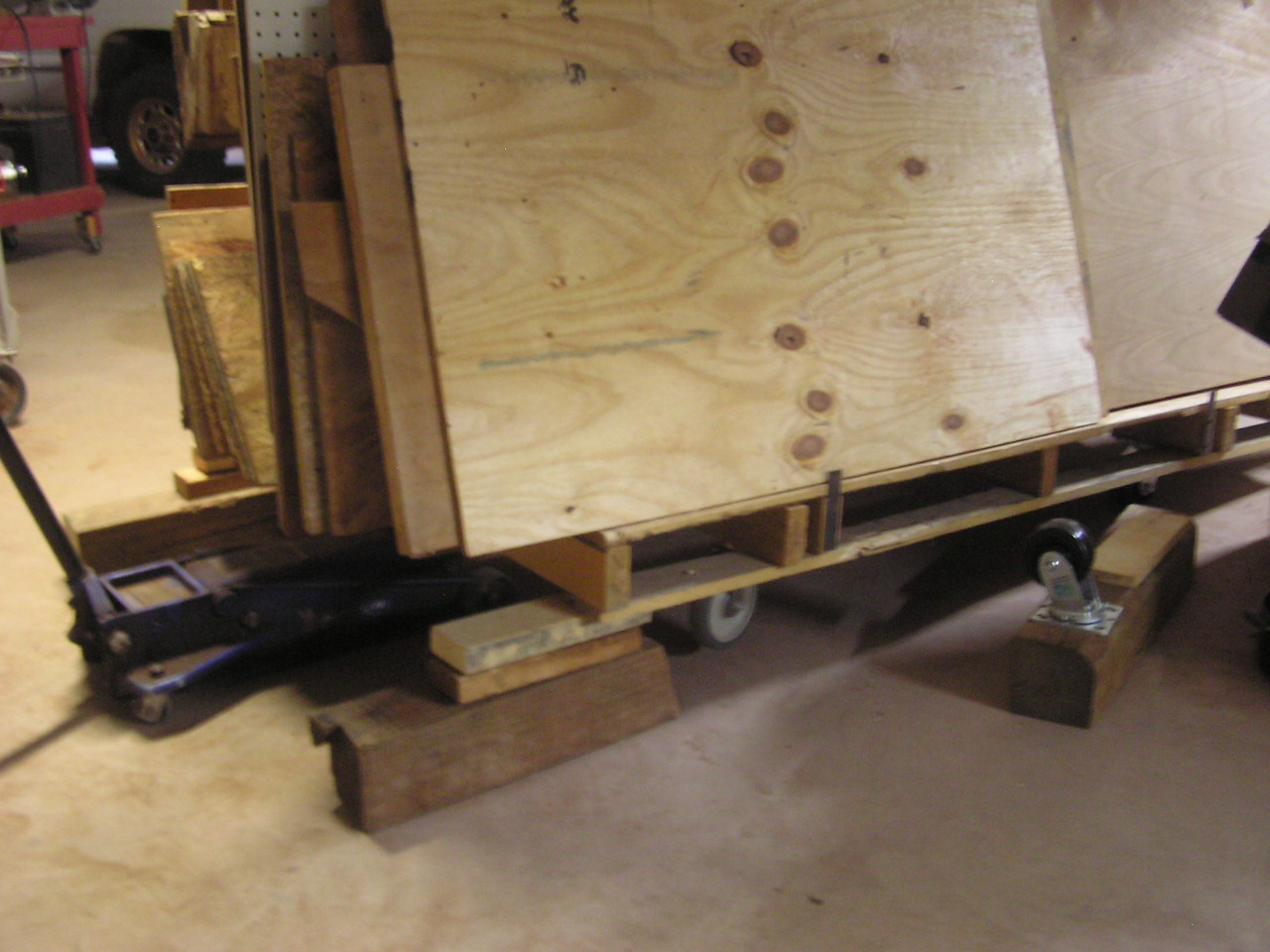

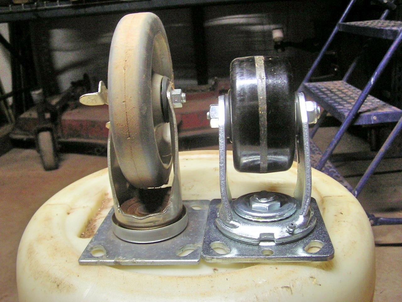

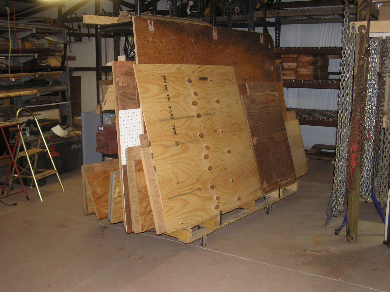

Decided to upgrade the casters to a higher weight rating. Went from 6"x1-1/4", 300 pound rating to 4"x2", 800 pound rating for each castor:
The mounting plate hole spacing is the same, so that made it easy.
Jacked up one end at a time and changed the casters:
It even rolls easier now:
