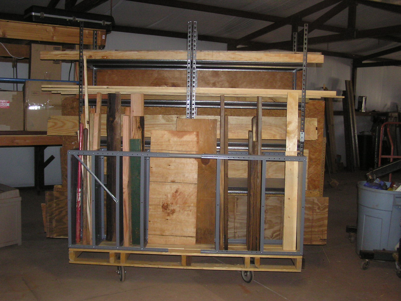

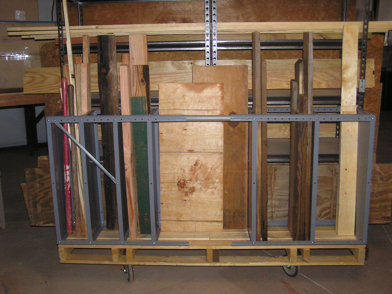

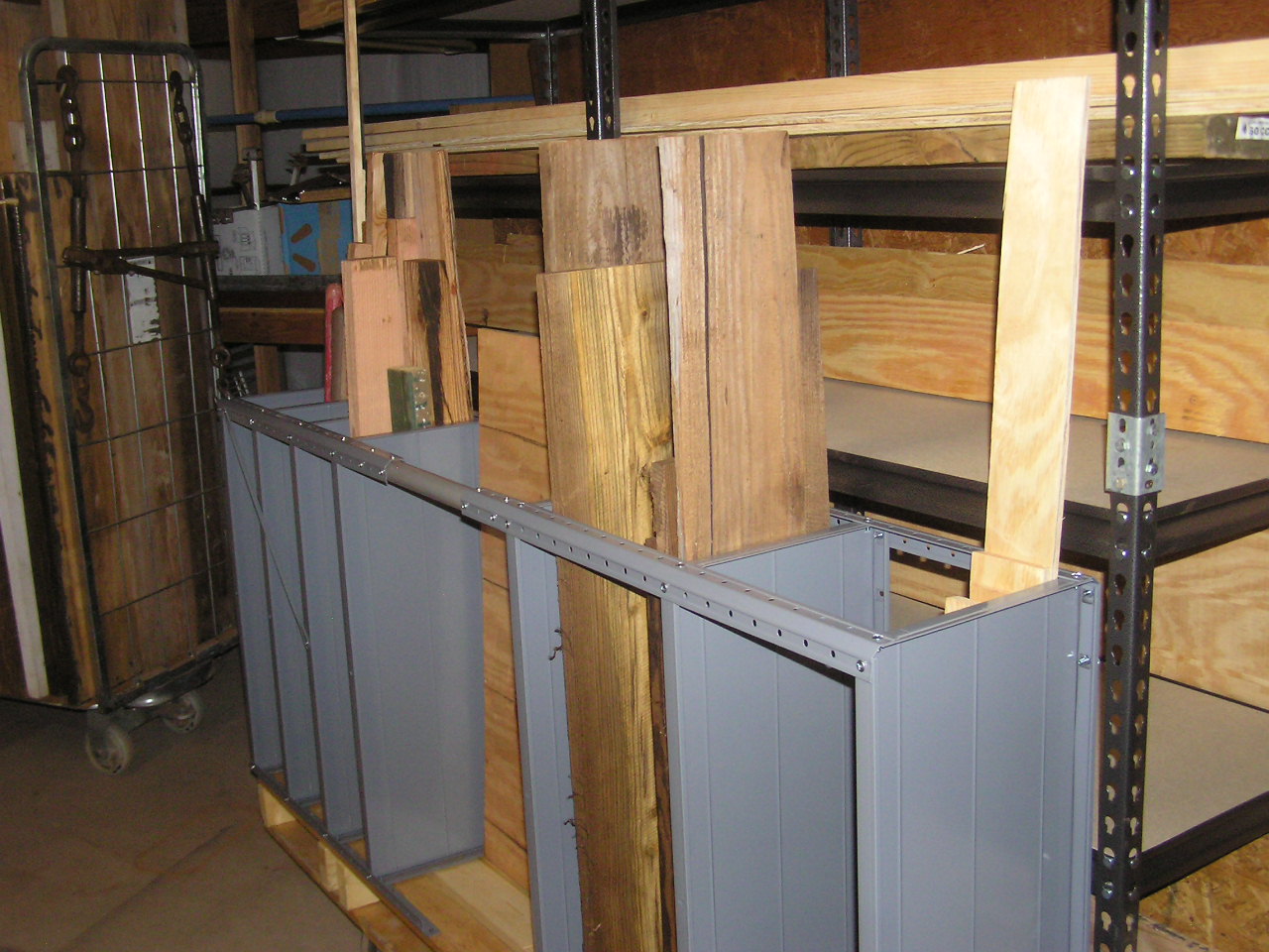

Thanks for the pictures. I wasn't understanding how you where going to use the shelves. I really like it. I currently keep my scraps in different places. 2x's are out under the lean to, good wood is leaning against the end of my work bench and plywood is behind my upright freezer. This is really smart!!!!
   / My Lumber and Plywood Cart #12
I like it! thanks for taking the time to show all the details.
#13
Thanks, guys. Hope it inspires some copycat builds.
Put some more stuff in the shelves:
This shows the overall height of 6' 11" to the top of the shelf legs:
   / My Lumber and Plywood Cart #14

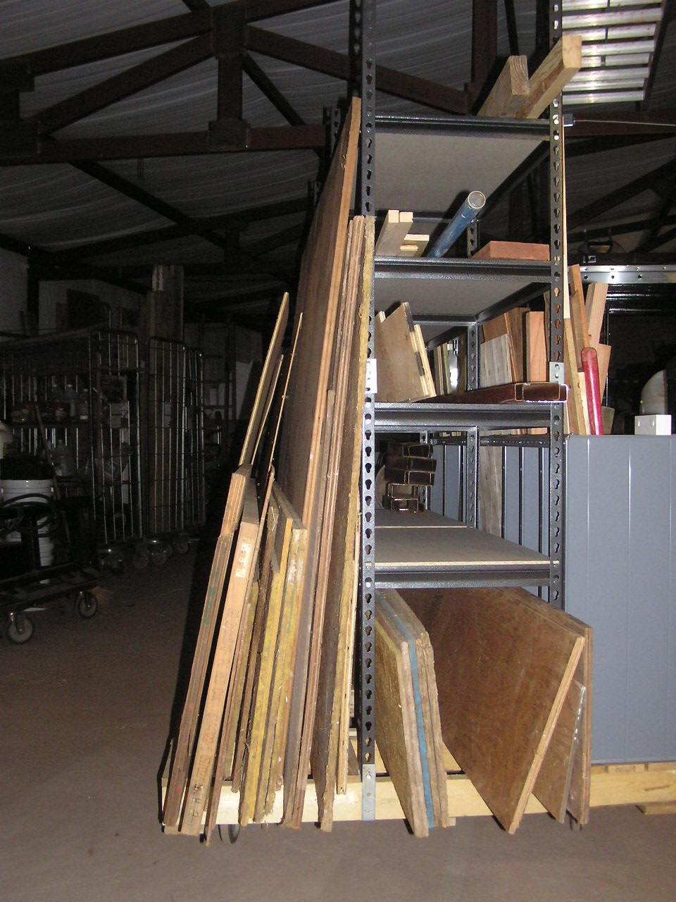

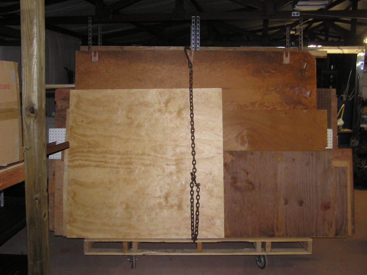

The idea is great. Built one for myself not too long ago. My lesson learned though is to be careful as to how you load your cart. Too many sheets of plywood on the back side and not so much lumber on the front and you will find that it flips over backwards VERY easy. BT-DT
Moving the casters as far outboard as possible does help with the stability. Mine are near the edge already and I'm thinking that I might even add some out-riggers for them.

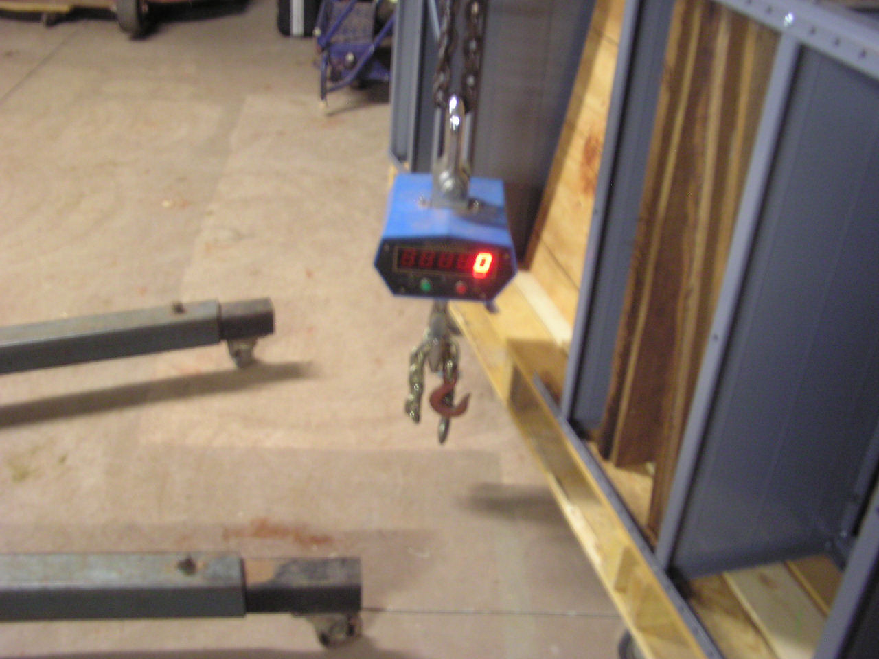

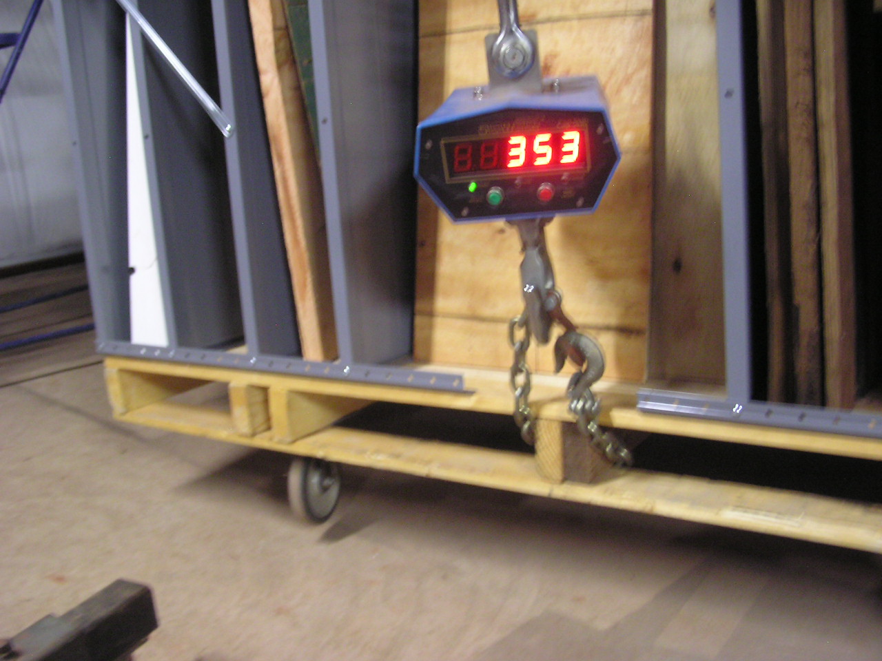

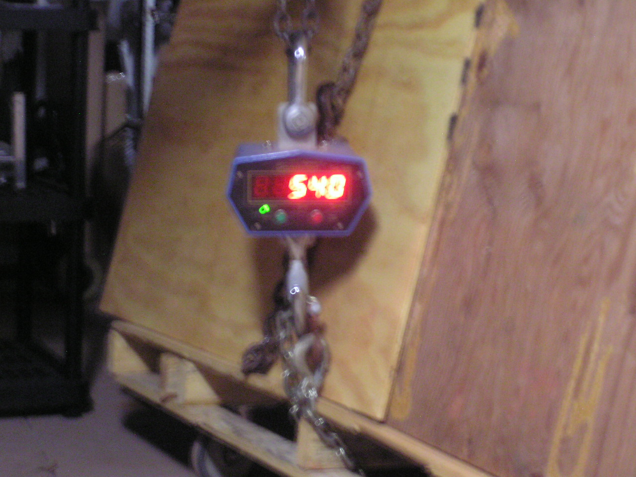

Thanks for the info. I think mine is pretty stable being that it is 4 feet wide and the casters are near the edge. But I wondered how much weight was on the lumber side, so I got out the scale.
First I hung a chain on the plywood side to hold them on when lifting the other side:
Zeroed the scale with the lifting chain on it:
353 pounds raised it off of the floor:
Plywood side weighs 540 pounds:

That's a lot more weight then I expected!!!!
I should have taken the chain off before I weighed the plywood side of the cart. But there is a lot of wood on there. :eek:
That 8' solid core door is heavy. The 4x8 sheet of OSB is probably 80 pounds, the 3/4 plywood next to it about 70 pounds The 5x7 sheet could be close to 100 pounds. There are several narrow pieces of OSB.
I should have weighed the cart before I loaded it, but I ain't unloading it now to see how much it weighs :irked:.

I built one similar to the A frame plywood design you posted a pic of. Not proud of it after putting it into use. I need to junk it and do better. It is not stable enough and the casters didn't roll smoothly if there were debris on the floor. I wanted a slim one due to floorspace reasons, but I quickly overloaded it just with 3/4in oak and maple veneer plywood and a bunch of cut offs. I put larger pneumatic tires on it instead of casters, and gained some ground clearance. With that ground clearance I made a rack underneath for metal lengths thinking it might help stabilize it (lower the CG). The HF tires wouldn't hold the air over time and they developed permanent set.
