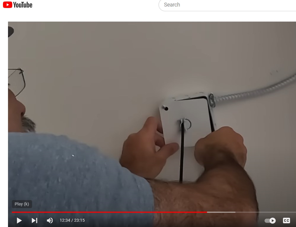

Saw this in your video:
That clamp is not correct for the cord and will probably eventually cut through and short it out. Yeah it will take years, most likely, but I've seen it. The good news is you only need to swap it out for a different type of fitting:
There are different sizes of these so you need to measure the diameter of the cord first, and also get the right size for the knockout in the box cover plate (1/2" or 3/4"). Odds are, the one I linked is the right size for you, but you need to verify. There are even more serious styles of support/strain relief for pendant cords but those are for bigger, heavier cords. The load on this is very light as the fixture is probably only a few ounces or so, so this style should be sufficient.

Thank you. I didn’t know they had these. I am ordering 6 and will replace the ones for the kitchen lights as well.
