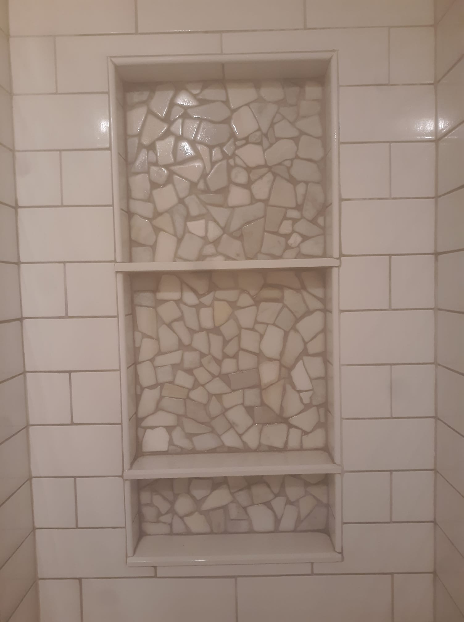

This is the ugly shower that I did last week. I hate white subway tile with grey grout, but my clients all love it!! 211191110_10226234683756218_3843669528386686841_n.jpg

This is the ugly shower that I did last week. I hate white subway tile with grey grout, but my clients all love it!!View attachment 704915
That is great work.
Sorry - but I like how it looks!

Btw I like the way that shower turned out with the niche. I will be trying a similar look, using a schleuter (sp) kit.
