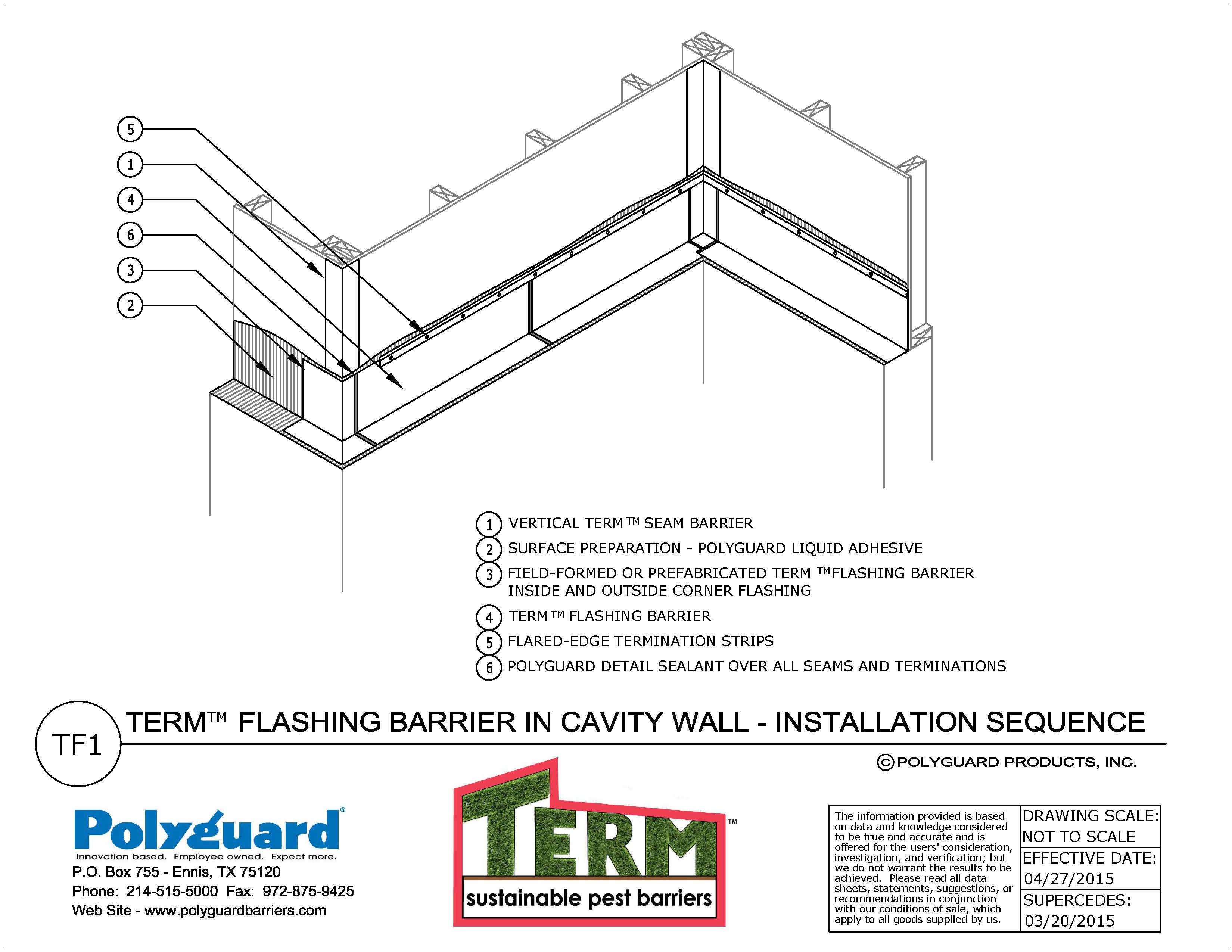

You are doing good at sealing it up. Did you add metal flashing to the bottom of your walls to keep the water from getting under your siding? You can already see the damage beginning to your OSB in your pictures where it gets wet, stays wet, and will quickly rot if allowed to remain wet.
/ My house needs a shed
#13
I originally intended to, but a combination of not being able to find rolls of flashing (it's all custom ordered to match your roof color here from what I found) and the poor condition of the driveway (meaning I thought a seal was unlikely) made me skip it.
In those images though, the dark brown is more the splatter of mud on the driveway splashing up than it is wetness. I'm fairly certain I will have to figure out some better solution to alleviate the water in this area though.
/ My house needs a shed #14
Bottom line is if your OSB stys wet, whether mud or water splash it will fail.
Can you get sheets of thin plastic to use instead of metal flashing, or some rolled metal, (in round coils) that could be used to create a custom flashing moisture barrier? Maybe even some scrap flashing that is in different colors from a local fabricator?
In the meantime I might suggest tacking up some plastic just above the 'water line' where the water /mud are evident in your pics, and holding it in place at grade with rocks or bricks or something to allow moisture to escape until you can seal the area permanently. Water is not your friend when it comes to OSB/plywood.
