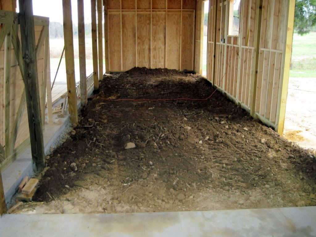

Step 11: Stall footing

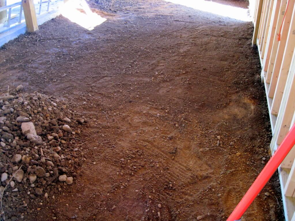

The combination of concrete and the crushed rock base under it make the aisleway floor a full 8" higher than grade. To make up most of that height difference in the horse stalls, I had to bring in a few inches of dirt to be topped off with 4-5" of rock screenings. The screenings make a really good base for the stalls. The material compacts very well when it's wet and provides a nice stable surface for the stall mats to sit on, but isn't as hard and unforgiving as concrete. (Picture really good sand-castle sand, but the grains are sharp-edged, rather than rounded, so they stay locked together even after they dry). Plus, it is permeable enough to drain whatever urine happens to get through the bedding (wood shavings) and stall mats.
Pending all of this work, I left the walls off the north side of the barn so that I could still drive in with the tractor to dump the various material in the stalls. It was about 20 tons in all, and I definitely didn't want to have to do it with a shovel and a wheelbarrow! My 50HP tractor with a 6' bucket can't possibly make the turn into the 8' opening to the stalls from a 12' aisleway, so my only option was to leave the exterior walls off until the floors were done.
In retrospect, I should have paid for a dumptruck load of clean fill (which would be rock-free red clay around here) for the first few inches. However, wanting to save money I decided to "harvest" the dirt from a location nearby the barn. It's still good compactable clay, but unlike the dirt I could have bought, it was absolutely FILLED with rocks, not to mention lots of kudzu roots and, as it turns out, a very cold baby snake. :)
To make matters worse, right after I got the dirt dumped in the stalls, we got 6" of snow. With no north walls on the barn, the snow blew in and covered all the dirt, then spent the following week melting and turning the clay into a rock-filled muddy mess. If you've never experienced this Carolina clay, let me explain a little about it. When it's wet, if you take one step in it, you'll have an inch of clay stuck to the bottom of your boot. If you take six steps in it, you'll have six inches stuck to the bottoms of your boots. :) It's pretty incredible stuff. Anyway, needless to say, it's absolutely impossible to rake rocks and roots out of the stuff when it's wet.
Eventually, things melted and dried out enough for me to rake (and rake and rake and rake), interrupted occasionally by some cursing and self-kicking for not buying the dirt instead, until eventually I got most of the rocks out. Then it was a matter of dumping, spreading, and screeding the screenings, which was still a lot of work, but much easier than the clay. The last step (which I still have yet to do) is to compact the screenings and re-screed to get a final hard, flat surface.
Here are some pics:
First, a pic of the freshly dumped dirt (pre-snow).
After some raking. (This is the south side of the barn, so there had been a lot less snow on this side). I ended up removing 3 full 6' bucketloads of rocks from these three stalls alone, plus a bunch more that I raked directly out the side doors.

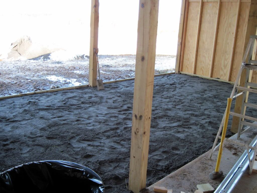

Screenings in the north side of the barn, along with one of my "helpers".
Screenings in the north side of the barn.

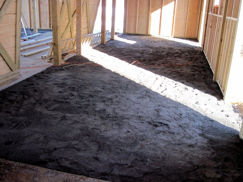

Another shot of the south side.

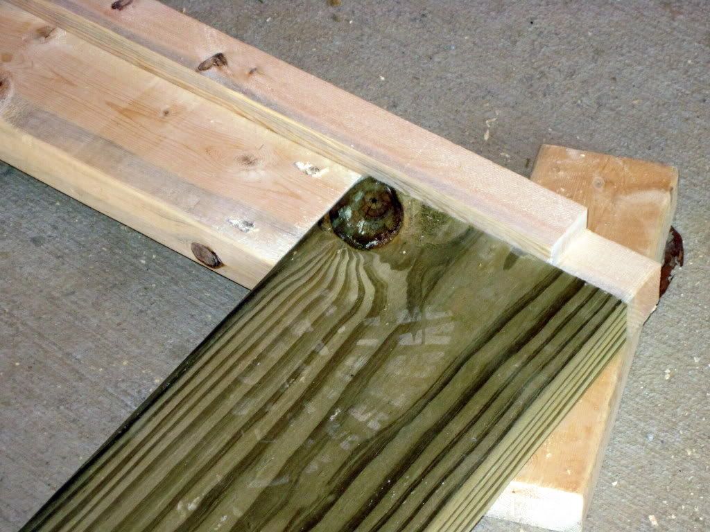

Step 12: Sliding Doors

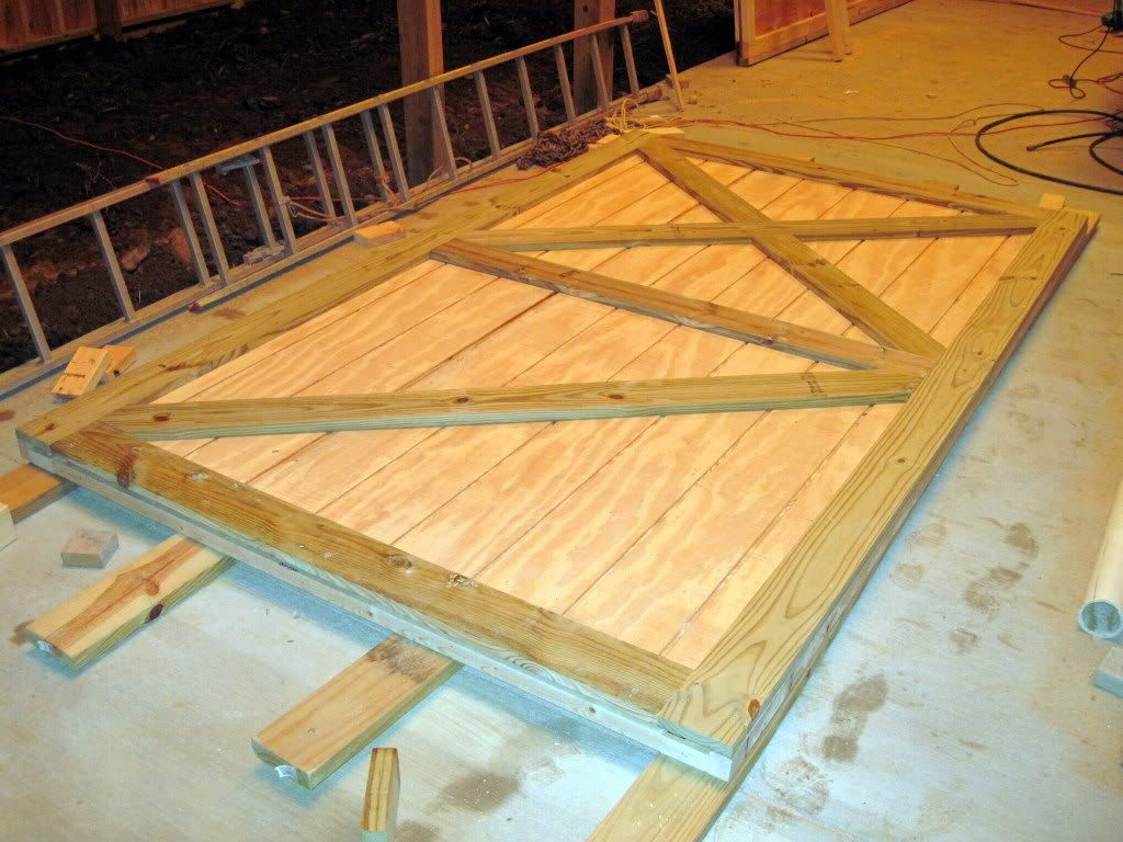

I designed the barn to have three sets of sliding doors - one pair on each gable end and an additional pair on the side of the barn at the wash rack. The end doors are 6' wide and 10' high each. The wash rack doors are slightly smaller, 4'8" x 9'8".

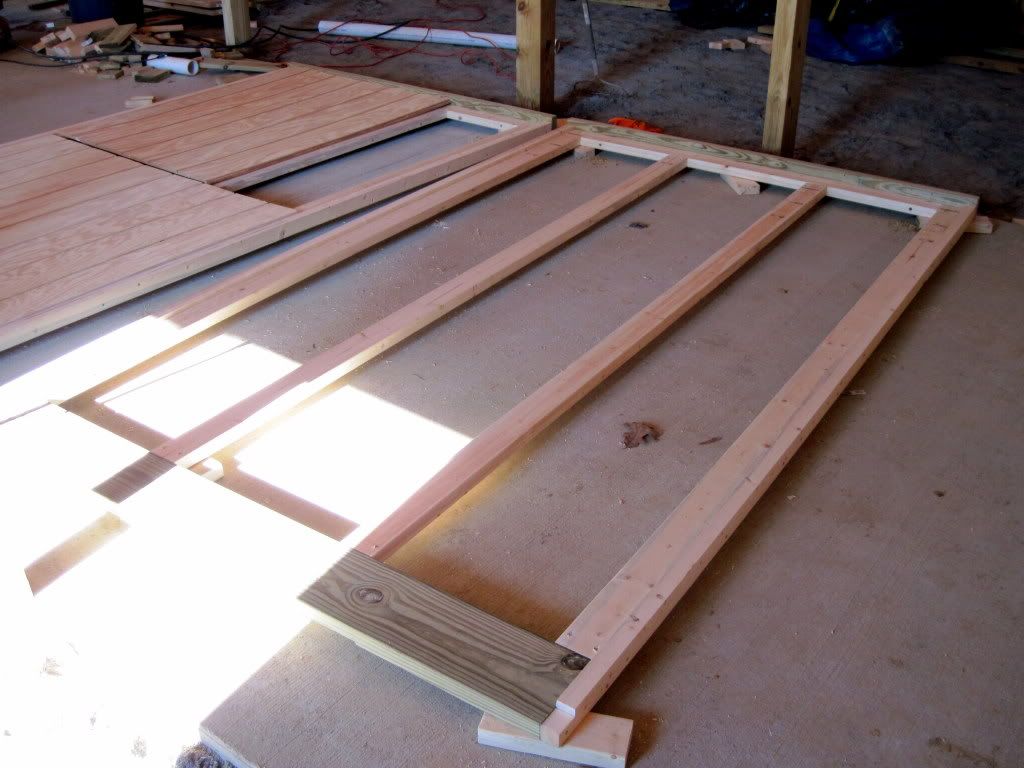

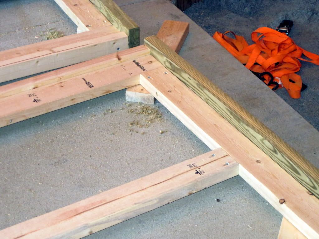

The basic design for all of the doors is the same and relatively simple. It starts with a frame of 2x4's on the flat, with the bottom member being a 2x8 on the flat. This provides a "skeleton" for the door which is 1.5" thick. I then attach an additional 2x4, ripped down to 2 1/8" wide, on edge along each side, as well as an additional 2x4 ripped down to 3 1/8" on edge along the top. Then I apply the T1-11 "skin" to the inside skeleton. Since the T1-11 is 5/8" thick, this brings the interior of the door flush with the 2x's on the sides. Meanwhile, the 2x along the top remains 1 inch proud of the skin. Finally, I add the trim and crossbuck to the surface of the skin using 5/4x6 lumber. Since the planed 5/4 lumber is actually 1" thick, this brings the front surface flush with the top 2x member, and the resulting door is 3 1/8" thick.
The big doors, with much of their skeleton and all of the trim made from wet PT lumber, plus all of the T1-11, end up weighing in around 450 pounds. The wash rack doors are a little lighter. Hanging these suckers as a one-man operation was a bit of a head-scratcher. There was no way I was going to be able to manhandle them into place by myself, so I had to come up with a way to do it with the tractor. If you haven't seen it, my solution was posted here: http://www.tractorbynet.com/forums/projects/160852-how-hang-450-pound-barn.html
At this point, all of the doors are built and all but one set of gable doors is hung.
Here are the pics:
The skeleton, including the 2x's on edge on the sides and top.
A close-up of the top.
A close-up of the bottom.
The skin applied to the skeleton.
Applying the trim.
Continuing the crossbuck.

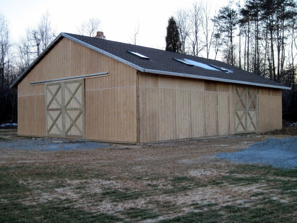

One set of gable doors in place.

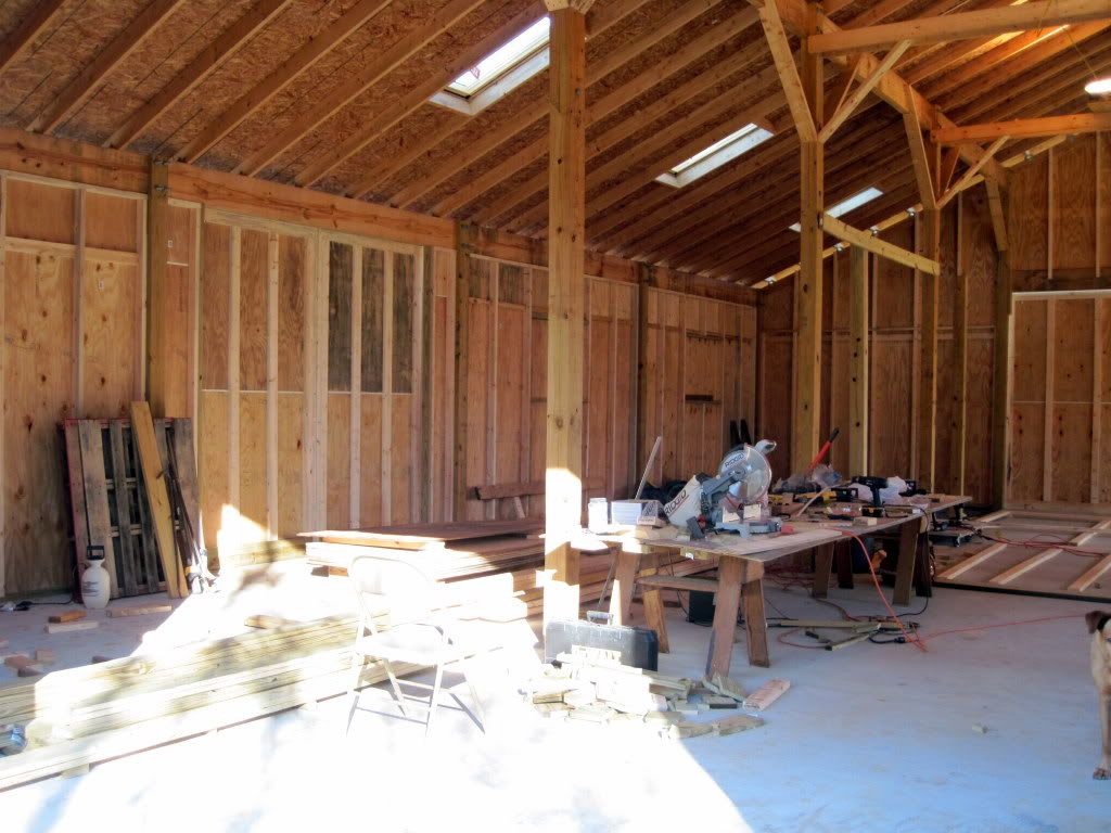

The inside of the barn with the north wall finally closed in and doors on the north and west walls.
The view from outside with all of the doors closed up blocking the wind.

Could you explain the sidewall construction? I've not seen it done like that with the bottom at 12" on
center and the top appears at 24". ( First picture )
Horses kicking?
   / My Horse Barn in Progress
#56
Horses kicking?
You got it! On the south side of the barn there will be paddocks so horses will have unsupervised direct access to those walls from the outside. Having studs 12" OC for the bottom 4' should minimize the chances of them kicking through the T1-11. The inside walls of all the stalls will be T&G 2x6's, so kicking through from the inside is a non-issue. That's why, as you may have noticed, I didn't bother with the 12" OC studs on the north wall or the gable ends - just the wall where they'll have unsupervised access to the outside.
