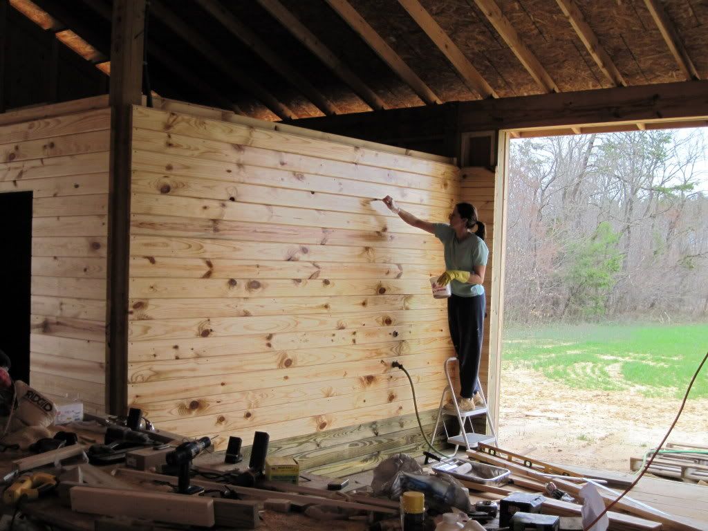

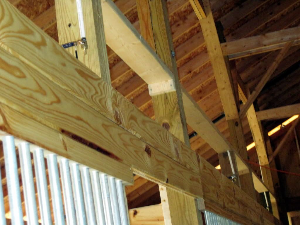

Did you mill your T&G yourself? Looks like 6/4 pine #1? If you milled it,what tools did you use? Fine looking horse barn.
   / My Horse Barn in Progress
#114
I bought it from a local mill. It's actually #3, and they sell it for $0.34/lin. ft. It does have a few defects here and there, but I think it looks pretty nice all in all. It's planed out to a thickness of just under 1 1/2", so I assume it started out at 8/4.
I thought (briefly) about milling it myself, but decided against it for a number of reasons: 1) I'd have to spend a couple hundred bucks on the right cutters for my shaper; 2) My shaper is only 1 1/2 HP single phase. I'd probably want at least a 5HP 3ph shaper with a power feeder for the mile or so of lumber to be milled; 3) I don't have a good source for dry rough-cut lumber, and I didn't want to use green lumber for all the T&G. 4) Between planing and shaping, it would have been four more handling steps for each board with my setup. It was bad enough just unloading 8500 lbs of this stuff off the trailer and cutting each board to length!
On the plus side, if I'd milled it all myself, I probably wouldn't have to buy shavings for the horse stalls for at least a year. :D

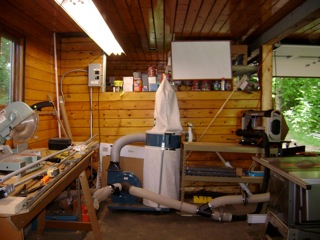

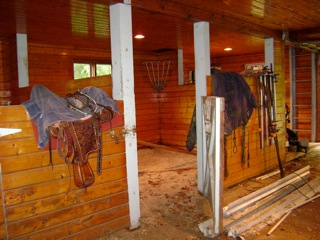

And here I am making a horse barn into a workshop.
Before: (note the PO's saddle and hay drop/holder from loft above)
http://www.tractorbynet.com/forums/attachment.php?attachmentid=157490&stc=1&d=1267717491
Every stall also had auto-watering bowls. Now I need to dispose of horse unique items and bury my dust collection tubes, electrical conduit and radiant heat tubing.
Work in Progress:
http://www.tractorbynet.com/forums/attachment.php?attachmentid=157491&stc=1&d=1267717491
The other half of the workshop will be for my new tractor :D Hopefully!
#119
Work in Progress:
If I wasn't a woodworker, it would pain me to see you dismantling the horse stalls, but it appears to be for a good cause. :)
Smart move to bury your dust collection tubes. It'll be nice not having to dodge pipes running up to the ceiling. Hopefully they never clogged badly enough that you can't snake 'em out!

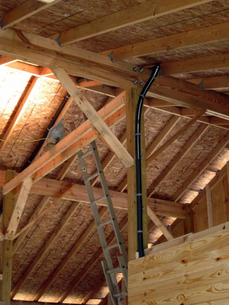

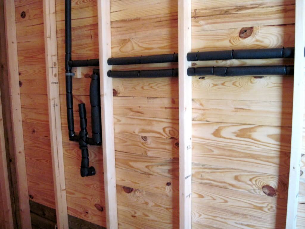

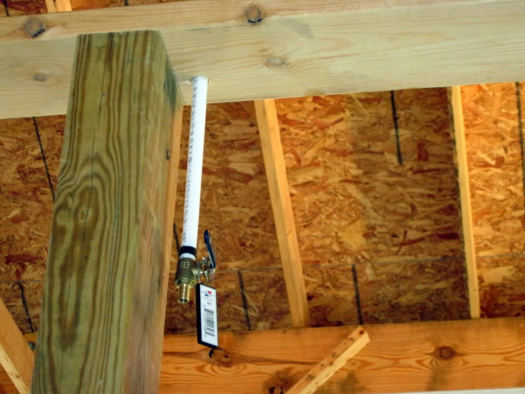

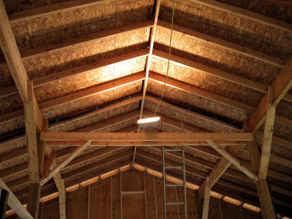

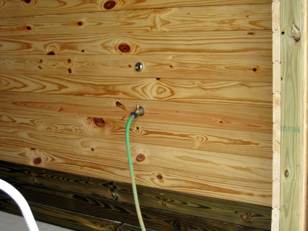

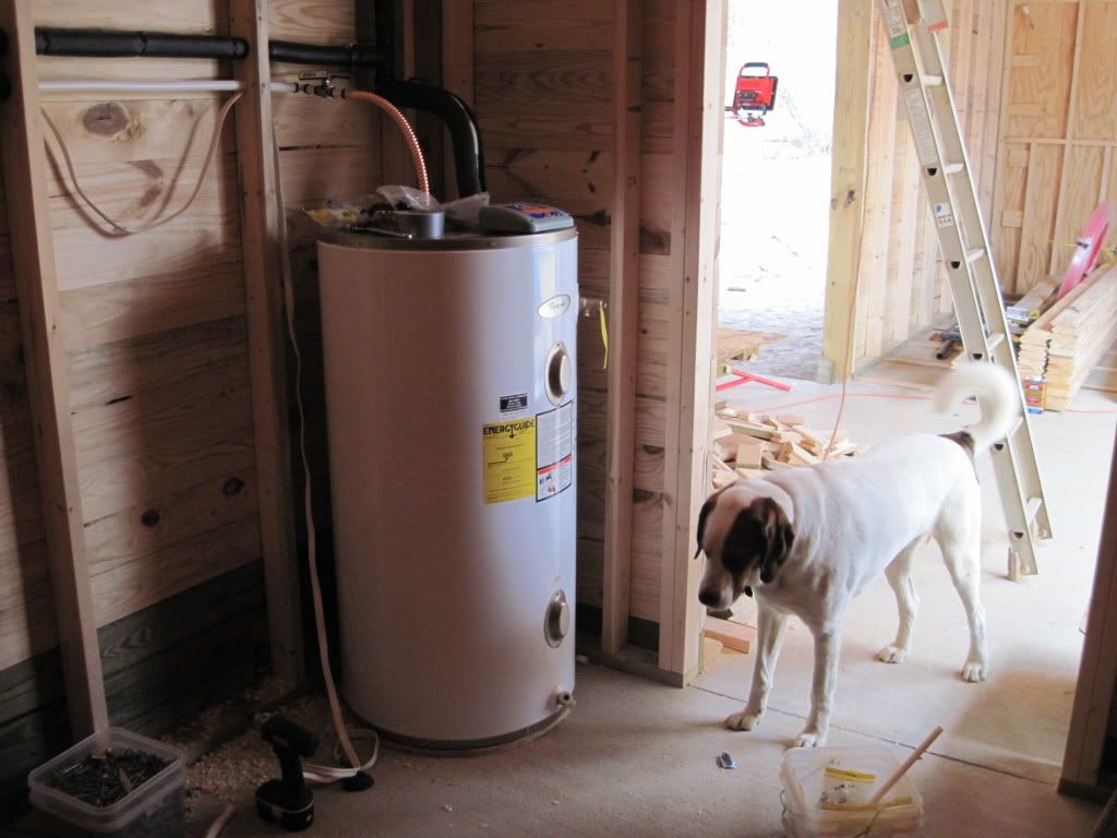

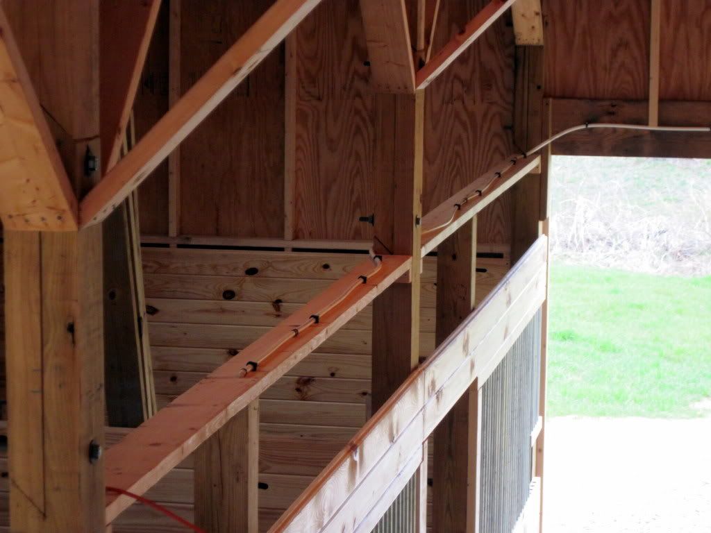

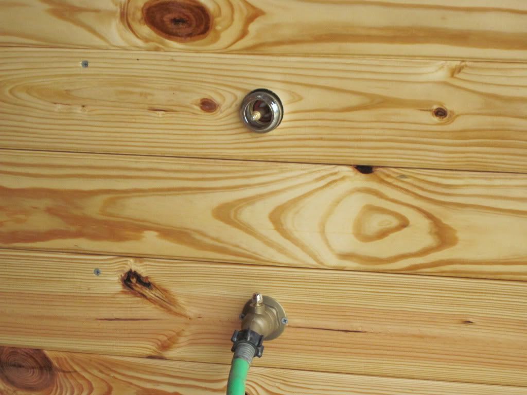

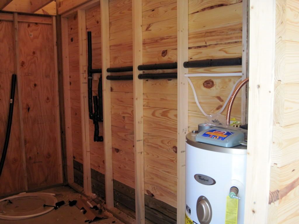

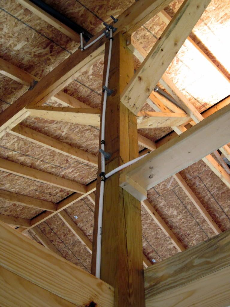

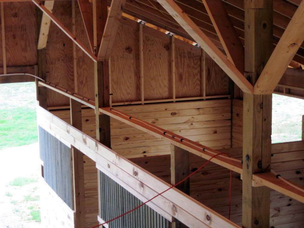

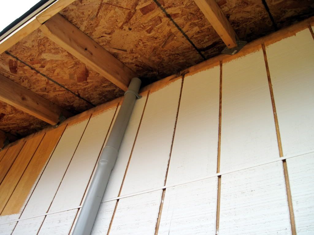

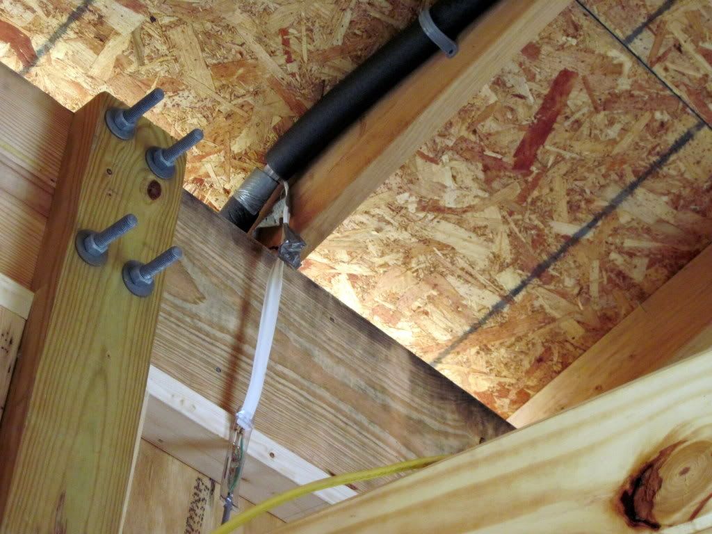

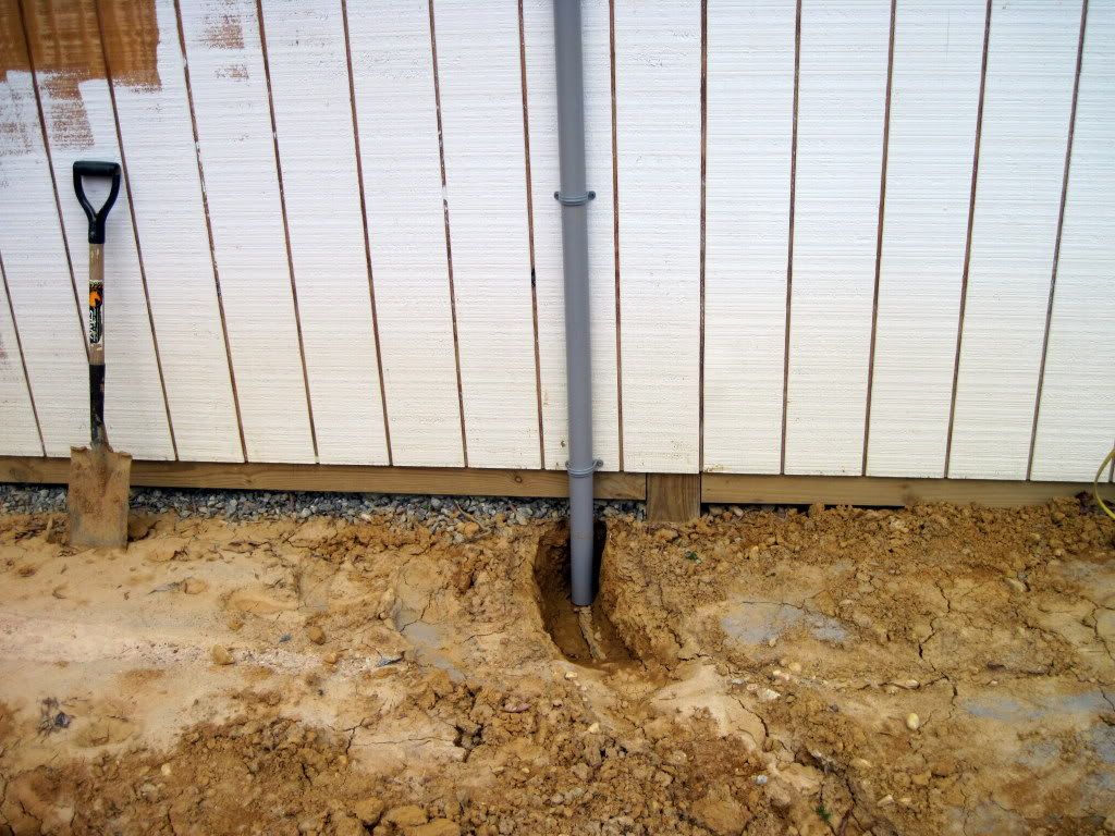

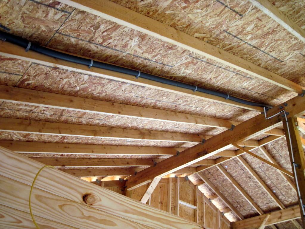

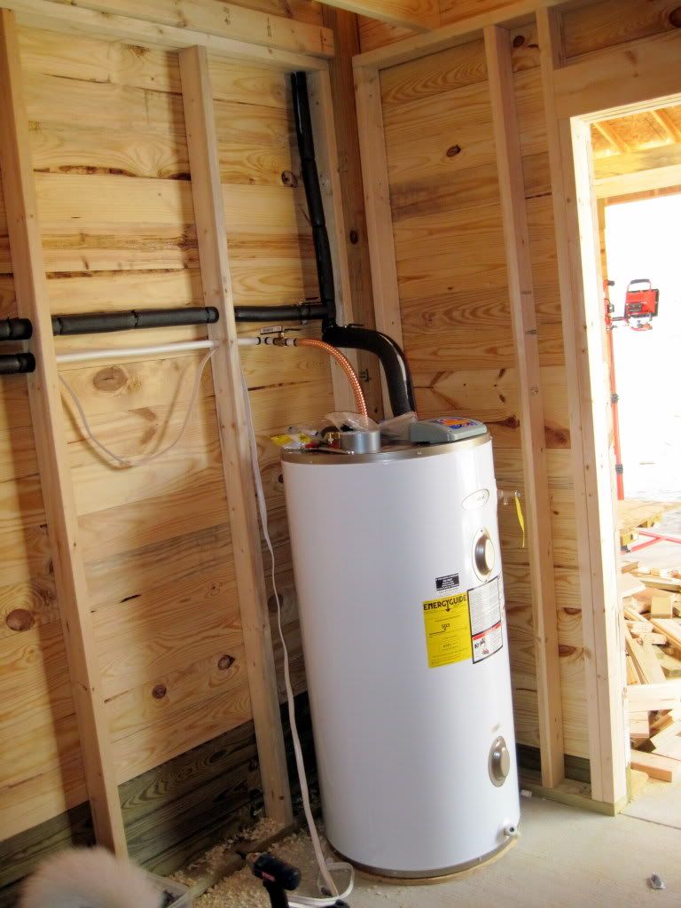

Step 15: Plumbing
I finally have running water inside the barn. And better yet, it only runs when I want it to. :) The big challenge here is freeze prevention. The barn isn't heated, so I need to take precautions to prevent freezing. In the best case, frozen pipes would mean there'd be no running water downstream from the ice-dam. In the worst case, it would mean ruptured pipes, spraying water, and wet hypothermic horses.
I'm using a two-pronged approach to mitigate the risk: First, I'm using pex everywhere inside the building, since it can stretch significantly without rupturing. Hopefully that will be enough to limit any freezing to the simple inconvenience of no running water until it thaws. Second, for all the critical runs I've wrapped the pipes with heat tape and insulation. The heat tape is 2W/ft and has a built-in thermostat that turns it on whenever the inside temp falls below 38F.
The main line (3/4" pex) comes into the barn through a conduit along the outside of the building and up through the soffit (which is yet to be installed). Once inside, the line runs up along a rafters, through the ridge pole at the peak, and back down the other side of the barn toward the tack room, where it drops down to the hot water heater. At that point, I installed ball valves and ran hot and cold lines through the tack room wall over to a shower valve in the wash rack. These lines will also supply a utility sink in the tack room, but I have yet to install it. Everything mentioned so far includes heat tape and insulation, including the conduit up the outside of the barn and the shower valve and the associated output running to a hose bib in the wash rack.
Meanwhile, back on the other side of the aisle, closer to where the water line comes in, I've teed off a 1/2" pex run that feeds all five horse stalls and (eventually) the bathroom. Each horse stall has its own cold water branch with a ball valve. These will feed automatic waterers in each stall (basically a bowl with a float valve). None of the 1/2" lines are insulated or heated, so they may freeze on particularly cold winter nights. Hopefully, between the body heat generated in the barn from the horses and the occasional water flow as they drink, freezing will be rare.
Here are some of the latest pics:
The hot water heater.
The back side of the shower valve in the wash rack.
The shower valve as seen from the wash rack. The handle and escutcheon are missing in this pic because my wife was in the process of putting polyurethane on the wall.
The lines to the horse stalls:
