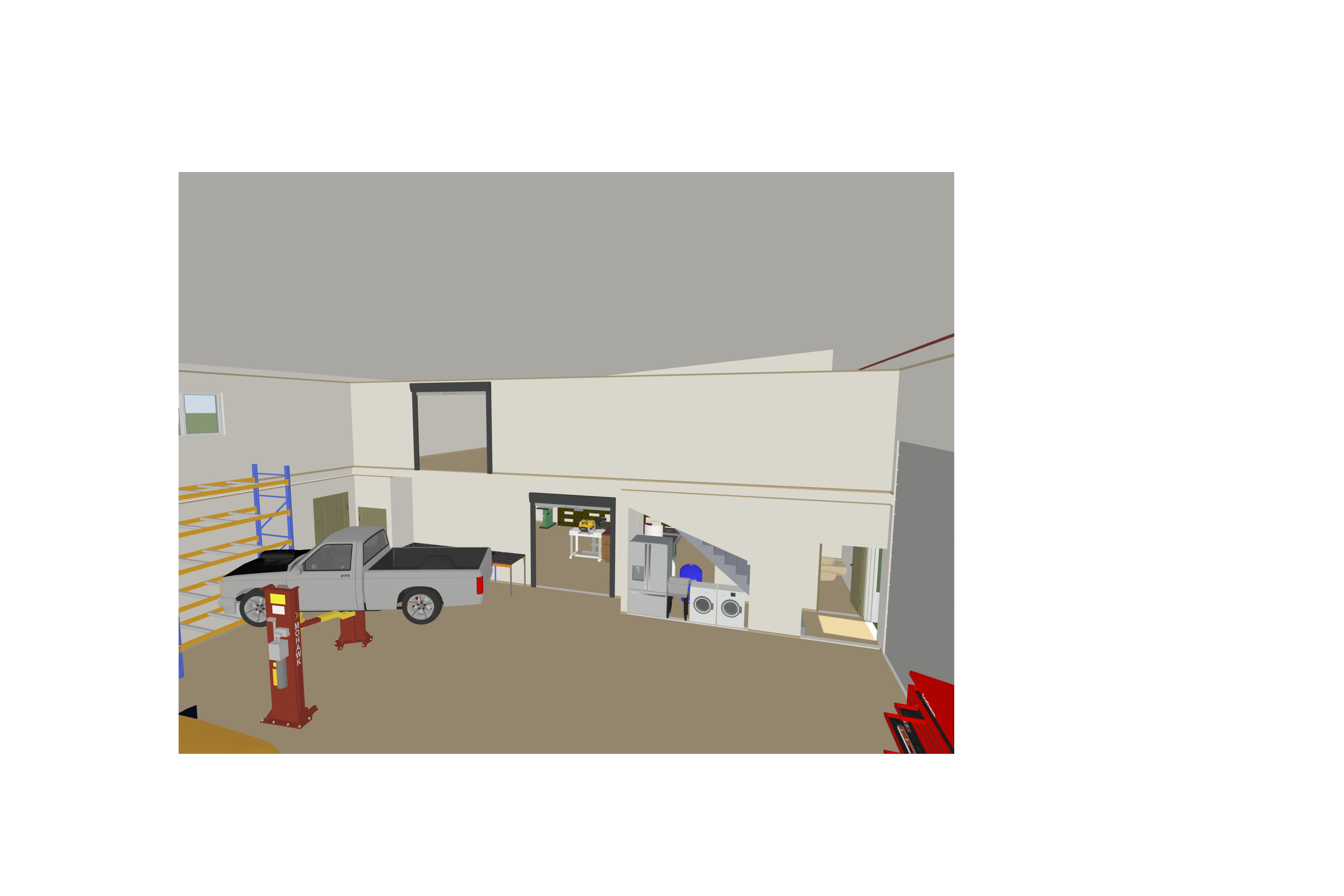

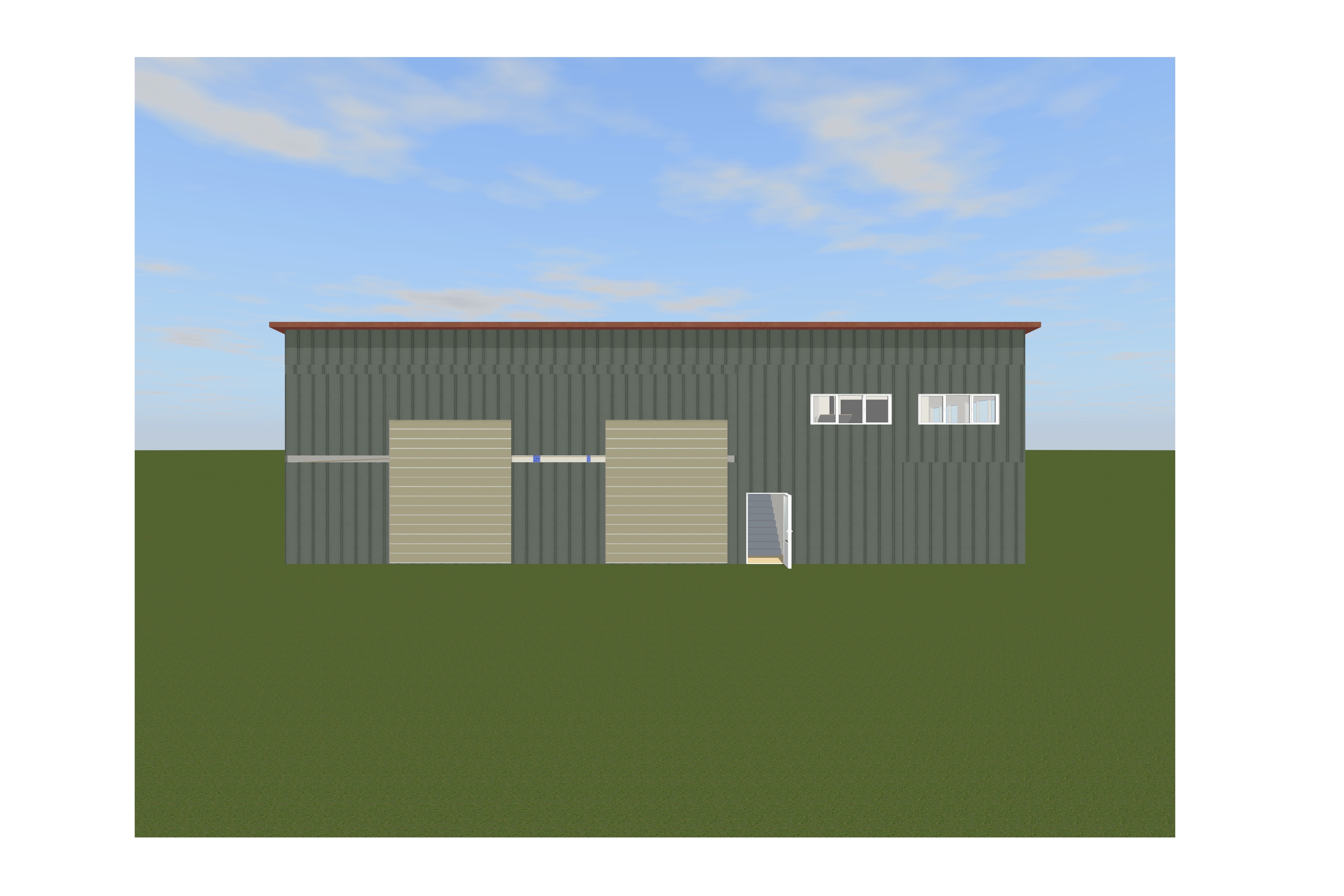

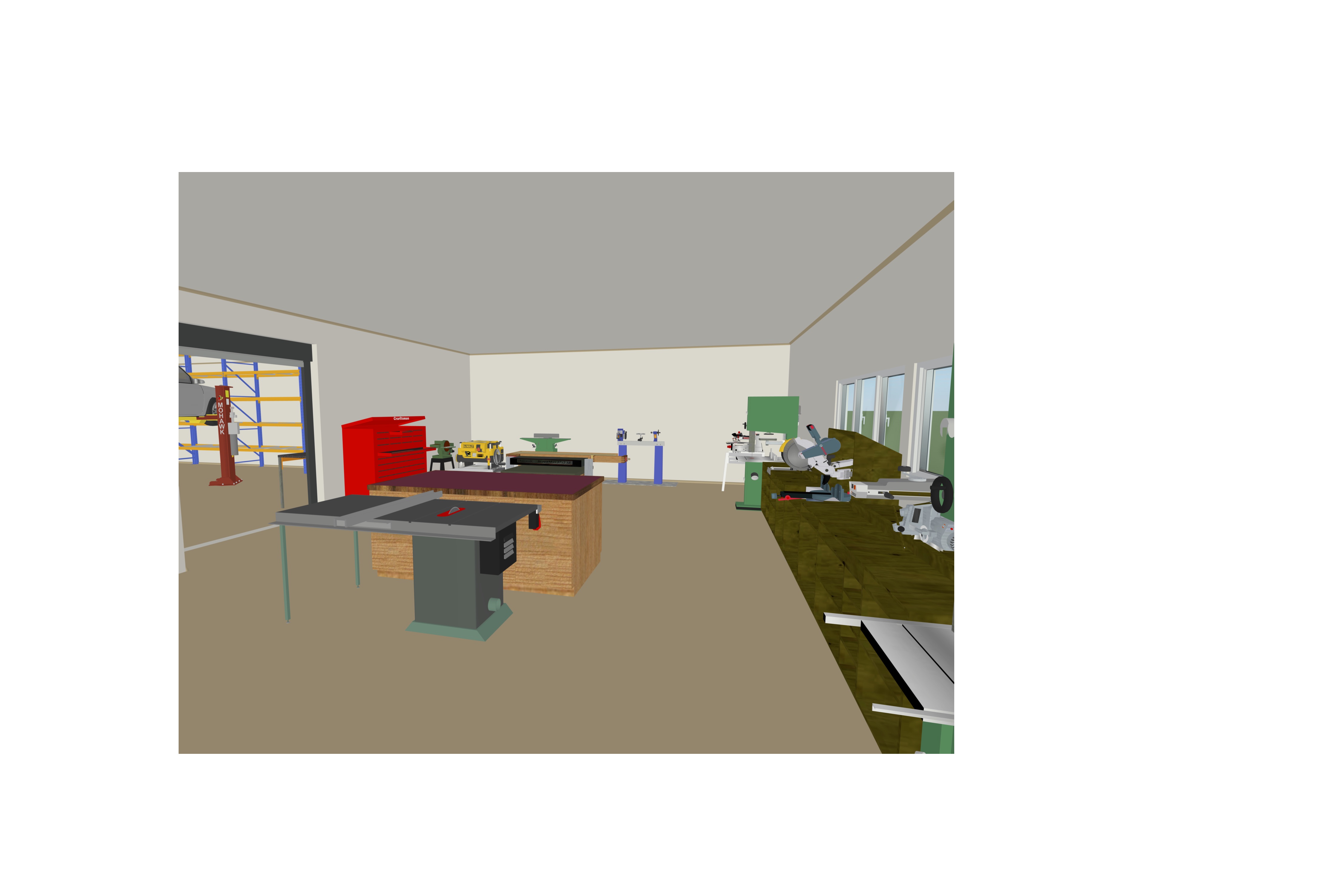

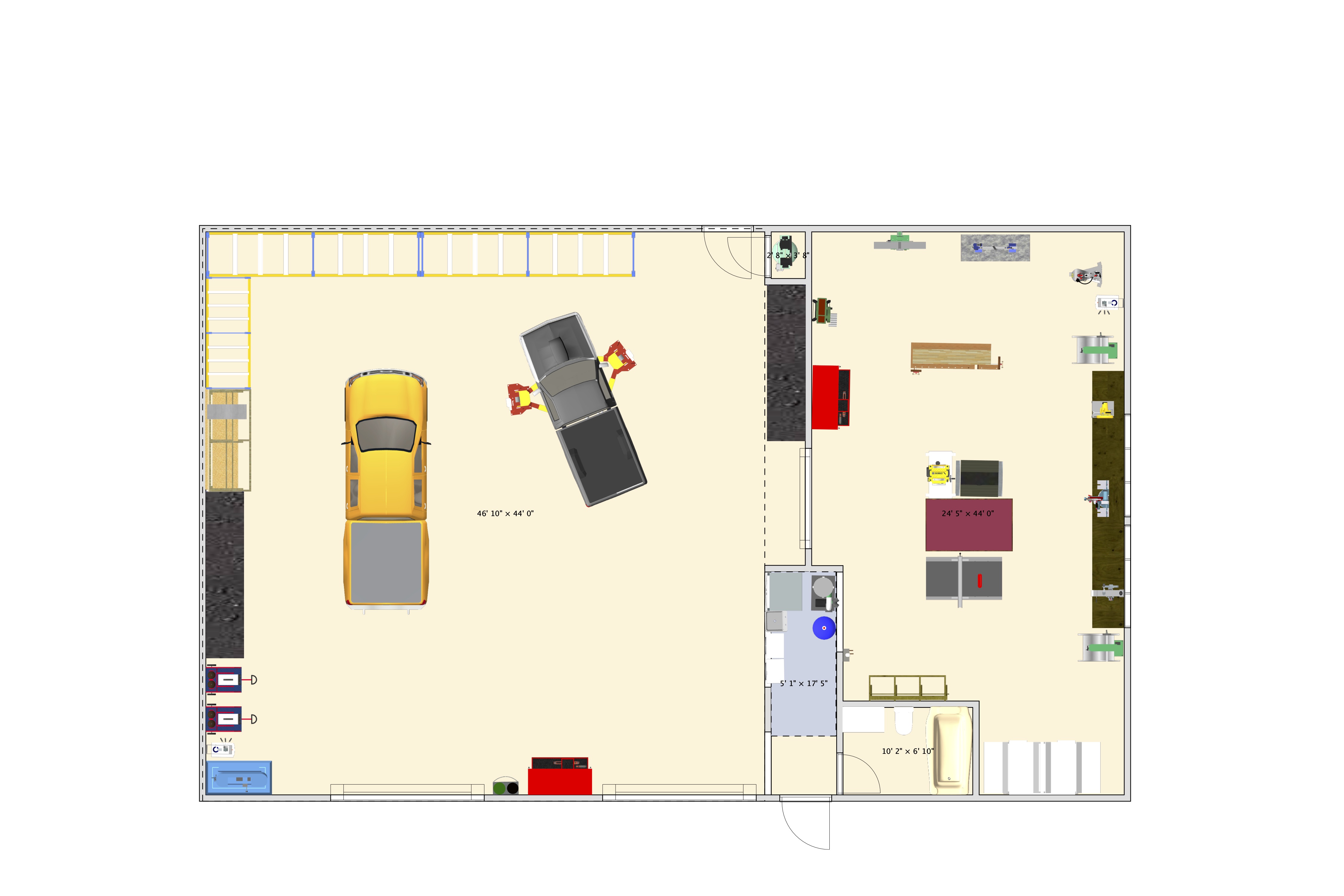

So today I am hoping to have my plans finally in hand so I can go get my permit (which we have been warned is a minimum of 6 weeks). So I took the 9 hours of flying time I had coming back from Morrocco and decided to whip up a game plan for my shop.
A bunch of notes.... It s a dream draft. I can't afford a lot of what is in the picture but things like the car lift I need to plan for in the future. It isn't very big at the end of the day (no shop is I guess). so want to be smart about placing things. I am still new at this graphics program so excuse the glitches.
I am not sure the stairs are correct. I think they are not (as floor to floor is 11 feet (10 ft ceilings on the wood shop). If that is thecase I may be kinda screwed upstairs. My window positions are locked so going to to have to get creative. Oh, yes, there are two 8 foot doors upstairs and downstairs into each respective room.

whoever drew the plans for you should have the stairs figured out with the riser/tread dimensions on the plans.....thats just basic architectural information required for a permit and around here the plans will be rejected if the stair info is not on the plans......so unless you want to wait 6 weeks to find out the plans are rejected and need to be resubmitted and then have to wait another 6 weeks make sure the stairs work and all the info is on the plans.......the local building codes will have what the max riser/treads can be so again whoever drew the plans should know that info......there was a push to make 7"/11" the standard but there was a lot of backlash from the residential community so I don't think it ever took hold and it was left to the individual codes to determine based on use.......Jack

Suggest that you turn your two post lift 90 degrees to the right, with the nose of the vehicle pointing toward the corner of the room. Better use of space?
