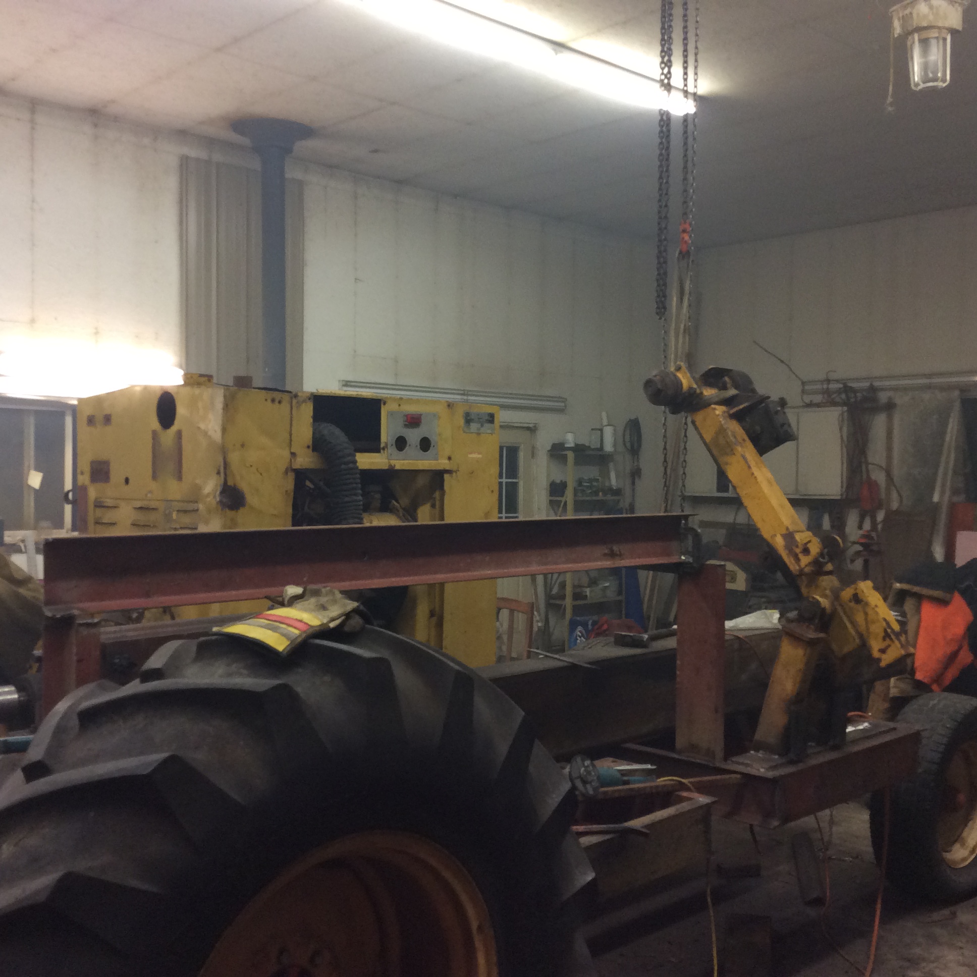

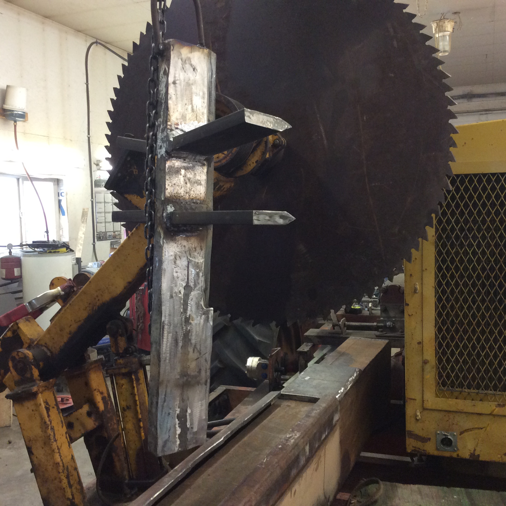

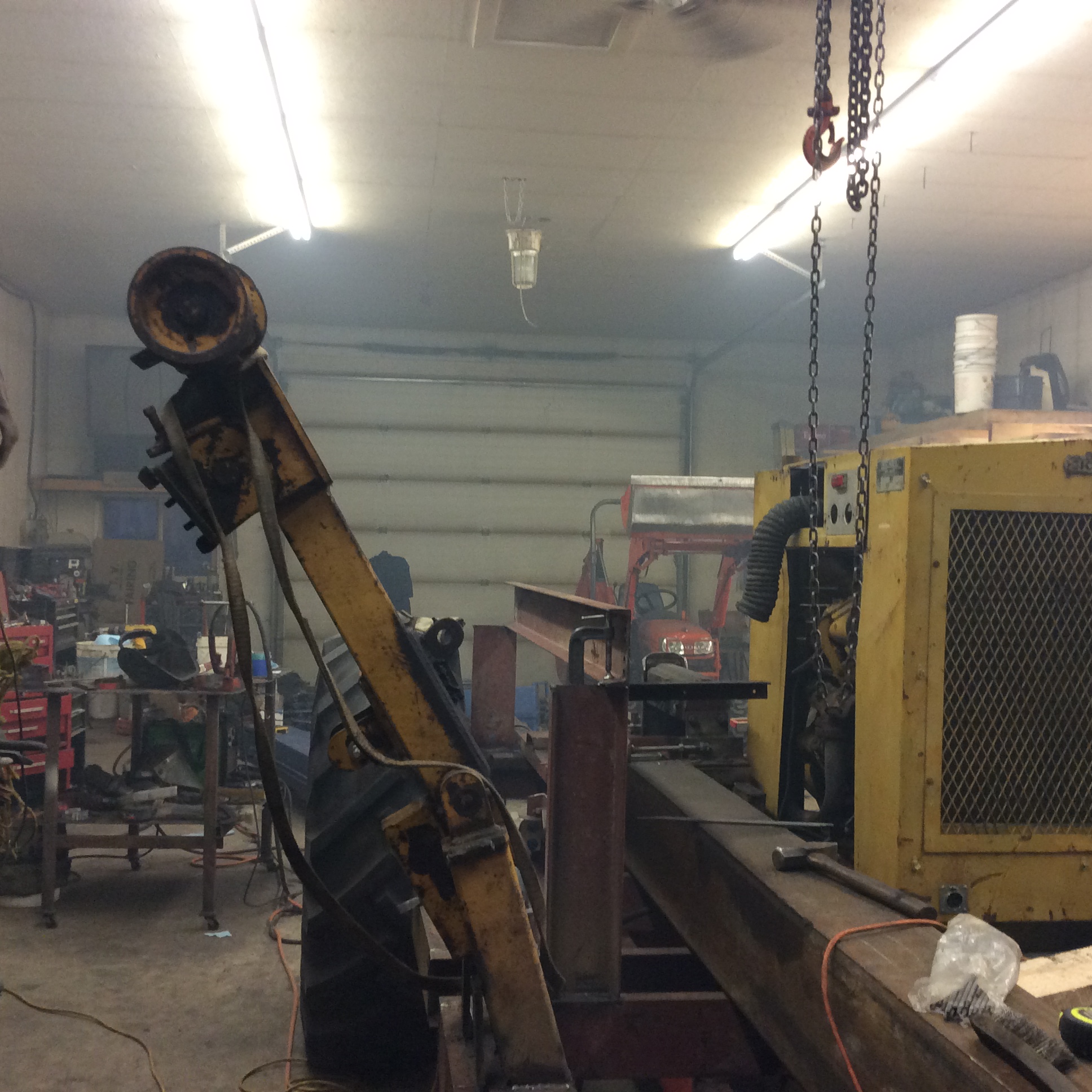

Well today I mounted the saw head and build the start of the log deck, here's a few pics,comments please
It will have a 42" saw on it

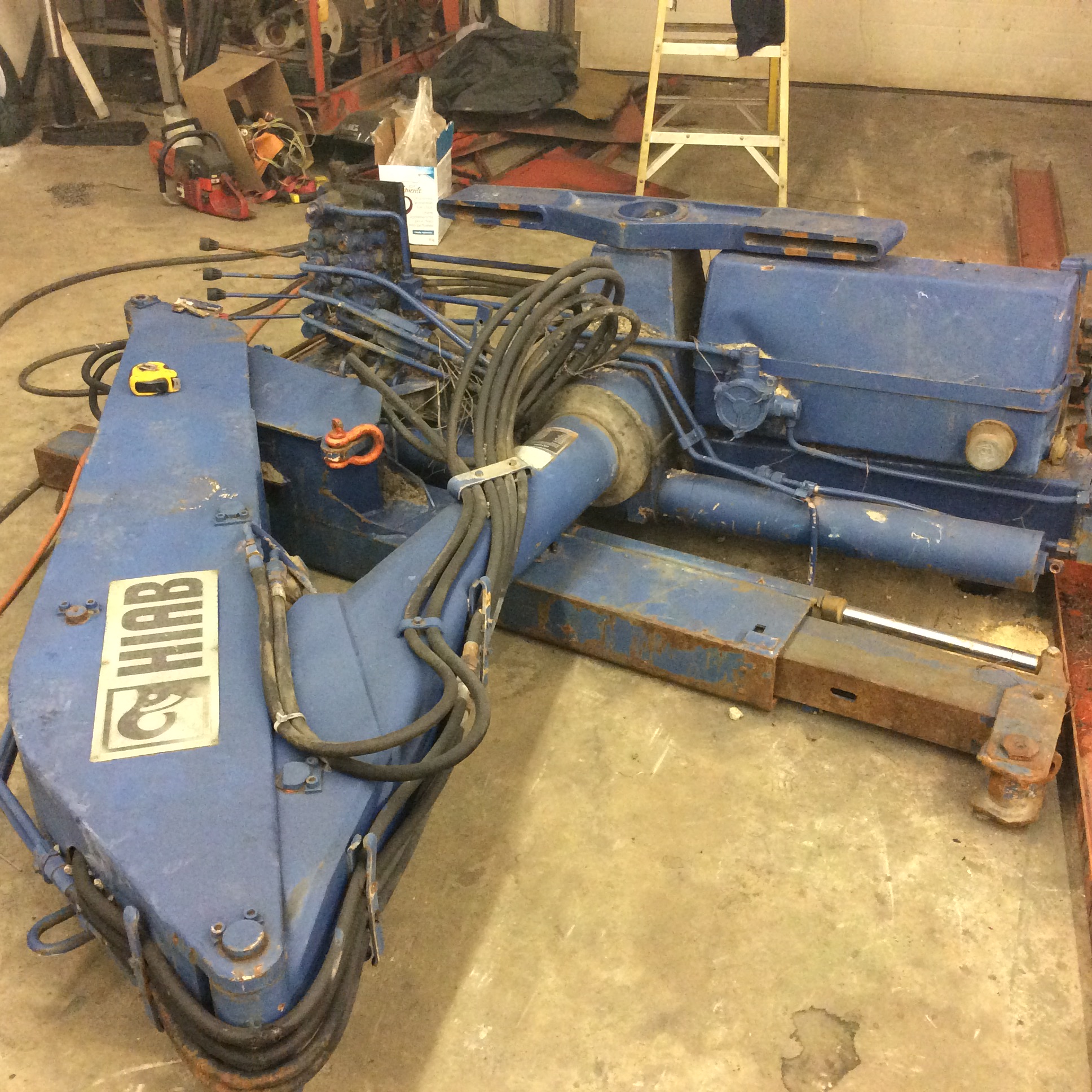

Oh ya look what followed me home on Friday. Hiab

Yes Wild Bill at some point I am going to put a hi bob (log loader) on the machine. I brought the hiab home to strip and use the hoses and any other parts I can, but it's in such good condition I'm having trouble bringing myself to destroy it.
I may have to come up with another project or sell it

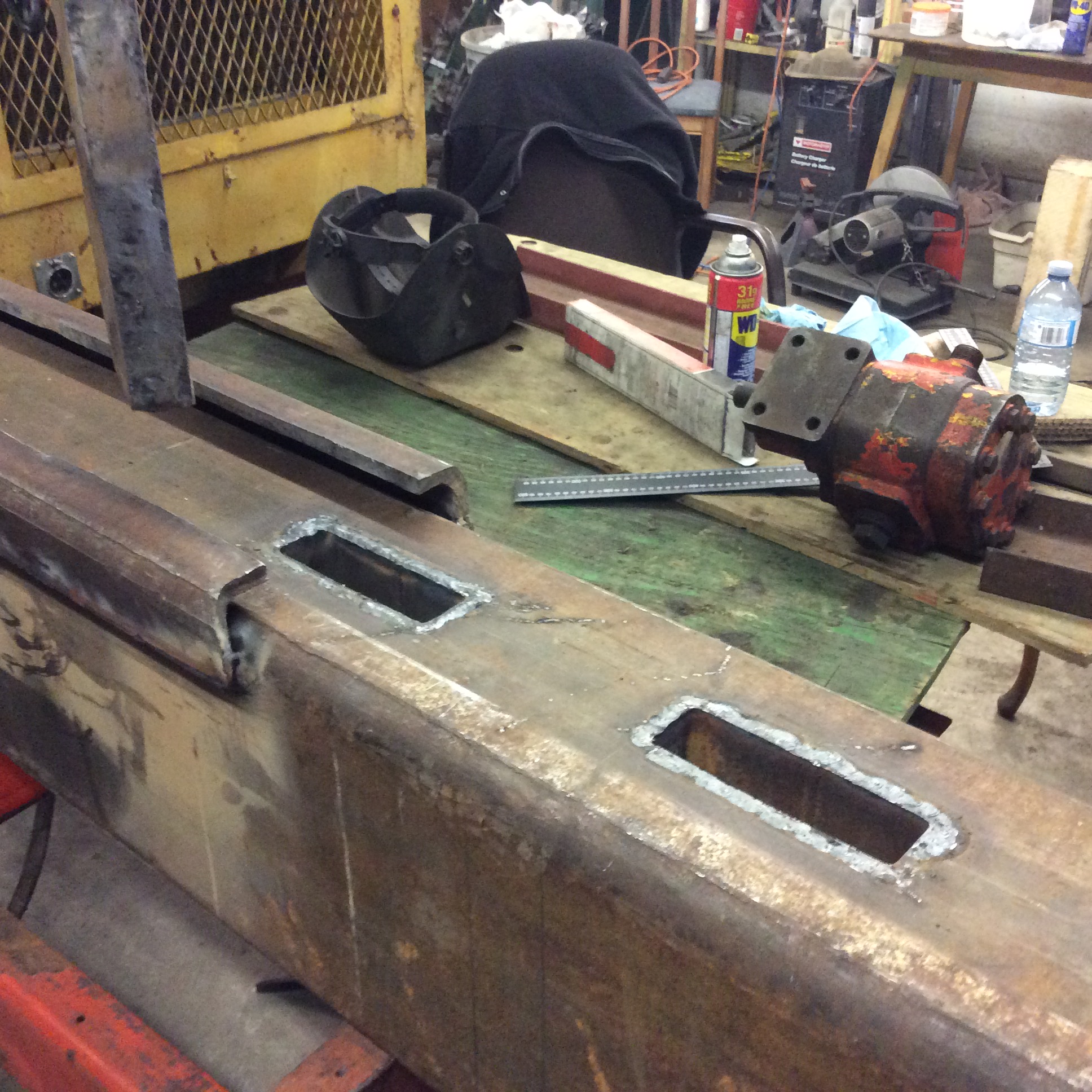

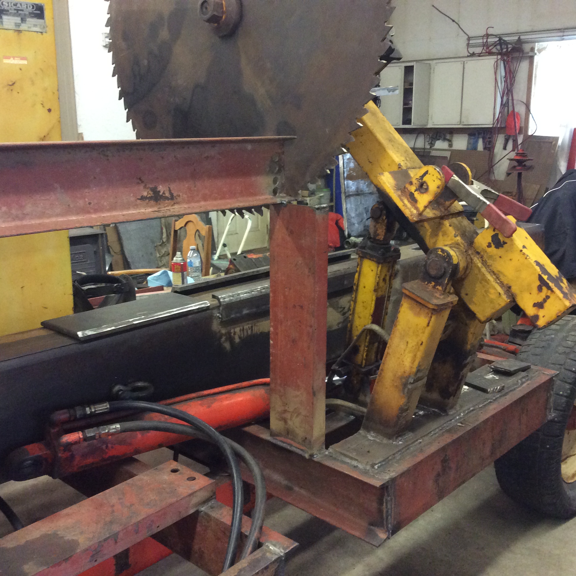

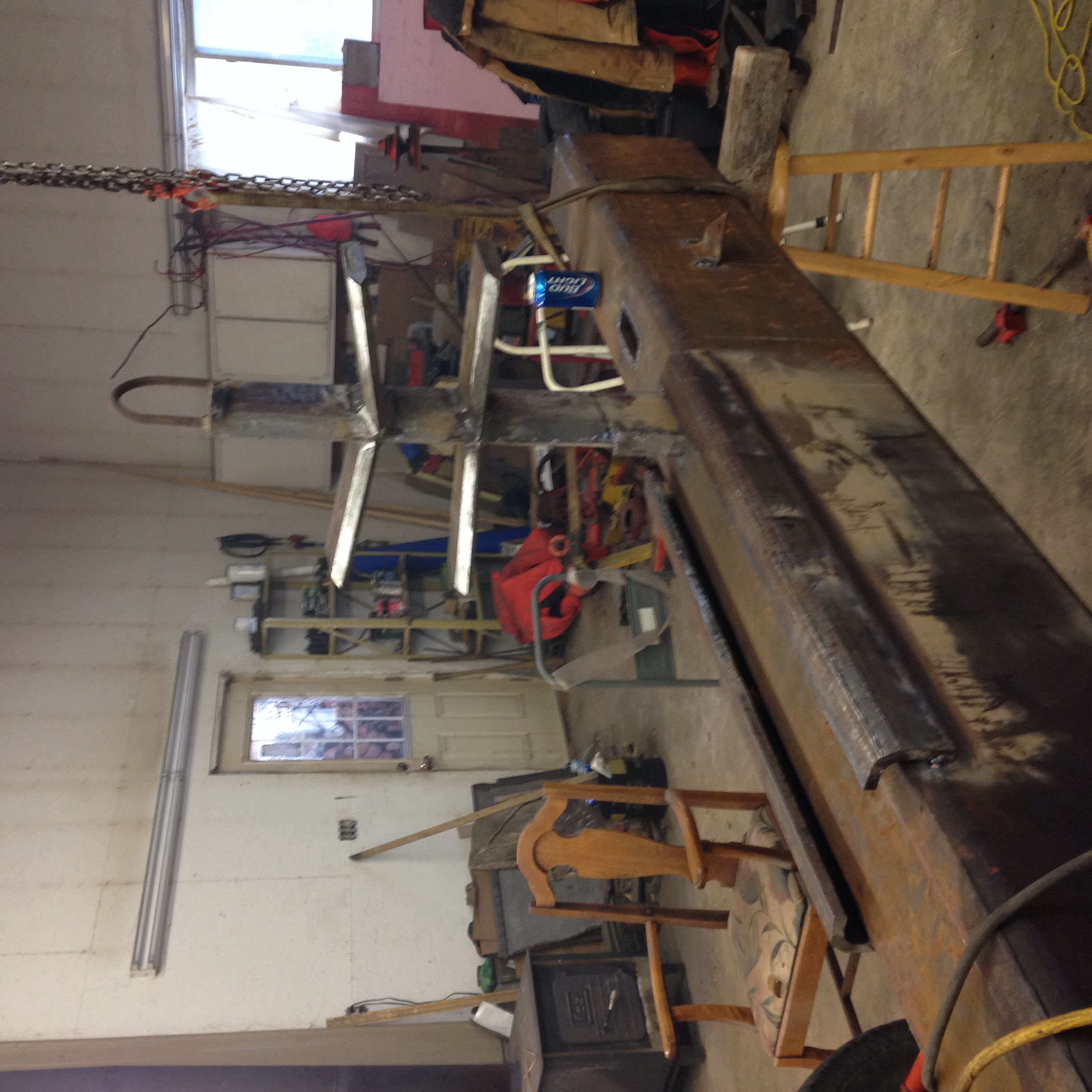

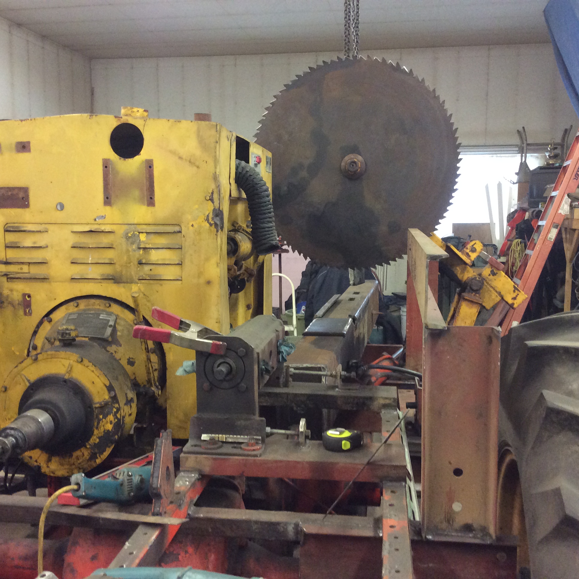

This is what I've done in the last couple days, put inserts in for the splitter wedge, I put two of them in so I can move wedge in future if needed, welded on the hold downs for the splitter slide, mounted saw arm and cylinder and put blade on just to take some measurements
For some reason I can't upload pictures tonite. I'll try again later
Lea
   / My home made firewood processor
#58
Here are the pics I promised
   / My home made firewood processor #59
Blade of death! :laughing:
Enjoying your thread. :thumbsup:
#60
Ya I'll have to build a guard for that blade or the safety police will come take it away on me
