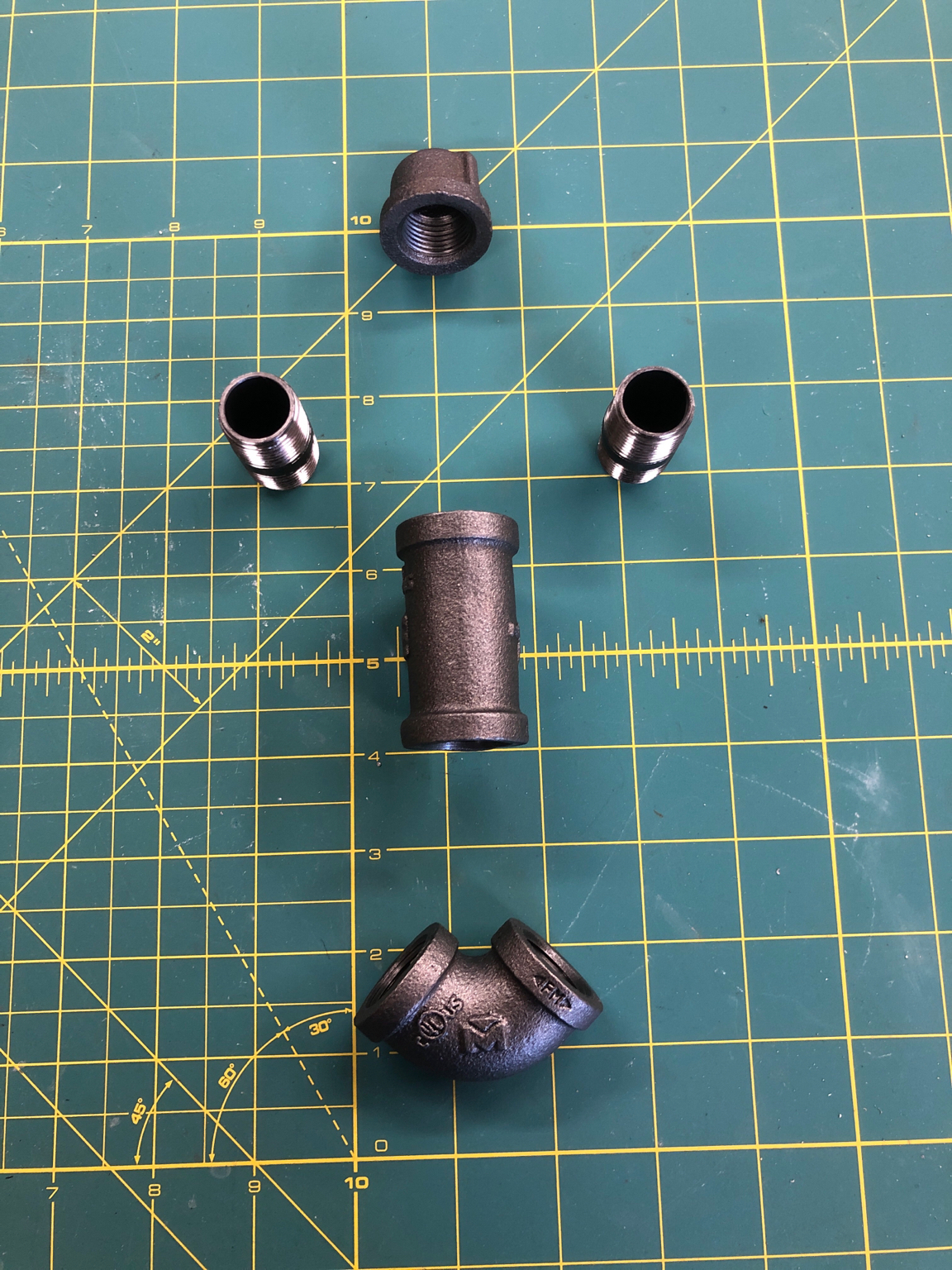

She’s not as shapely as I hoped.
Hate to tell you this; but normally LP you use galv pipe not black like Nat Gas. Propane contains moisture and other corroding elements. Copper tube instead of aluminum as used on Nat gas also. When years ago I was a service tech we carried both in the truck. Don't overlook the drip legs at all low spots and connection drops to the control valve. Big box stores and hardware stores usually do know that stuff. I thing your yellow appliance connector is code for both. Your supplier will know when he goes to hook it up. I will also research this later as now I want know if things have changed. I am on Nat gas so don't even think about it.
Ron
Thanks for chiming in, Ron. Yeah I got a mixture. My fittings are galvanized. Pipe is black. Same as the house original installation in 1985. Do have drips and sloped my horizontal run back to the control valve. Figuring I am good for this install.

We use black iron pipe for both lp and nat gas here in idaho. Don’t use galv pipe for any gas work
Mark, I did some research on my diatribe. Goes to show you what was gospel in the 40s-60s has now evolved. Today all underground is one of the plastic materials not metal more by use than code. The NFPA code basically calls for black iron or one of the manufactured systems. Ignore everything I said, I am still in the dark ages. My later pipefitting trade was all heavy commercial and industrial and interior gas work was done by the plumbers.
Yep, here too. Locals say the galvanizing will flake off and cause problems.
