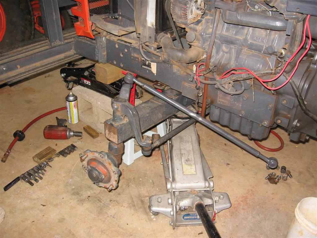

Top speed of 11mph and she was smooth as silk! :D I got it back together this weekend. About 30 minutes for the reinstall. Hardest part was working the air bubble from behind the seals. I was lazy and didn't pull the plug and bolt on the front and back. I looked closer than I had before and there is some where on the pin, It'll probably go an year or 2 before it needs to be checked (it's been 8 years this time).
I'm taking it to the dealer to get the front end aligned this weekend just to be sure. :D Also going to get the wheels balanced.
It was a lot easier with the second jack to lift and hold it.
Rob
